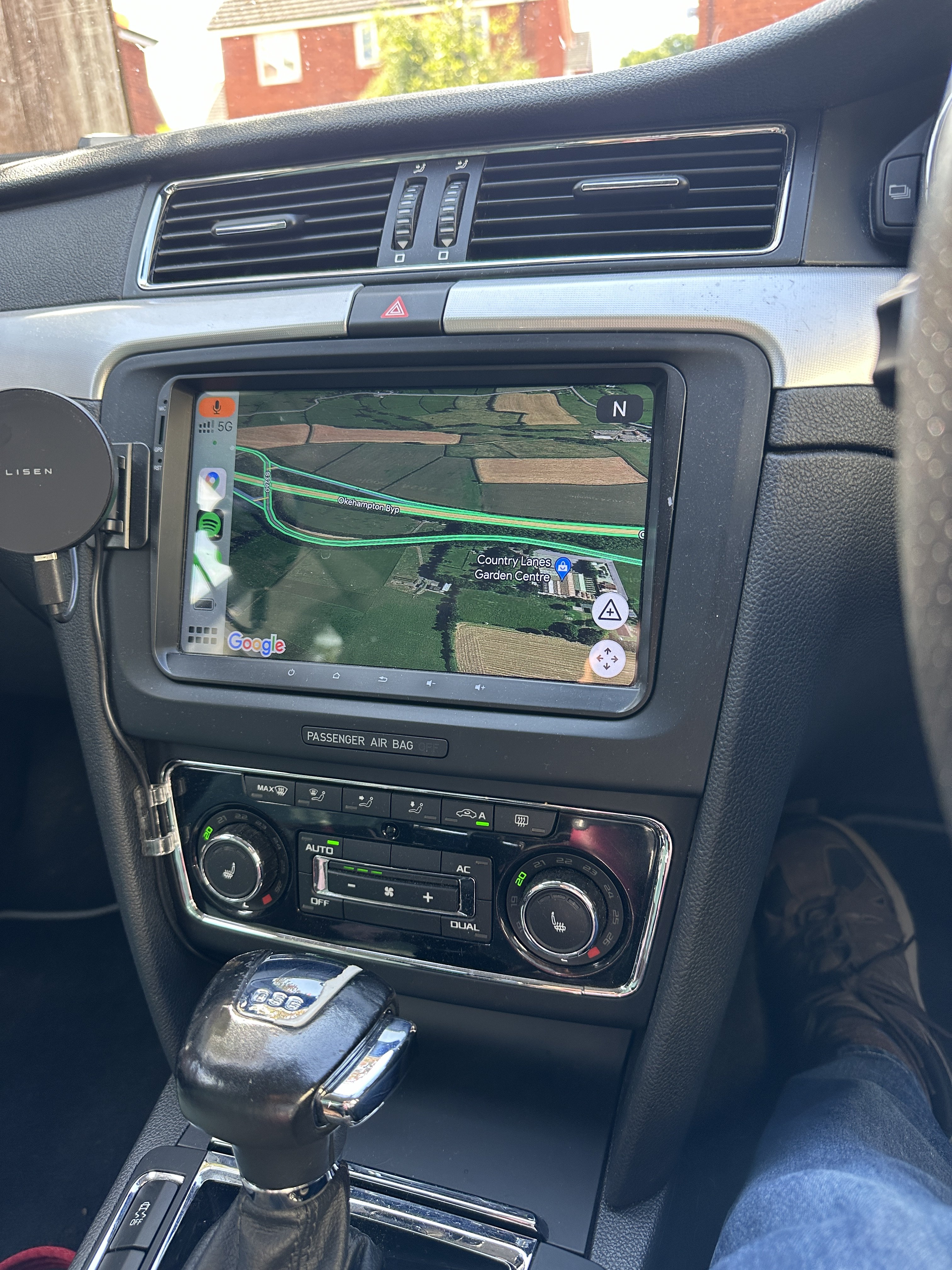

  9. Yours is about 6 months newer than mine, the engine codes also denote a build period CFFB - CFGB - CFHB and so on mines a 170 diesel i do mainly long distance school runs, nhs transport and airport transfers. My school run is about 150 miles per day and of that about 15 miles is A road the rest is dual carriageway/motorway so by the time it's warmed up I'm just getting up to cruising speed. the head unit is an xtrons unit. It's not bad, I've had to do some searching about to get it set up the way I wanted but it's reliable and has CarPlay and looks factory fitted, all the steering wheel controls work on it as well. yes you can add cameras, however no one does a handle with a built in camera for the 2012 cars, they do one for the later cars but it won't fit the earlier, I've also got a front camera to go on as well, a job for the summer, the steering wheel is now fitted but the paddles aren't working currently, I'm still trying to figure if it need an adaptation to the body control module in order to tell it that they are there, once I know I will update you i know what you mean about the DSG not being smooth at times, my other car is a 5 series BMW with the 8 speed ZF box in it and that is as smooth as silk but a proper automatic when your springs on the dual mass were failing did it make a chattering noise whilst running?
