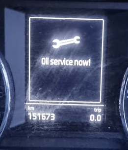

I have never owned a car that was in KM before. The rule of thumb for me before was service every year / 12,000 miles (19,000 km). I usually settled for 1 per year doing around that mileage. I bought the car last June with 132,835K. The garage put a sticker on the window to service by 29 May 2024 or at 147,000k. I did not notice this until the computer came up with an oil change message at 151,673k last month: I WFH and don't consider myself to do much mileage but I am currently at 153,196k! I have not done the oil change yet. What is the recommendation for the oil change/service frequency? Many thanks.

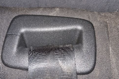

You rock @fabdavrav! I gave that info to the dealer and they found the part....they pulled up the first diagram first and like you say useless! V8V0857763B came in today and they have me a call. It cost €8.89, fits like a glove!

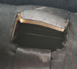

Thank you @fabdavrav that worked! I had not noticed that the top cap is missing ans so the belt and the button on it slips passed and gets jammed. Would anyone know how I can find the part number to order a new cap like the other 2 have?

The day after my 6 month mapfre 6 month warranty ran out last week, I am told the middle seat belt in the back is jammed. I have not been able to free it up, no give at all. It was working when I bought the car and we used it during the summer. Before I start looking for a 2nd hand one just wondering if anyone had had the issue and if there are steps to free it up? Or is there any chance the likes of that has a long manufacturer warranty? Thanks!

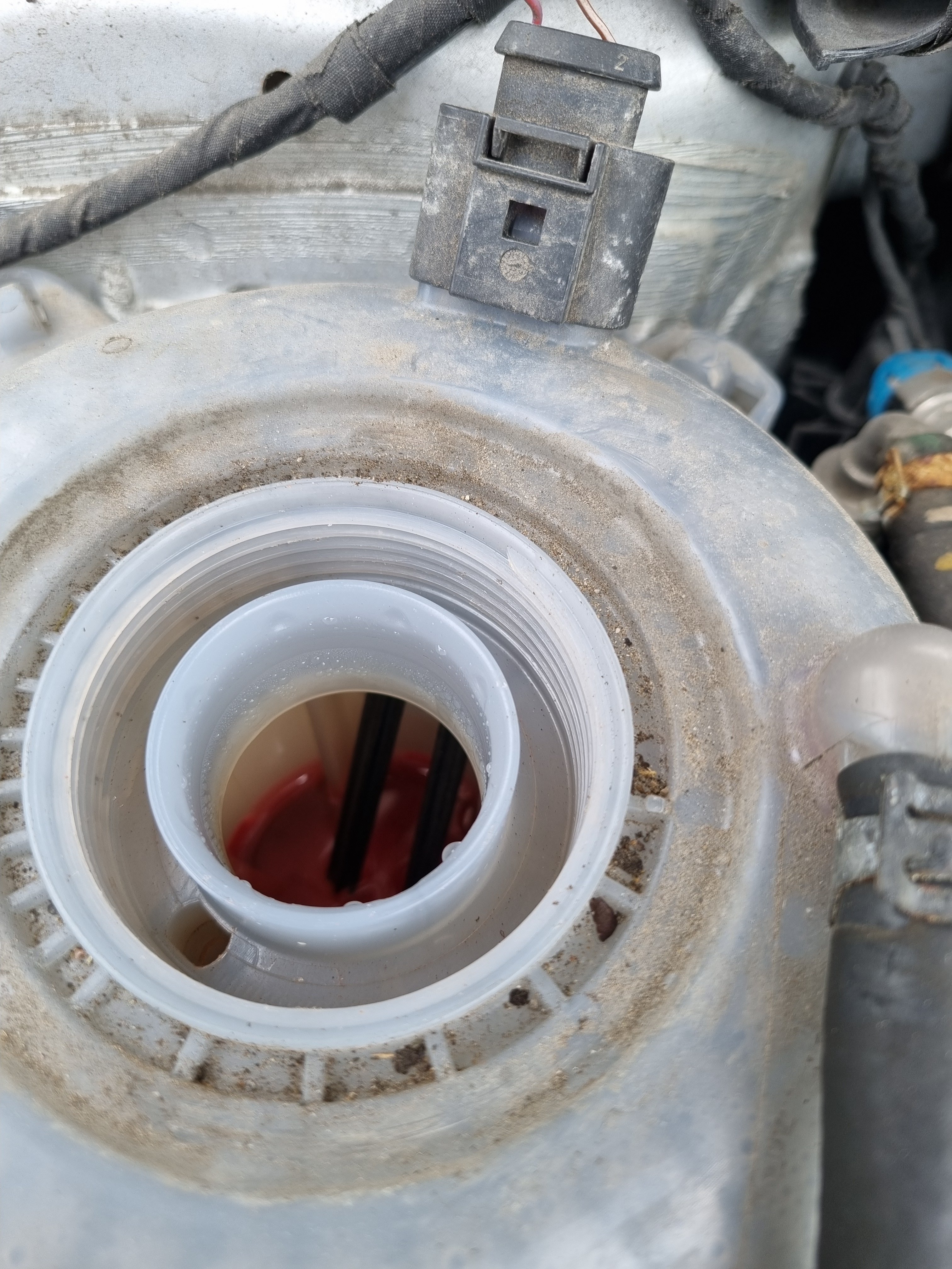

Many thanks all for your support, very reassuring. Just got 1L of pre mix at VW dealer just before they closed and topped up to halfway between Min and Mac lÃne. Phew. Friday evening, can relax now and drive stress free. Thanks again all.

I bought the car with 130k. Thanks @langers2k. This is what my coolant looks like now, engine not running since this morning. I talked to the dealer I bought from (2 hours away) and he said when they replaced the timing belt in June, they did the coolant. He said if it was low it could be topped up with water now to the mark. I can't see a mark when I open it, where is it?

The red coolant warning has come on my Octavia which I've had for 3 months after an initial dealer full service. I've never been aware of coolant in my previous passats. Looking at my pdf manual I read that the coolant cools the engine and consists of water and coolant additive. Is it normal for the light to come on so close to a full service? Does one top up oneself or is it a garage thing? Probably unrelated: I have not found it straightforward to demist the windscreen and have found it works best when the AC is on, which seems strange. Thanks for any help!
