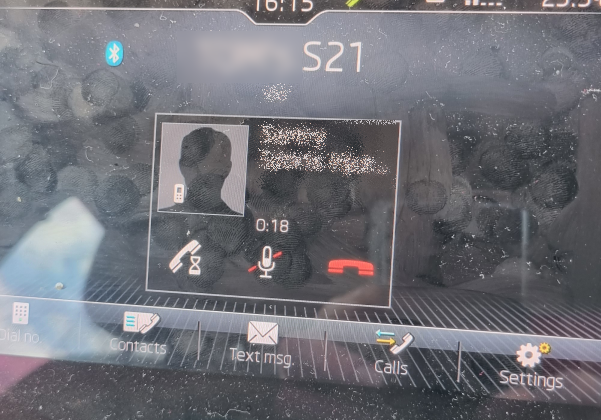

Using infotainment PO363T: Another issue I have been having with Android auto is the Keypad does not work in phone mode, so if you are required to enter a number in an automated phone system. Here's what I see when connected, when I press dial number it's to call another number and put this call on hold.What am I missing?

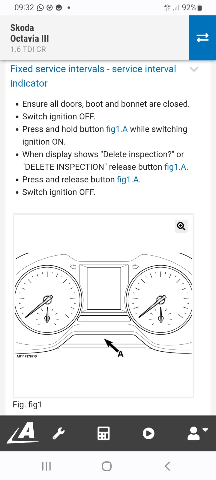

Inspection date countdown on newly serviced car?
I bought my 2017 car less than 2 month ago and a full service had been done with timing belt and all filters replaced. The last 10 days I've started getting an "inspection date" countdown on startup, it now say inspection due in 9 days. What is an inspection rather than a service? It suggests NCT/MOT. Was it just not rest by the garage or does it mean something else? I had the key in the other night without the car started and the orange oil light came on and stayed on for the 10 minutes I was in the car. Today on startup it was gone. Any idea what that means?
