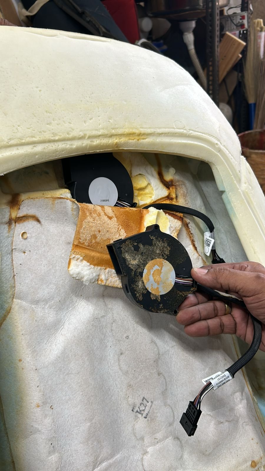

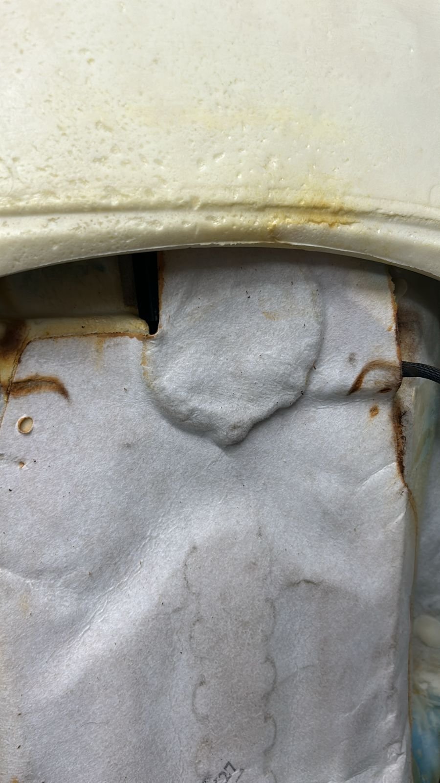

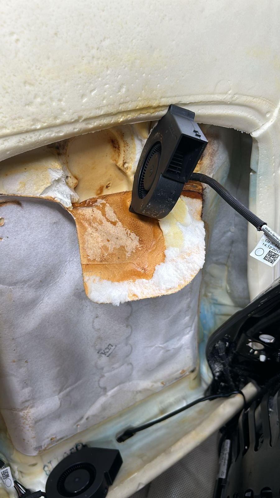

Driver ventilated seat back not working
I had got it done from an upholstery guy. So don't really know but should have been fairly straightforward.
Just changed mine last week. It's behind top left( rhd driver seat) . Under the foam. Few pictures attached. Although I feel it isn't blowing as much air as before. Cheers.
The back and the bottom motor is the same part ?
tmbbkcnp8ja300410 here you go. Thank you so much.
I got a 2018 L&K Tdi superb last year. A few days back the Driver Back stopped blowing air, the seat bottom does blow fine, took it to the stealership and it shows up on the scan as well , They now tell me the Fan alone is not available as a separate item and the whole seat needs a replacement. Any help with the part numbers ? Someone has taken it apart ? is it a serviceable thing or they are right the whole seat needs to be changed ? I am in INDIA its really really hot and the ventilated seat feels like heaven. Thanks people .
