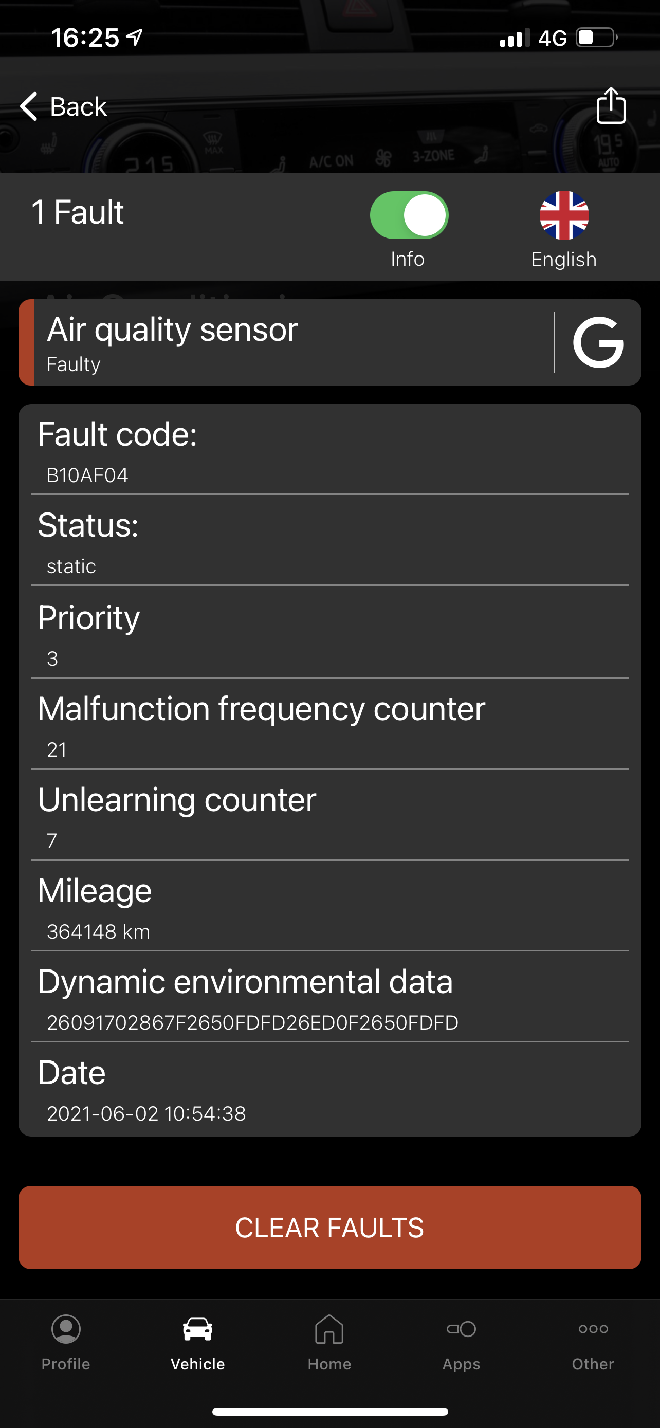

The only code for air con is this sensor and also how do I replace that
I can't imagine a sensor would be making the creaking noise.........
I know but it’s malfunctioning and I would want to replace it
Sounds like a sticky / squeaking electric damper / flap in the vent system. Or the damper / flap is scraping the duct - perhaps when it operates going from outside air to recirculated air. Spraying said WD40 or something similar into the ventilation intake might do the trick but is a bit hit & miss. If you can narrow the noise down to a more specific location then applying WD40 or similar might be more effective especially if you can get a long straw to get to the working parts. I suspect a bit of digging & investigation will be needed to expose the offending item.
