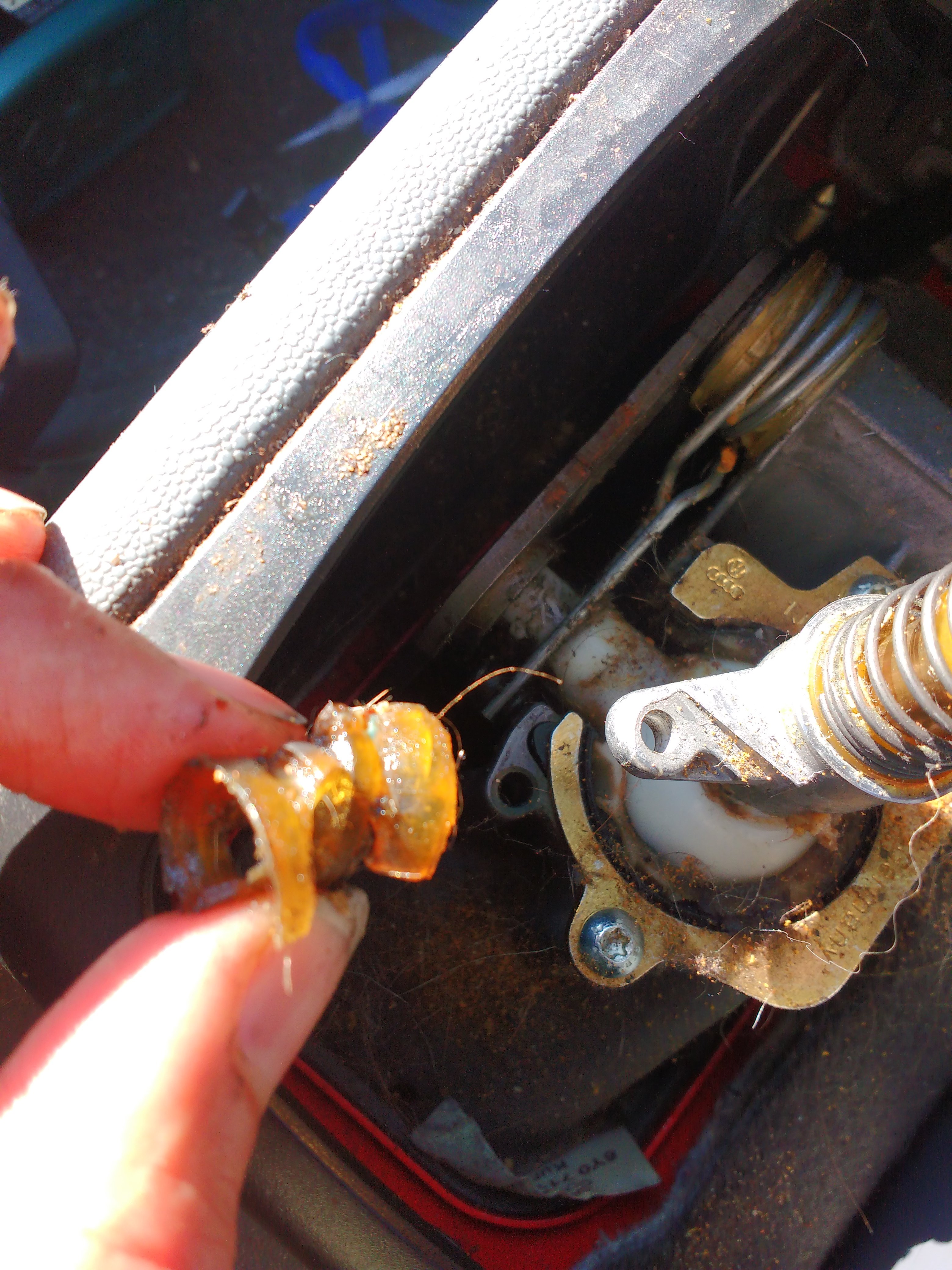

  2. As title i went back to the car after a walk, left the car in brutal sun with no ventilation and lost 1st and reverse This might have been mentioned but anyway had a quick search ,so it was the grommet thingy under the gear lever gaiter, i got there by just thinking it through anyway my solution was a product called 1st gear getter, fixed in minutes saved me putting a gear lever on as i couldn't find the grommet anywhere again please delete/ ignore if common knowledge otherwise may help someone in a search
