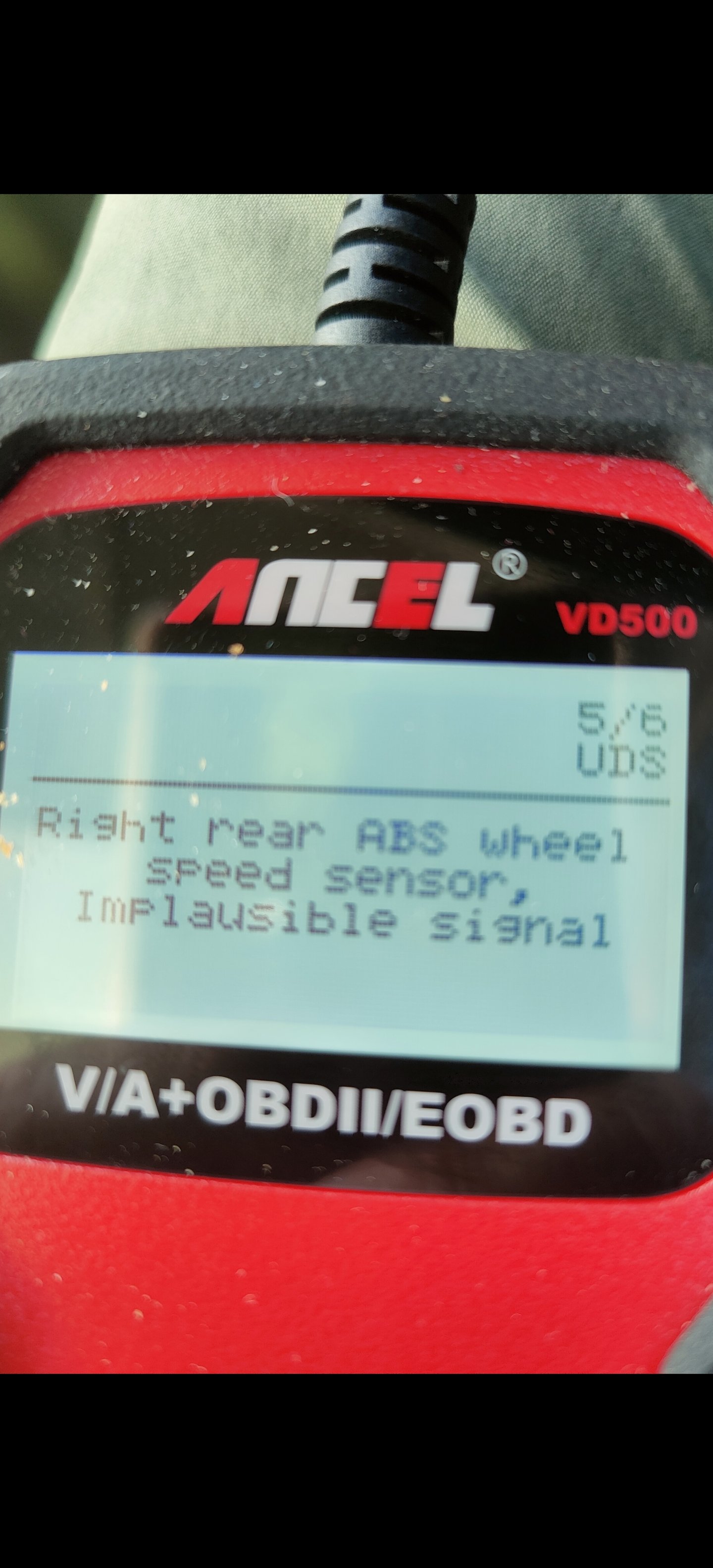

  4. I have this and it's only £38 on eBay, diagnosis of abs and clears code, this was my fault edit 32 quid with code on eBay page now

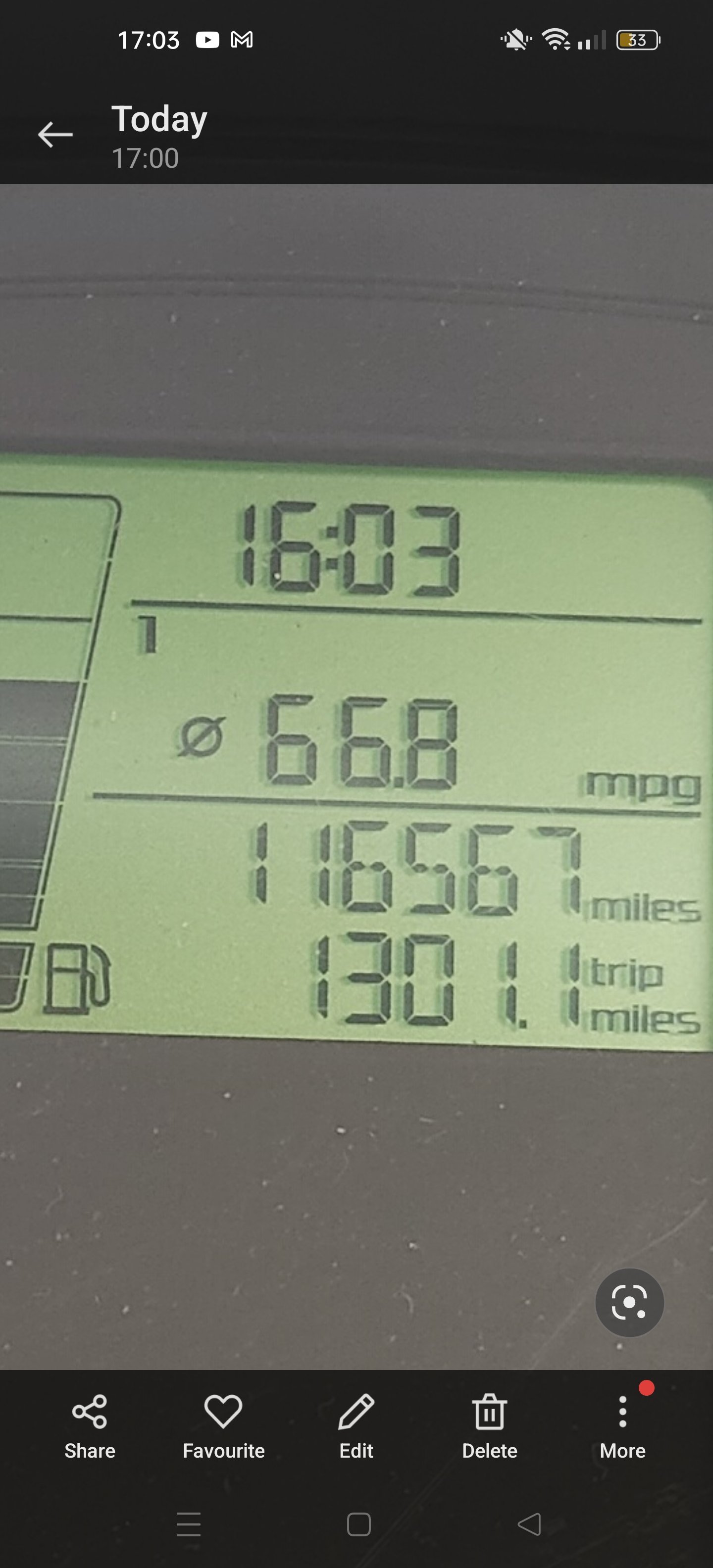

  7. I think the mpg increase will pay for the remap if everything goes well longer term, this is from a return trip to Newquay, i usually see early 50s, obviously my cars enjoying not breathing exhaust gas

  9. well it lasted a long time but then tripped out the once , got me to work and back fine a and b roads ,then suddenly it went into limp and wouldn't even tick over without the flashing glowplug light'' so my hand was forced and I've had a performance economy remap with egr delete and physical blanking, i phoned up every tuner in Cornwall but wasn't getting the answers i needed , used these guys in Devon who came down to me i will maybe edit their name in at some point, The guy explained how the links to the dpf regen are dealt with and that they have done the same to the 1.6tdi before. Anyway i will keep the thread updated on how my dpf copes, it drives amazingly and averaged 57mpg on the last mixed urban/a30 run
