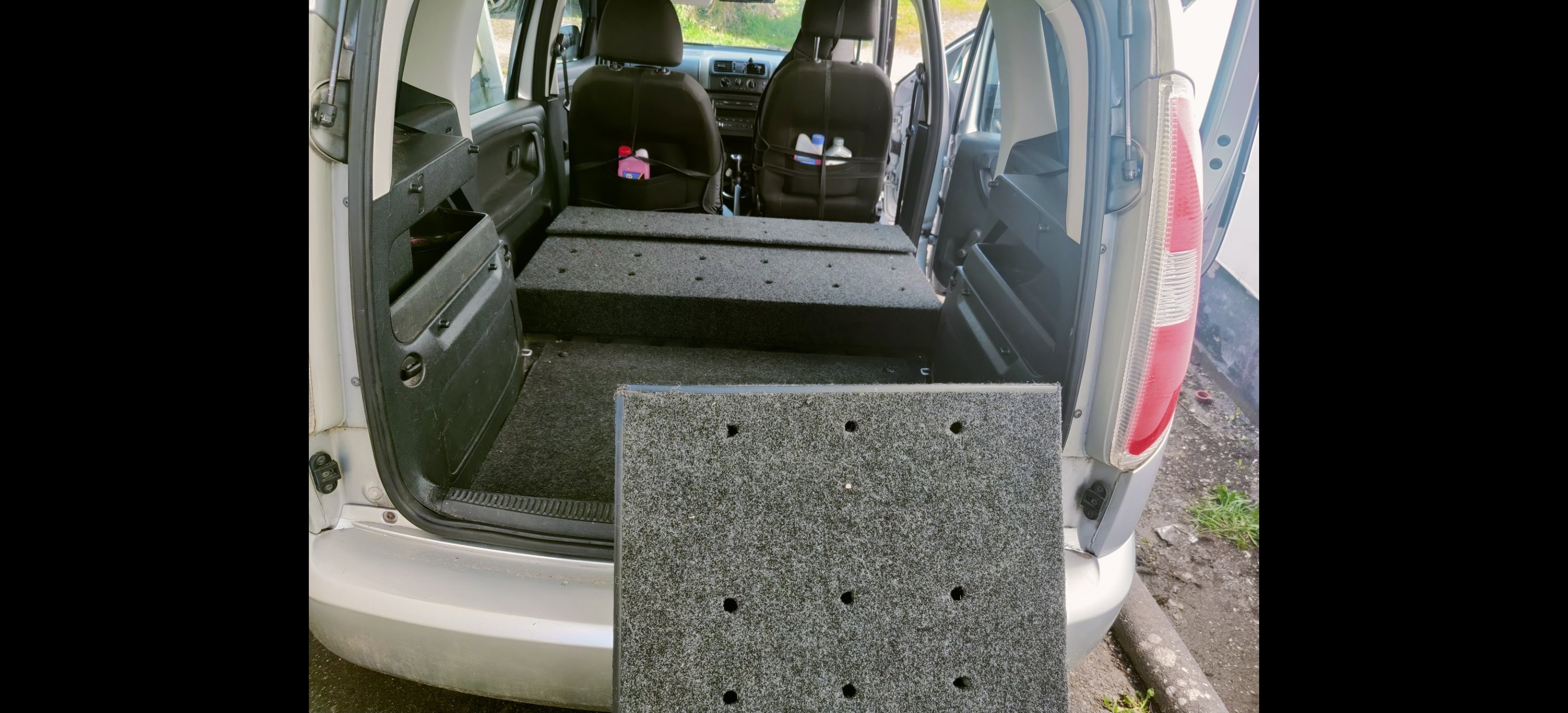

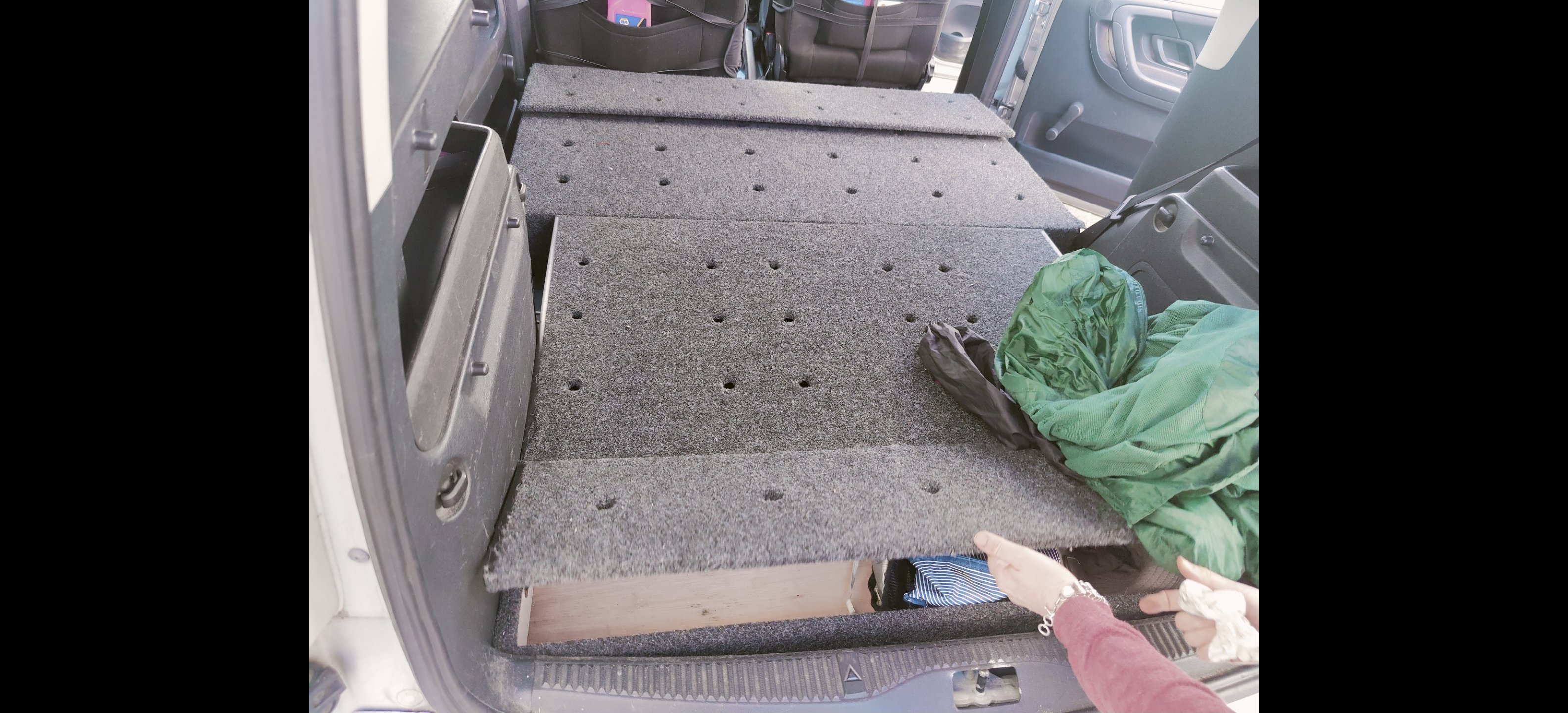

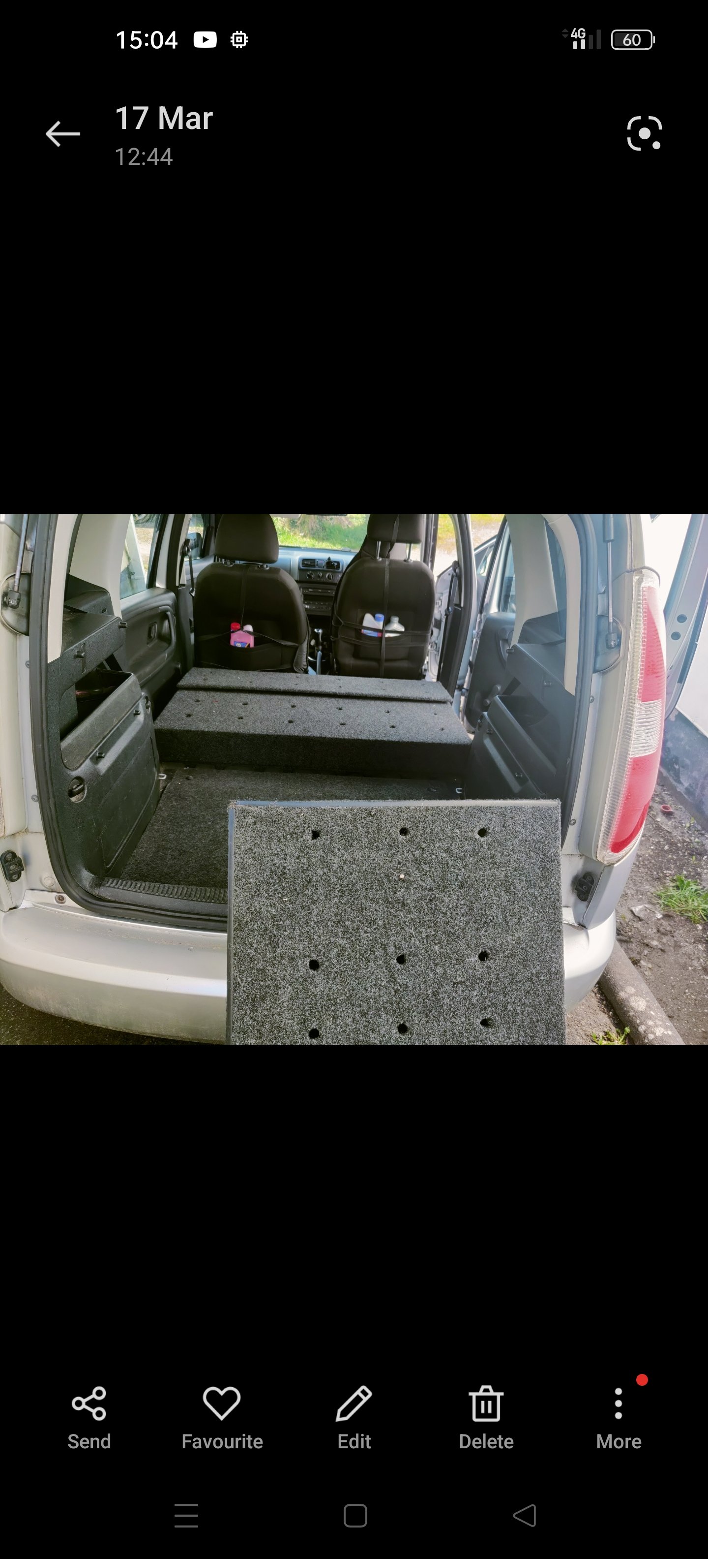

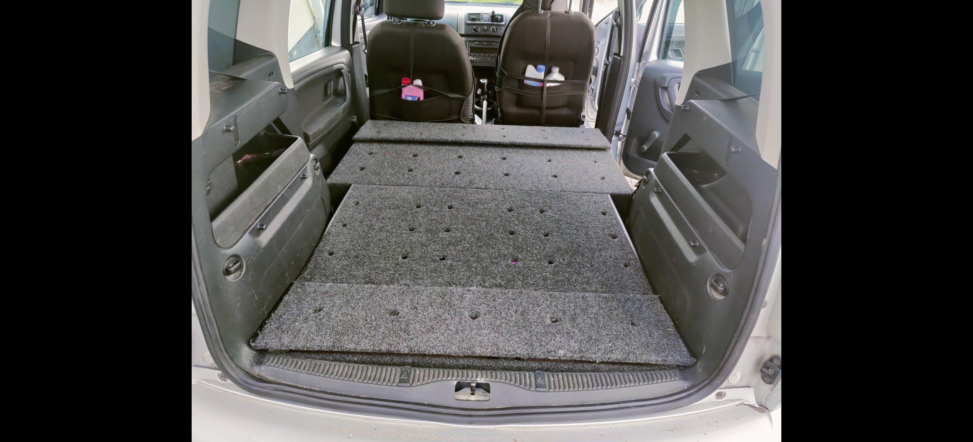

It's my ex's car but I will give mine a measure, it's all hand made by her, some more pics, the fact the seats lift out is great for me Whoops picture mistake

I wish it was possible to get my old sdi mechanicals in my Roomster !! the practicality is amazing for me, i get 2 big dumpy bags (the empty 1 tonne type) of garden waste in there, i have the use of a day camper base my ex made for hers. She is so temperamental though I've had dpf light, indicator glitches, random abs fault, random egr fault my ex has the greenline 1.2 tdi though and had no issues and stella mpg one positive thing is i am learning lots of new things about these emission devices, when i was a Ford apprentice the sierra was just arriving on the scene so the only diagnostics was the sun machine, diesels were pretty rare also .
