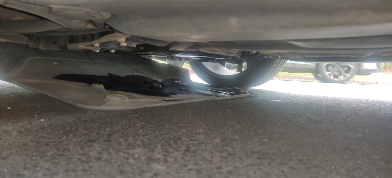

*Update on situation* Called up the service center (Spoke to the manager) this morning and they asked me drive the car to them. Car was taken immediately to the workshop on arrival and was sorted out in 30mins. They did admit the oil was overfilled and now is at the right level. They apologised for not having done the screws up properly for the under tray. The residue of oil on the under tray was left from the engine oil filter service and was not cleaned. No leaks from the differential. They have refunded the whole cost of the service. Car is back at home, all good! Thanks a lot for the advice guys!

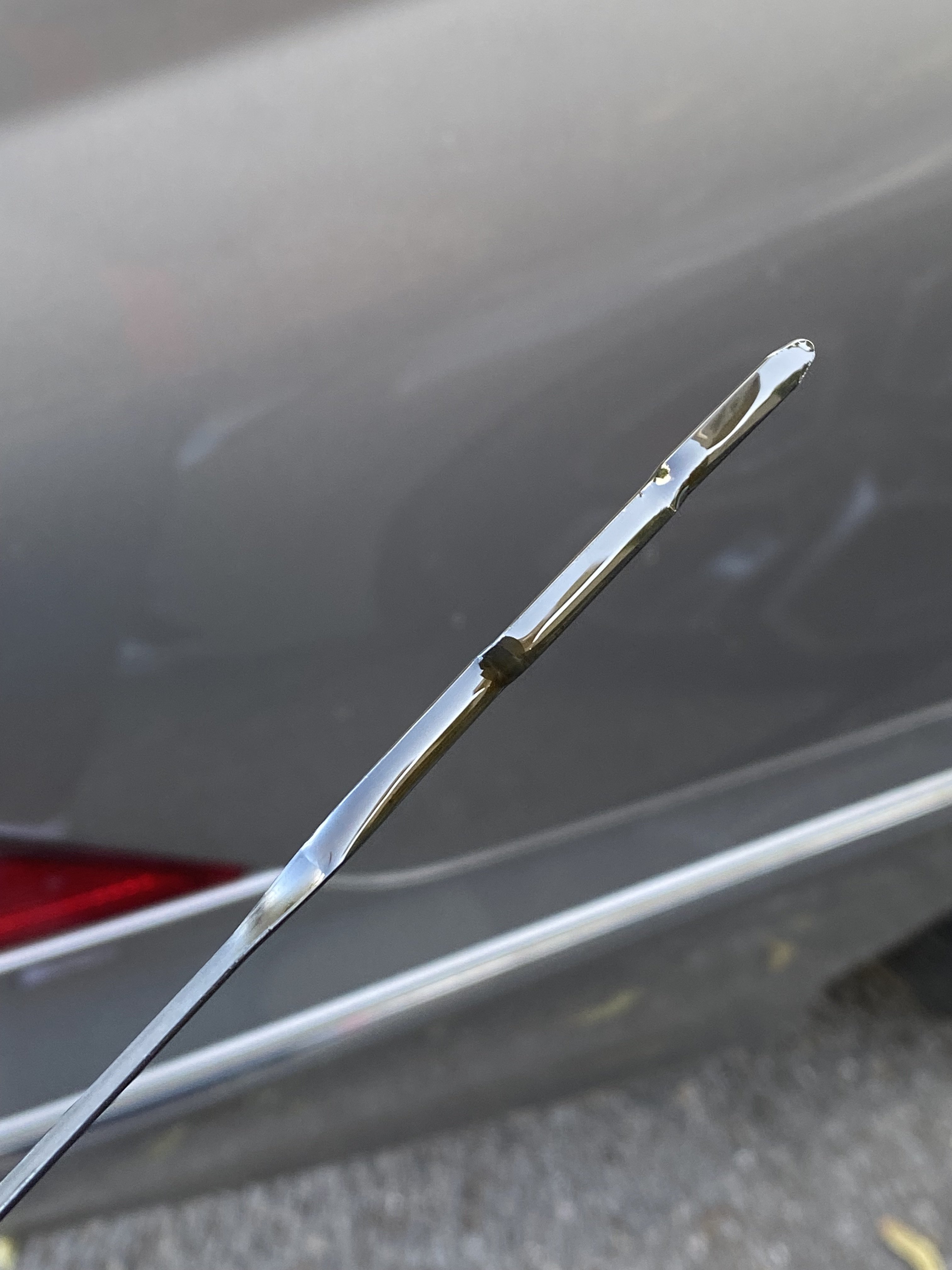

Just checked the oil level. I'm very surprised to see what I'm seeing for it being cold. Looks like it is well over the full level.

Oops apologies for that. I did check the engine oil but when it was hot. It was a 3rd more than the full level. I shall report back on the cold temperature level soon.

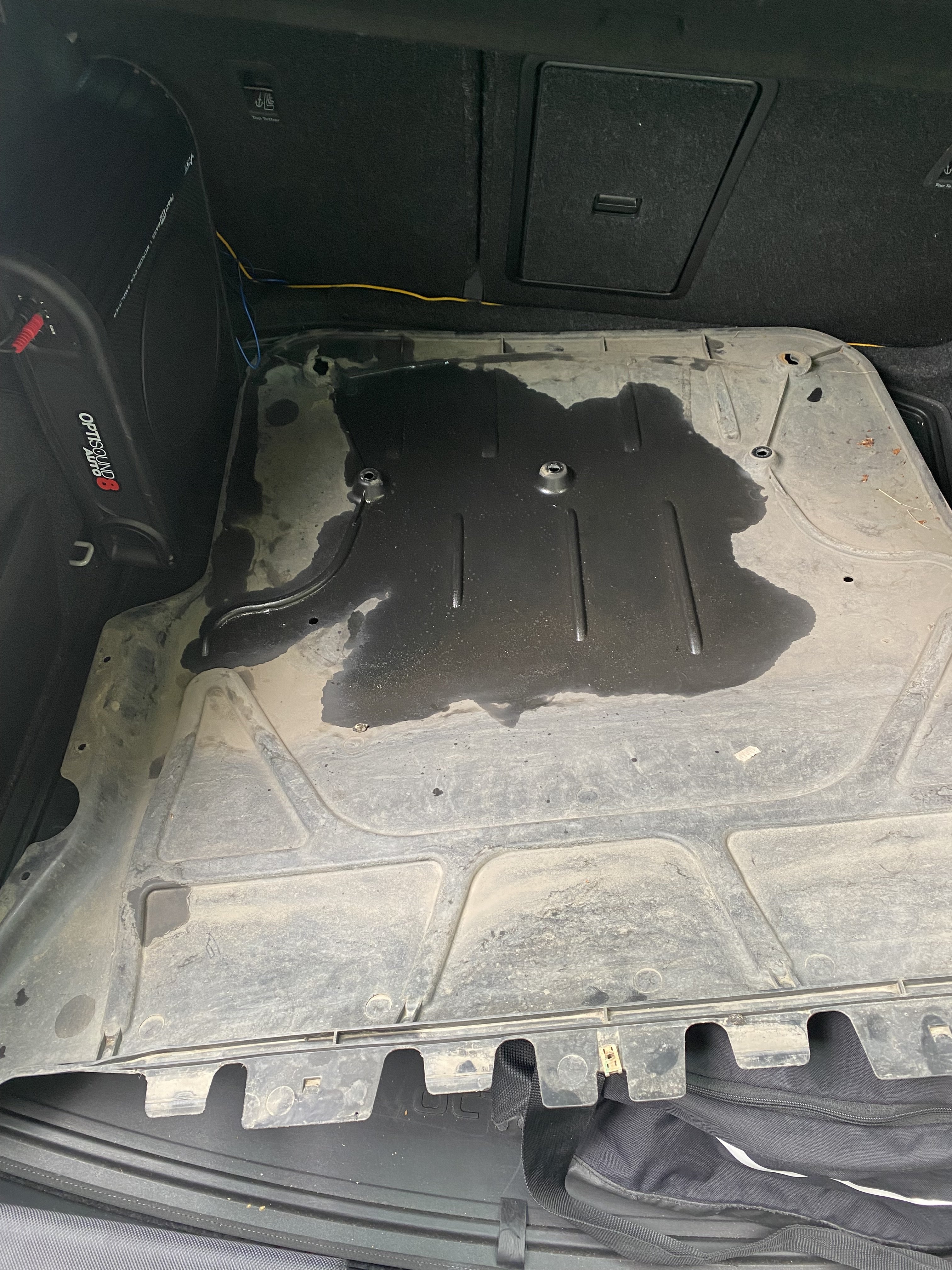

Hi All, This is my first post on this forum and hope I stick to the rules. I'm in a bit of a pickle with my 2020 octavia VRS MK4. The car was given for a differential oil and brake fluid service on the 07/07/2023 and 2 weeks ago had an oil change. Both done by the same authorised service centre. Yesterday, the 8th of July 2023, I set off for London at 11am and as I was driving the front underbody shield of the car came loose and started dragging on the road. After parking the car, I looked under the body of the car and found that the underbody shield had come loose. You can also see there is leakage of some oil which I presume is from the differential as it was serviced 2 days ago. After the AA technician arrived, he took off the undercover plate and deemed that the car was safe to drive back home or to the service centre but only managed to drive it back home as the service centre was closed. Can you guys help me with identifying what oil would be spilled on the undercover plate below? I need to make a good case to have the service centre compensate for all the inconvenience.
