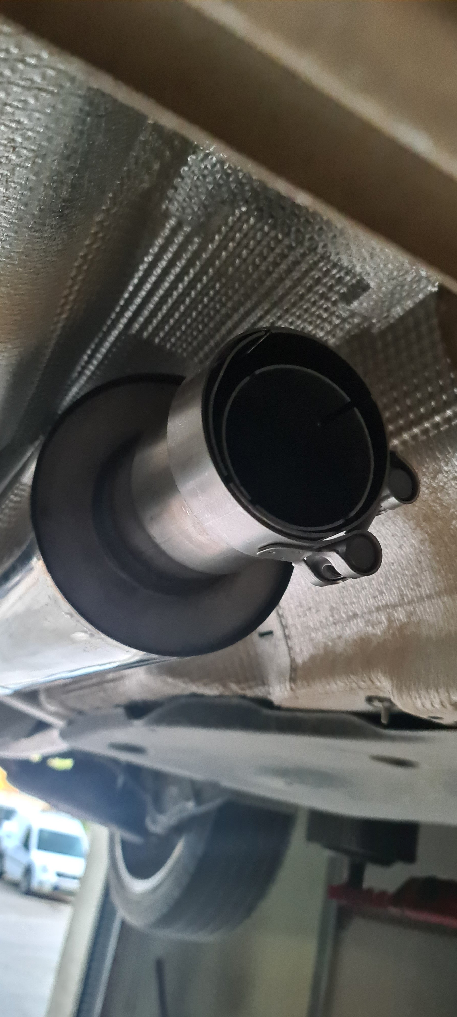

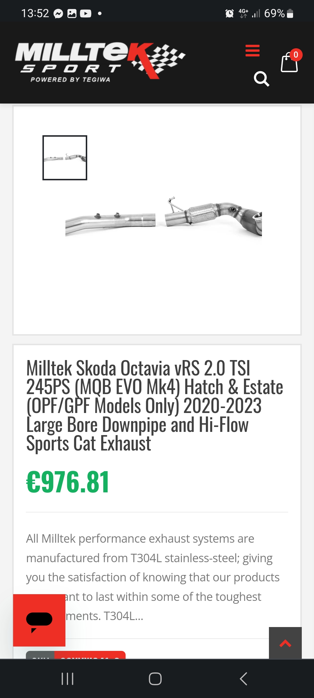

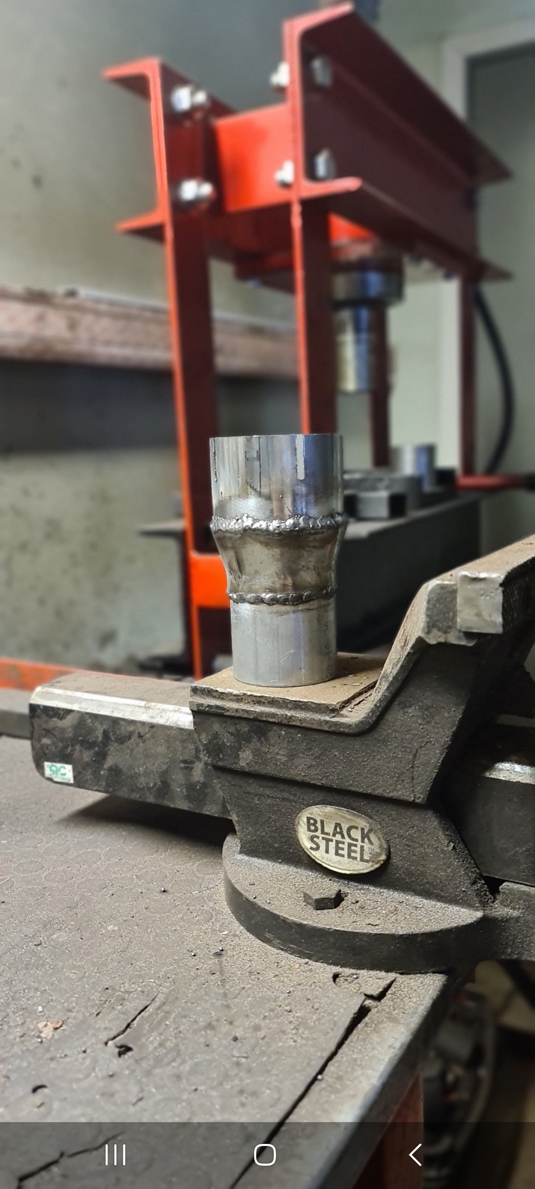

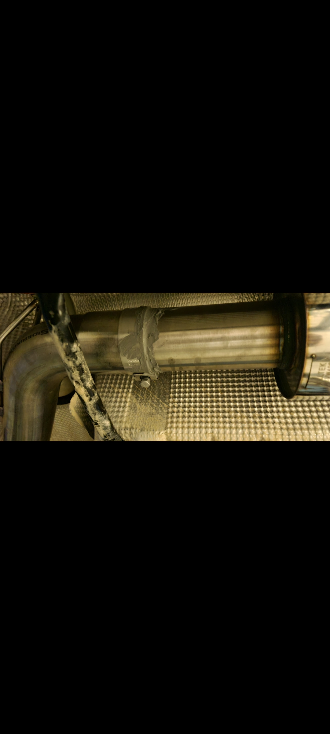

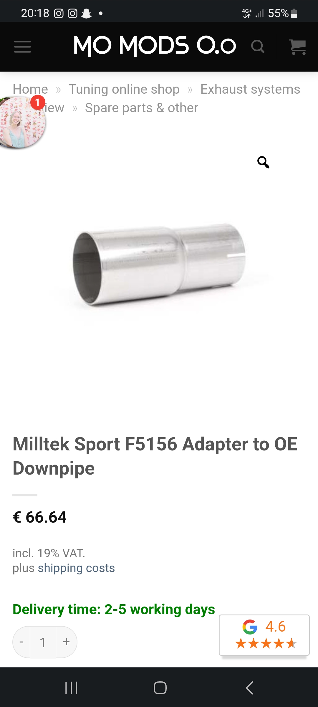

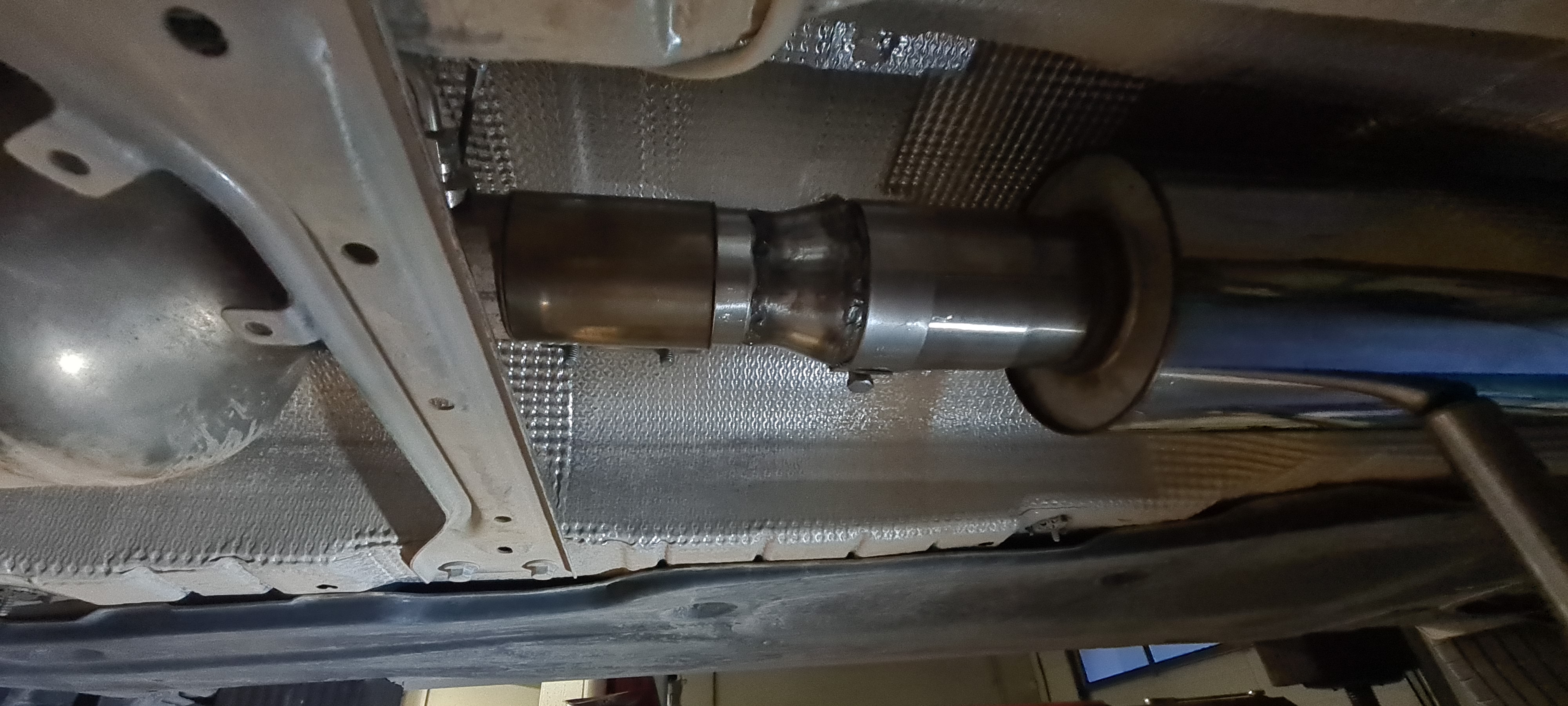

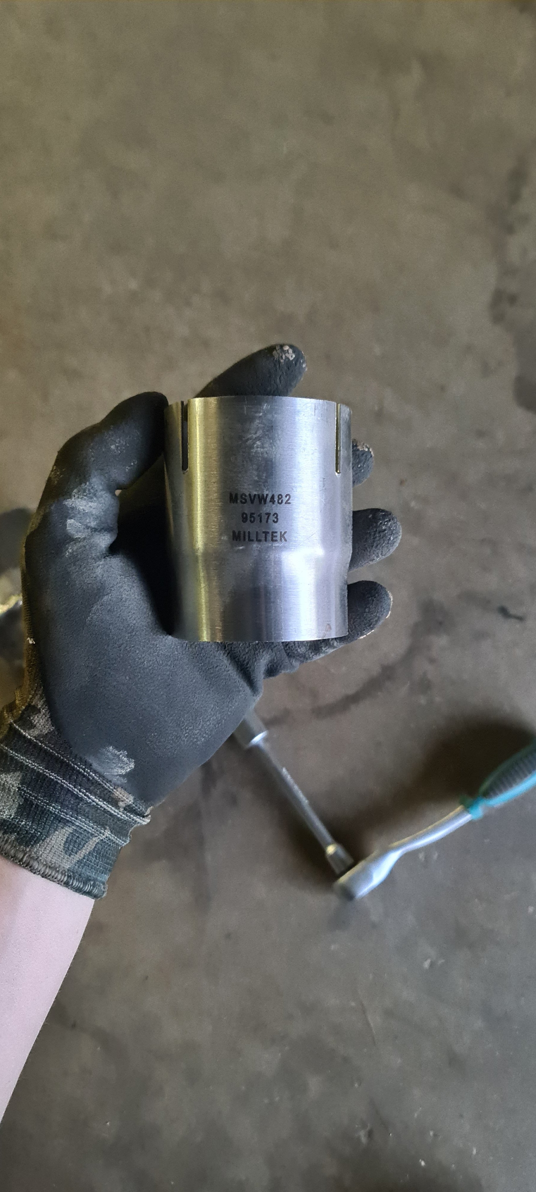

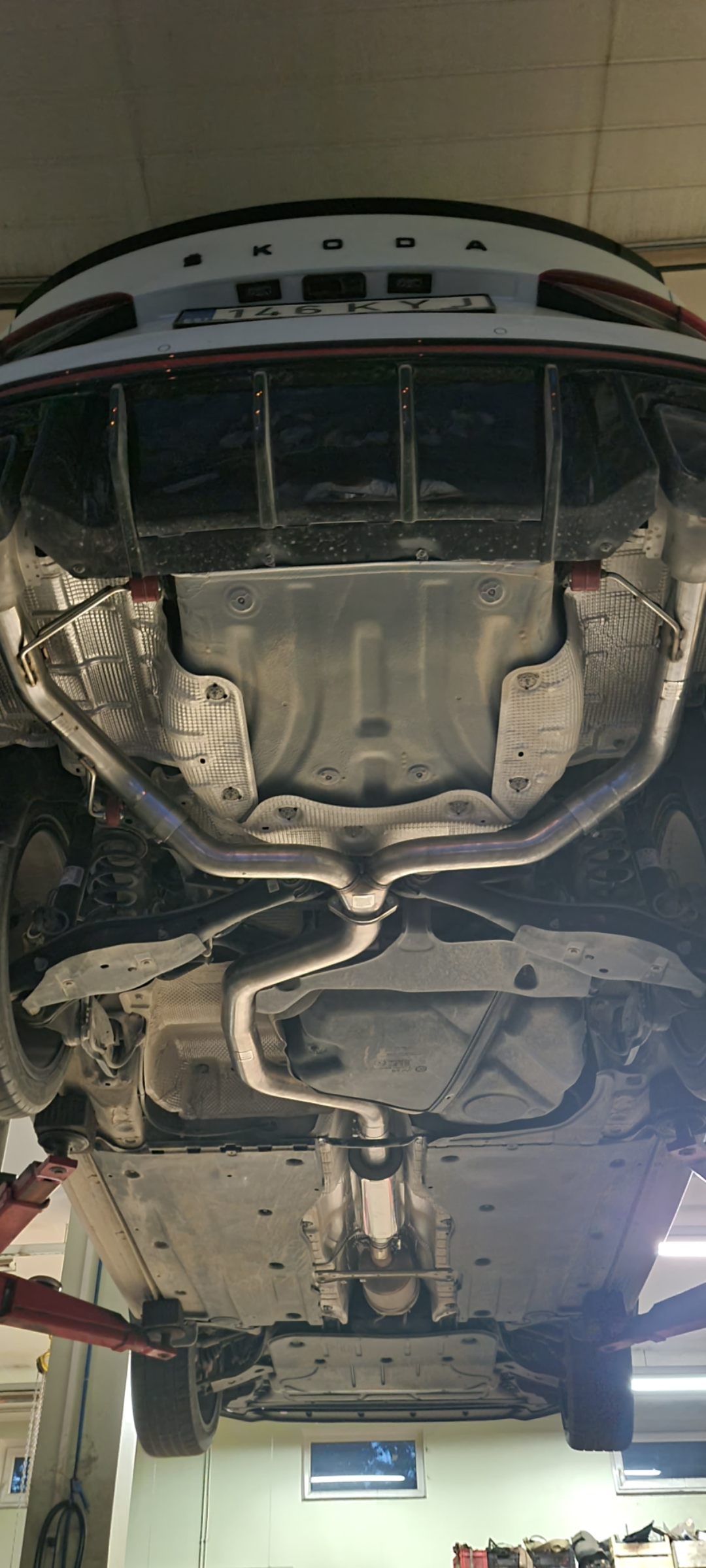

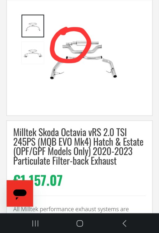

Ordered Milltek cat back non resonated exhaust. Waited about 2 months because some adapter was missing. Unfortunately after waiting they still forgot to send me that adapter to fit with oe downpipe (shown on first and second picture). Instead they sent me 2x MSVW482 which was too small to go from oe downpipe to the catback syatem (shown on 3rd and 4th picture). So had to make the adapter ourself to fit the exhaust (shown on 5th & 6th picture). And on top of that the clamps submitted by milltek were leaking after tightening bolts up so had to use sealant. But afterall managed to fit the cat back exhaust and now its making a bit more sound.
First 30 sec with original exhaust after that with milltek non resonated cat back. Unfortunately video dont show that much difference, actually it is pretty ok.

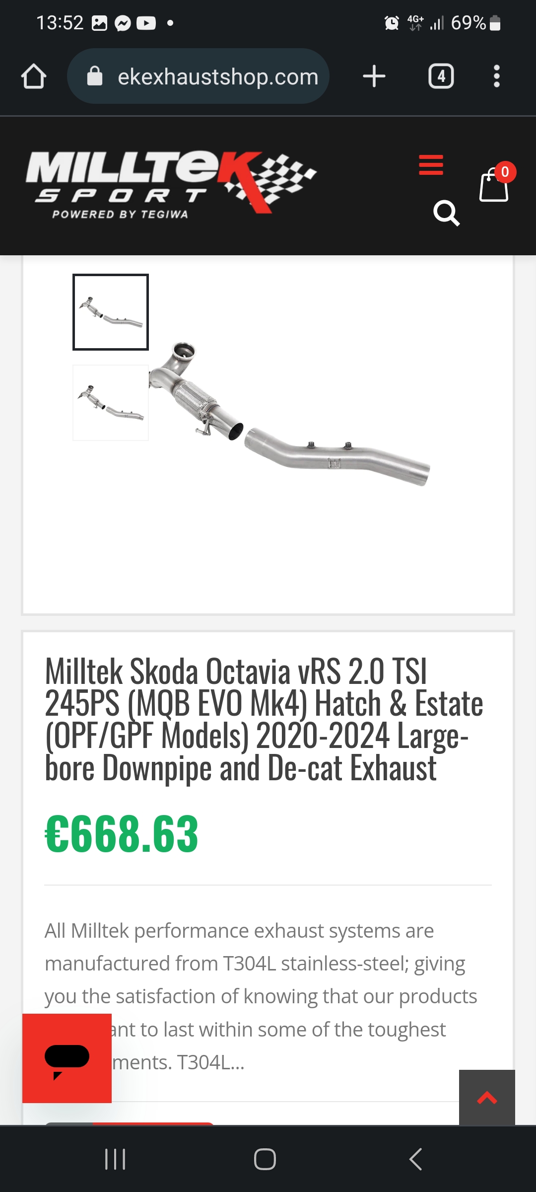

Anyone know if swapping out downpipe with decat or with sport/race cat (options shown in pictures) does the car show check engine light? Or will it work fine without tune?
Checked it with my tuner when I did the remap and yes, you will get ECU error from the O2 sensors reading pre and post catalytic converter. If you really want to install either you play with O2 sensor spacers or you get just an ECU tune for OPF off exclusively, I would say it's already on the market for the Simos 19.6.

What do you mean by play with o2 sensor spacers? Since the car is about 3 months old dont want to ecu tune cause its going to void warranty i guess.
In Estonia you will get fail also with full de cat, but the tuv check with new car is after 4 years, then after 3years and so on.
But if theres need to lower the subframe to change downpipe then it would be good idea to order downpipe with cat.
So does anyone know whats the difference between sport cat and race cat? Not very much information on this from google.

Using O2 sensor spacers is not an exact science. Mainly, on the market you have straight spacers and 90° elbow spacers, all with different lengths so you would need to check and try which one would be the one passing the check ... not triggering the engine error light.
And yes, you have to lower the subframe, at least the left side, there is not enough clearance, VAQ differential is blocking the clean way out.
