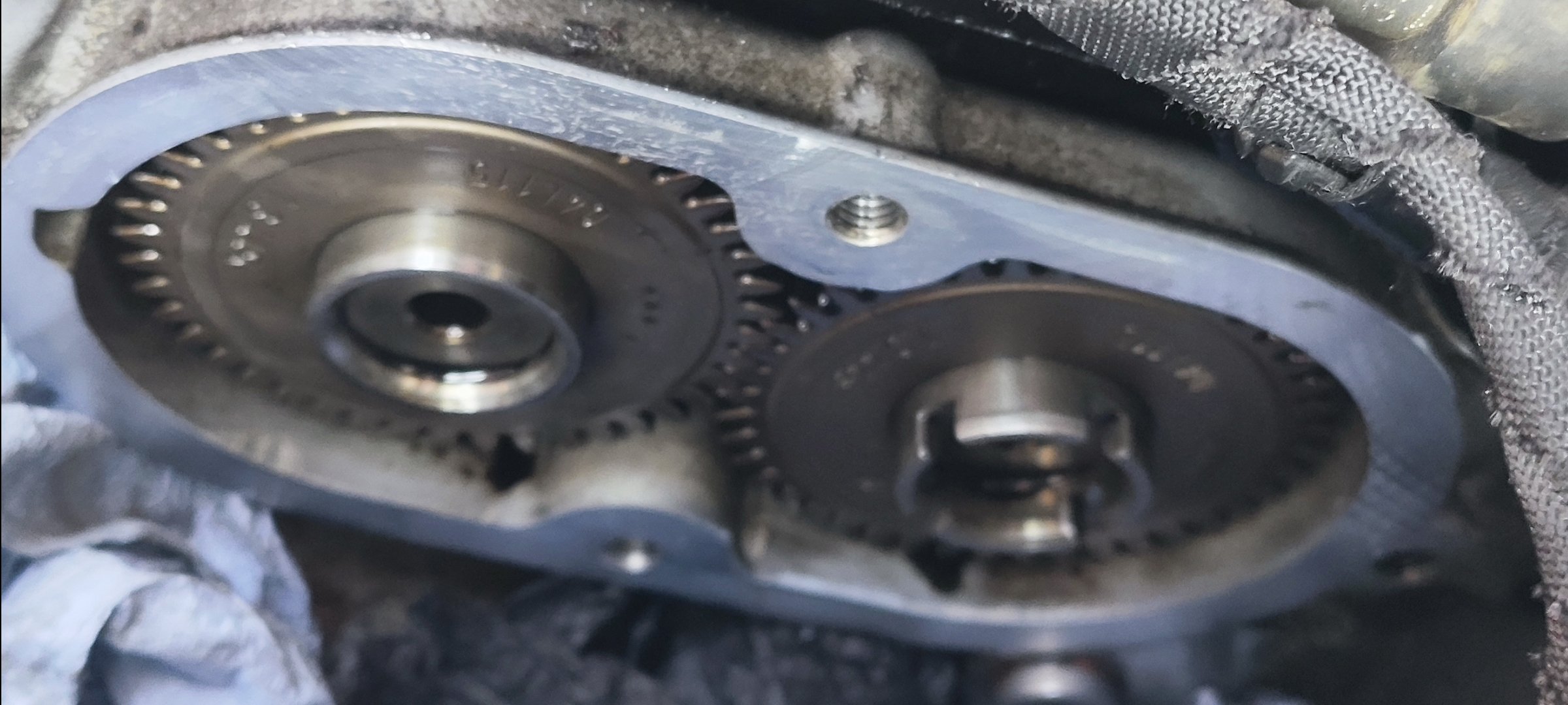

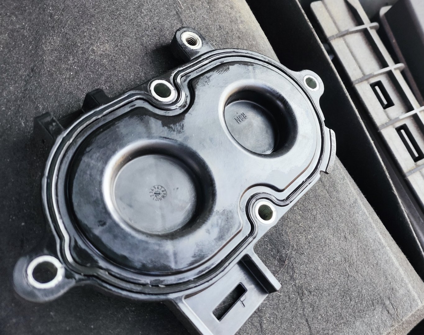

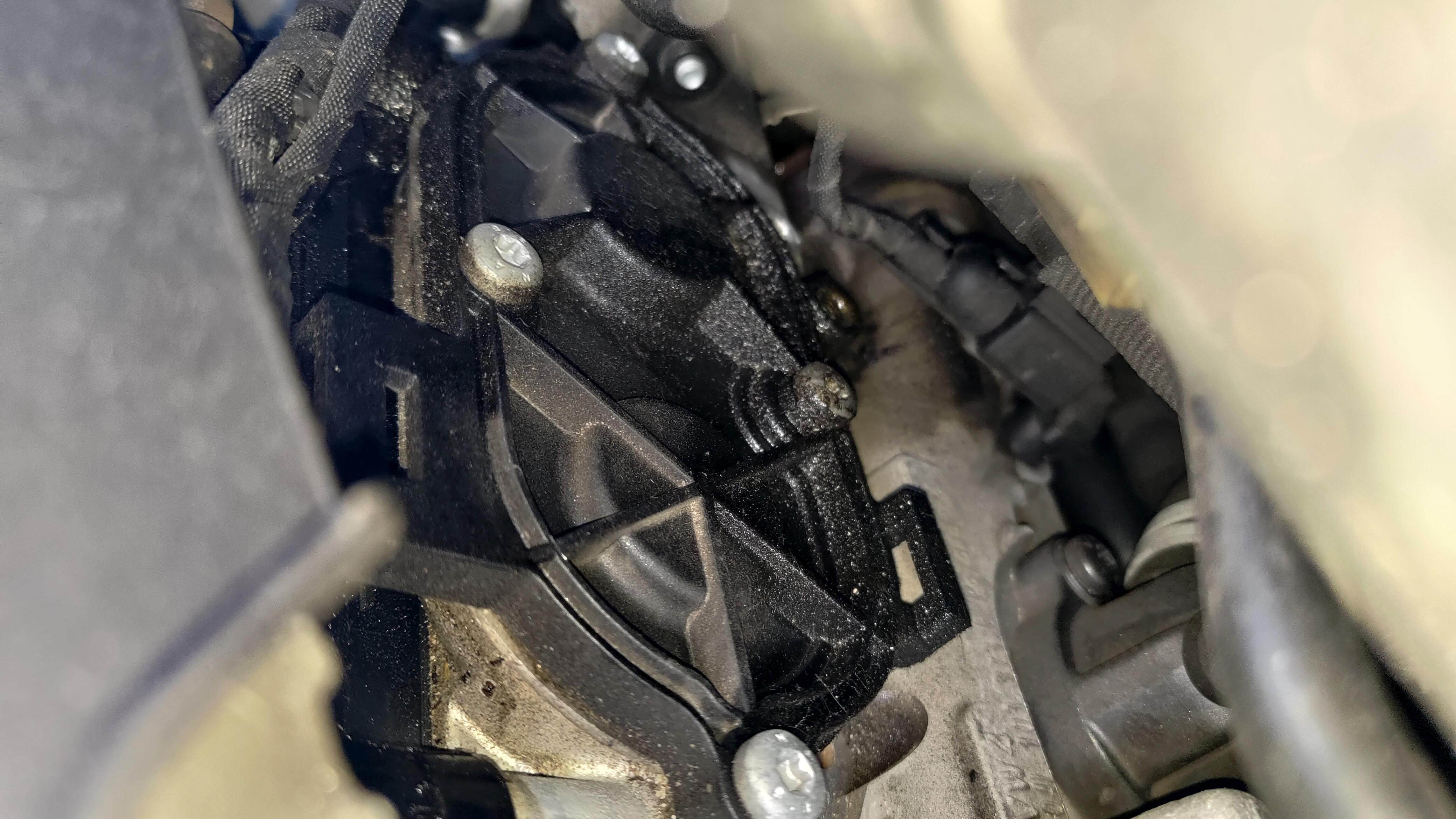

  1. Update: Remeoved the cover, peeled out the rubber saeling and washed everything clean before reassembling. Wasn't difficult at all except one screw was a little bit tricky to reach. Unfortunately I can't reach the protective plate below the engine for cleaning so I'll leave some cardboard under the car after parking and see if the dripping is going to stop. Some impressions:

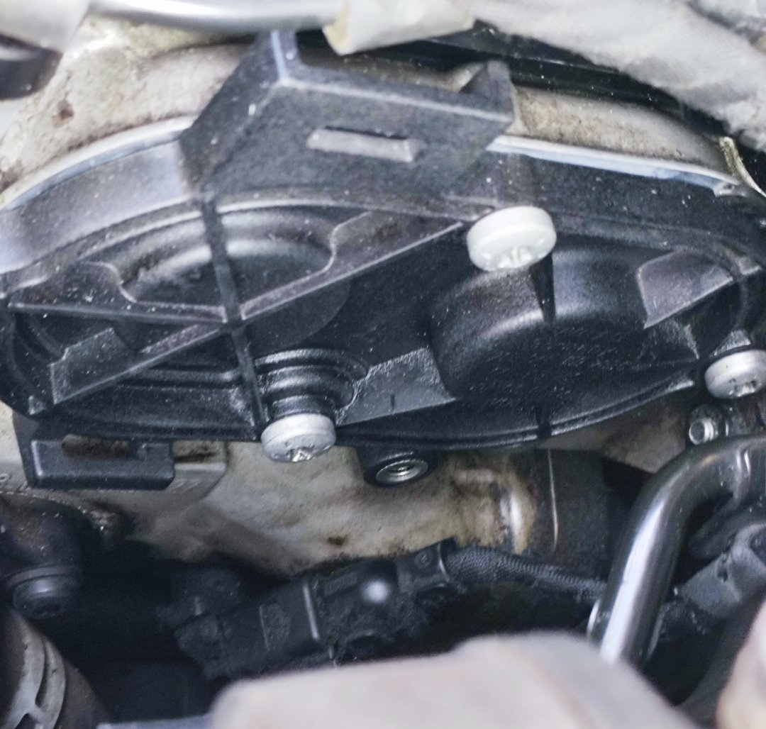

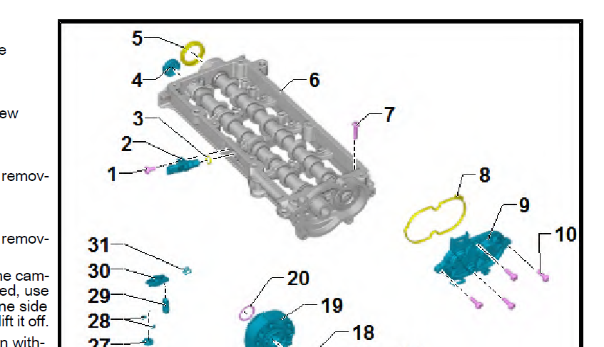

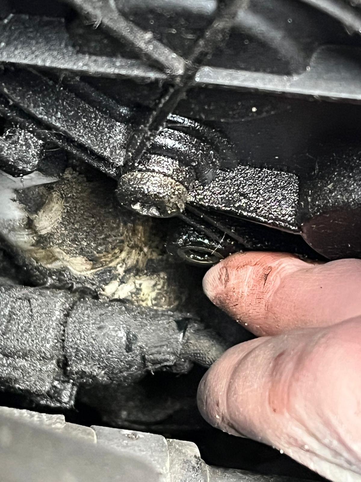

  2. Car is leaking oil drips on the floor. This cover is located on the right side of the camshaft housing and looks very messy. If I put my finger under it it's oil-wet so it's likely the culprit. There's also a sensor located below the cover that seems to have collected a lot of oil drips. First I thought theres a screw missing but I compared with another octavia mk3 and there's also just 4 screws keeping the cover in place (same according to a manual I found) and also some oily residue visible but way less compared to the leaky one. Is this a known issue? Thinking about replacing the cover + seal myself (no 8 + 9). Messy one: Other car looks like:
