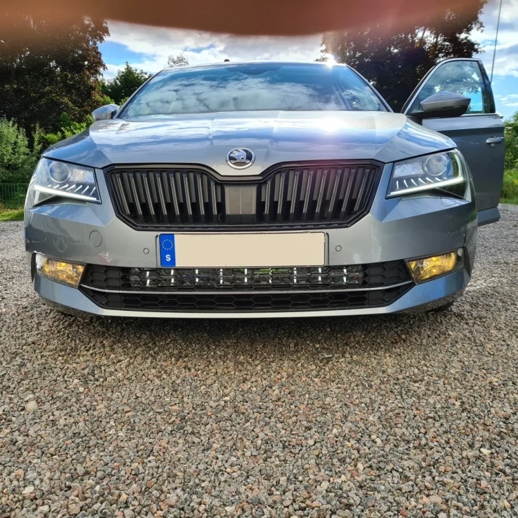

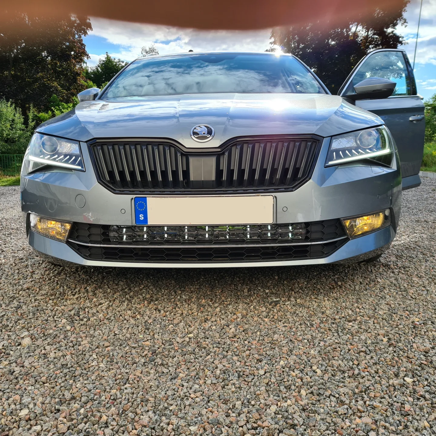

I mean the position lights as they are called on the lightbar is not legal. There is some regulation that if you have extra position lights they have to sit in a specific position both in width, height and distance between them or else it's not legal. For example it has to be 60cm between each position light which there is not on the lightbar. The cars are of course legal since they came that way from the factory 😊- What have you done to your Superb III today?
It lights up pretty good despite the location where it's mounted for sure 😊 Yes it's legal, at least here in Sweden 🙂 You can have as much lights as you want on the highbeam. I've got buddies that has 10 times the lumens that I have on highbeam 😄 The only thing that's not legal is the "drl:s" or what you may call them that i use. On my ledbar you can choose between white or orange/amber.- What have you done to your Superb III today?
Hello. It's a Optibeam Super Captain Dual 800, 766mm wide so 30" i guess. Don't know the ref but it's measured to 30900 lumens in boostmode which i use. Okey yeah i've had some kind of extra lights on all cars since many years back, can't be without it once you tried 😄 Live in middle of Sweden so not dark yet, a couple of months left until it's dark from 15:30 in the afternoon until 7 in the morning 😝 I've seen the difference between stock xenonbulbs with 4-5 years on them and when changed to Osram Nightbreaker or Philips X-tremeVision and it's quite a big difference what i've seen and heard from people who made the change. Hehe yeah if i meet someone who doesn't turn the highbeams off i can flash them a bit 🙃 Haha yeah it will do for now, had more power in the lights on my previous car so would be nice with some more 😝 Maybe next year 🙃- What have you done to your Superb III today?

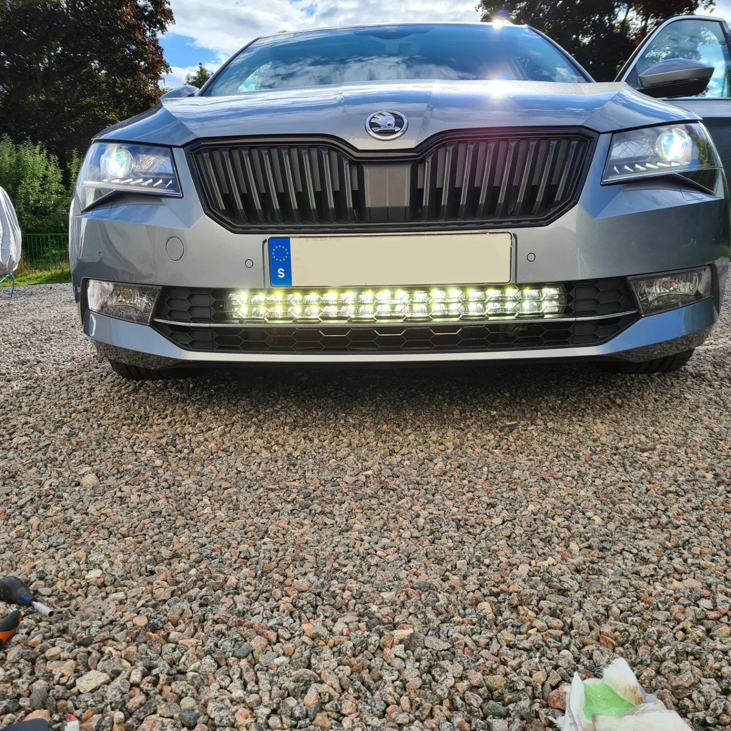

Since the highbeam is pretty bad i fitted a ledbar to improve the light a bit, happy with the result 🙂 It's dark here in Sweden during winter and a lot of wildlife on the roads so have to be prepared. I've crashed with a moose once and I dont want to experience that again. Will be changing the xenonbulbs too before winter comes, i think there is room for improvement there also.- The Superb III Picture thread
