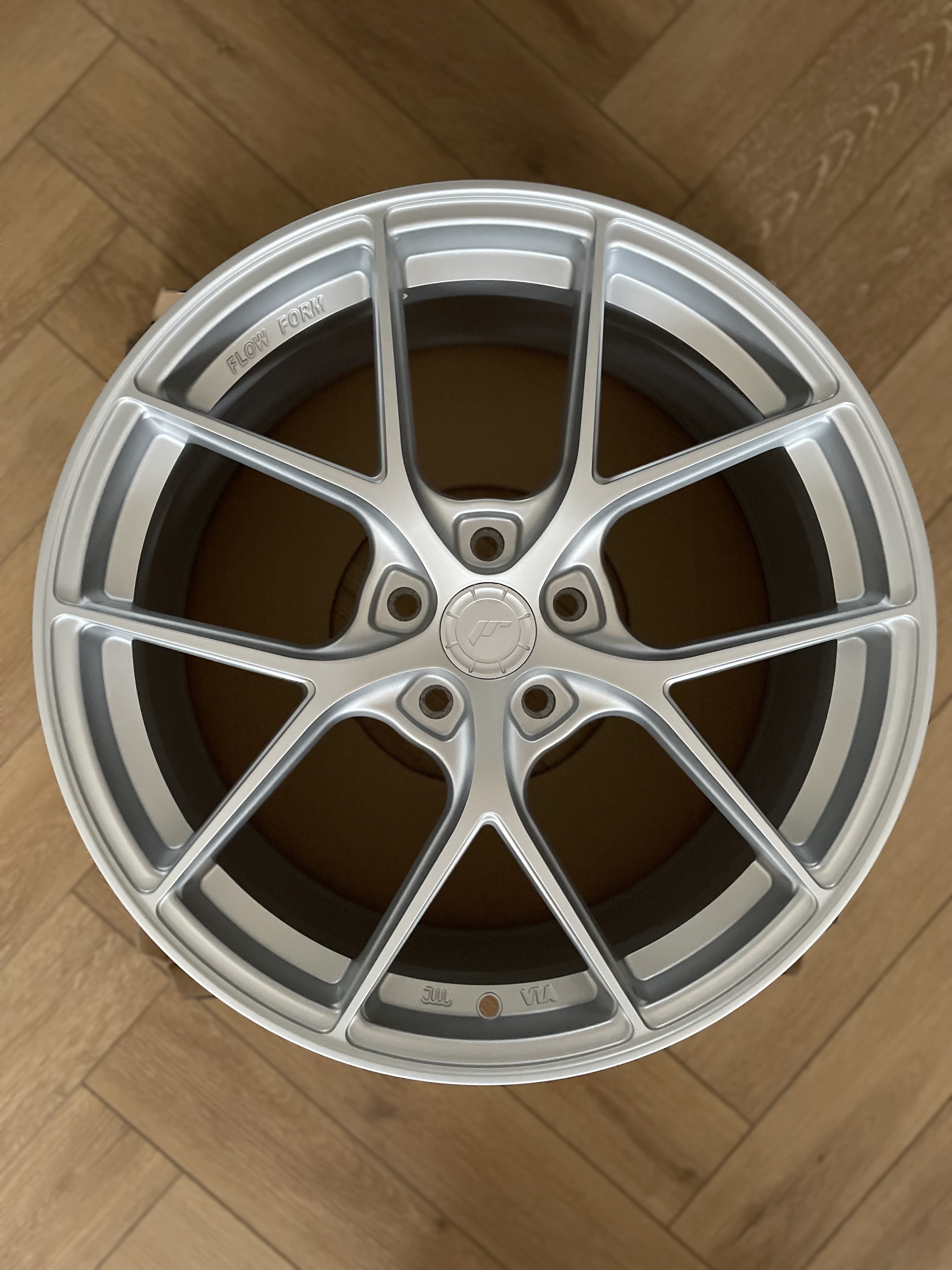

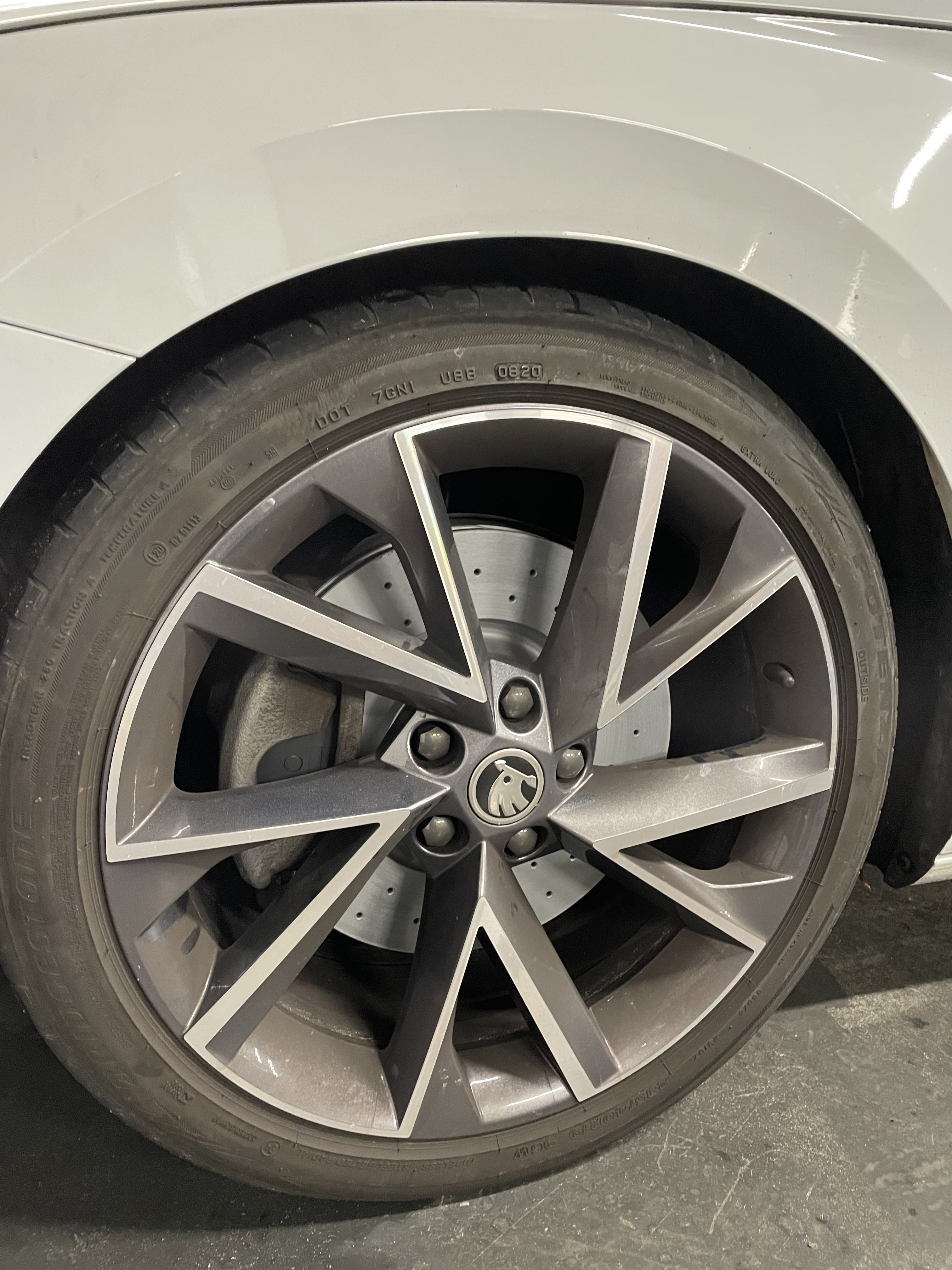

I’ve had them under the car for a while now, but forgot to post. The new summer setup: They are Japan Racing SL01, in 19x8.5 ET 33. They’re flow formed, so quite a bit lighter than the stock Vega’s (14,5kg), weighing in at just under 10kg. So a good 4kg improvement of unsprung weight. Not to mention the looks! 😍

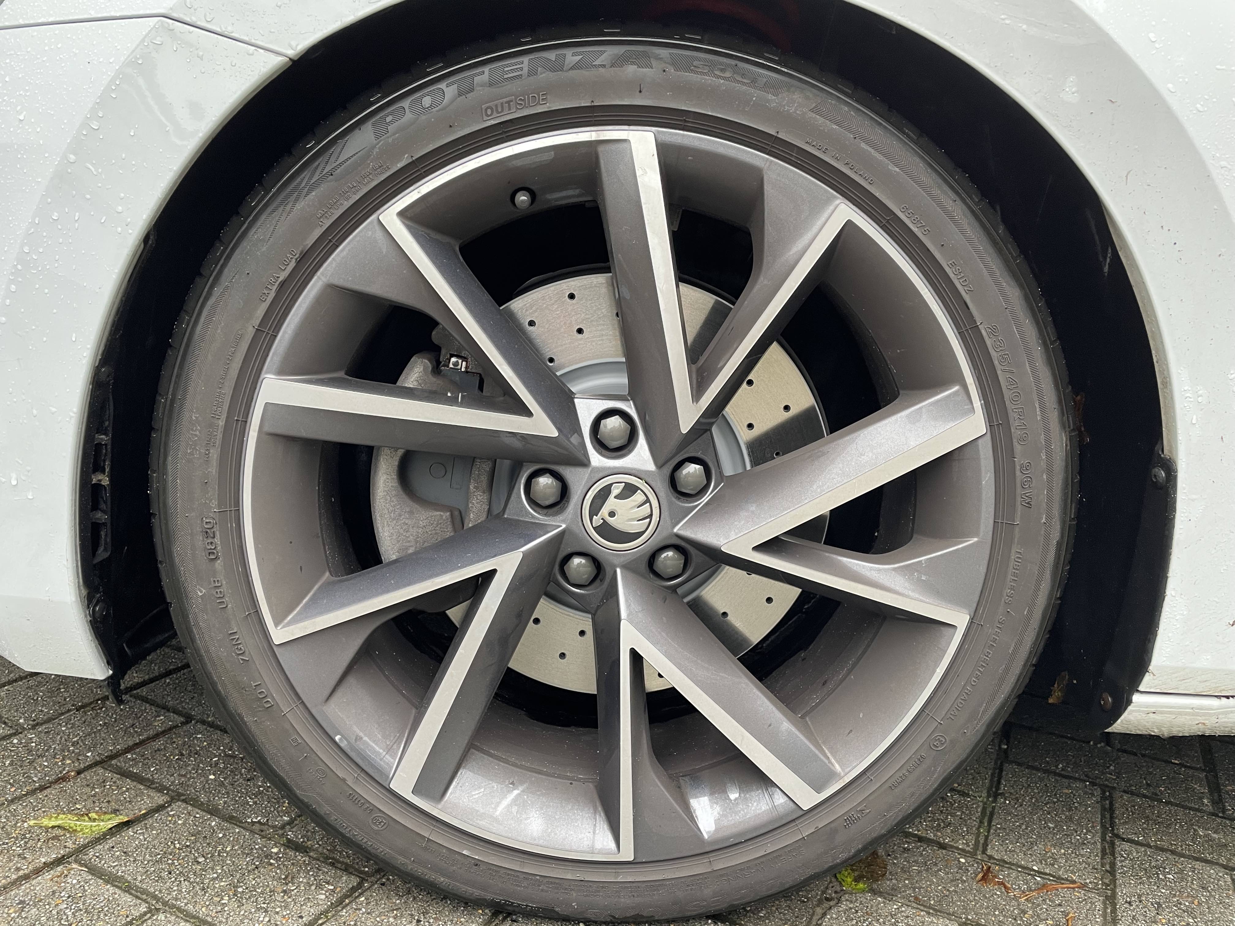

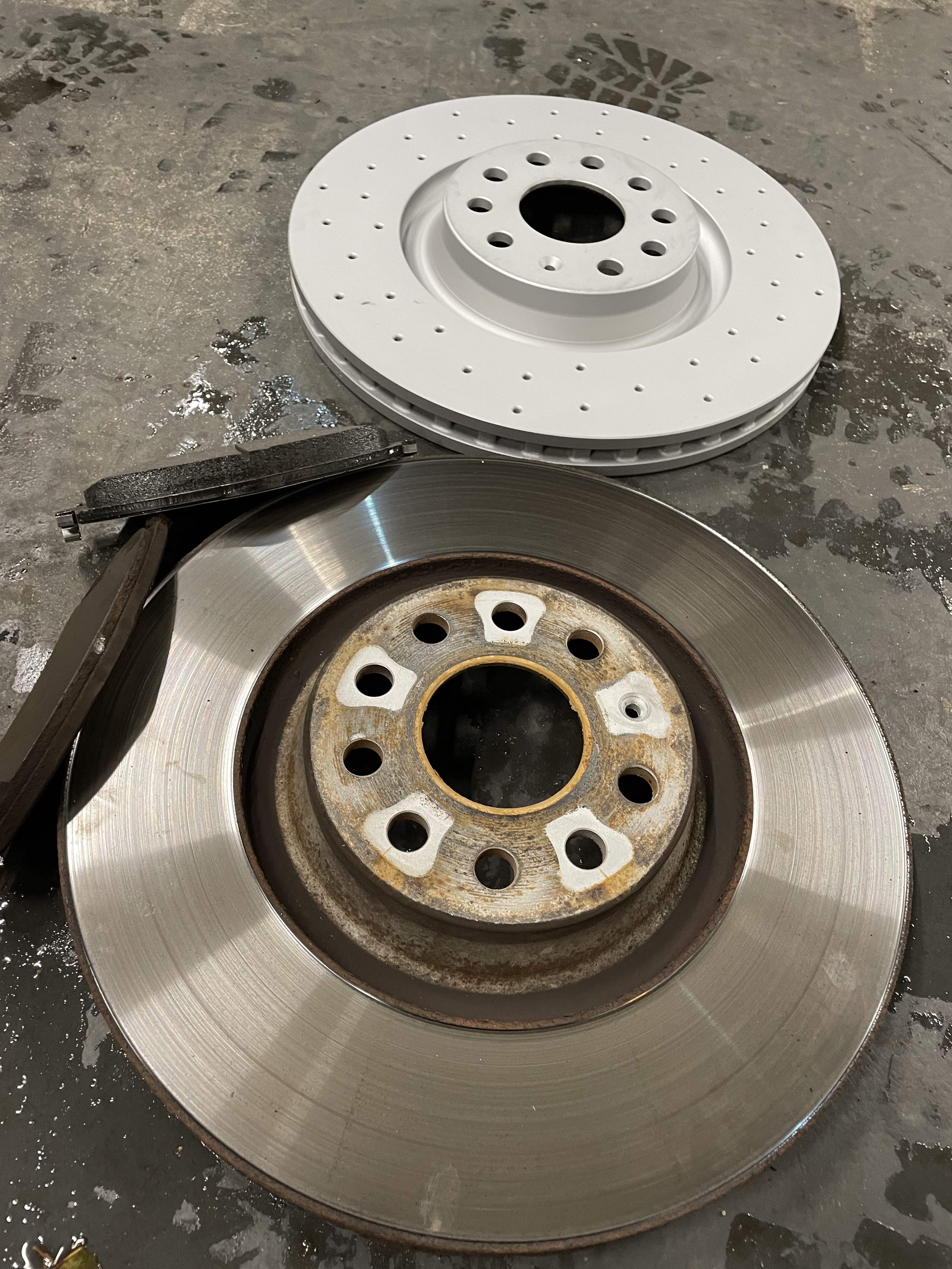

As promised, an update on the front brake upgrade. The front pads were up for replacement, and the discs were coming soon so I decided to sell this opportunity to the misses to also upgrade the pads and discs. And while we're at it, why not also brake lines and oil, right? After quite a bit of a search for parts, and dealing with some availability (not wanting to pay outrageous import and handling fees if I were to buy parts from the UK, and get them in NL), I landed on a nice combination of brands: - Tarox Strada Pads - Zimmerman Z-sport discs (could barely contain myself, but decided with all the holidays coming up not to splurge and go for the 2-part discs) - Goodridge braided lines - Goodridge Performance Brake Fluid All in all, I think money very much well spent! The brake pedal feel stiffer, the bite of the brakes is much firmer and more direct and overall feel of the brakes has just improved. Haven't had it in real extreme circumstances (repetitive hard braking) yet, but so far the brakes just give more confidence than OEM that they are going to stop and stop every time. Very happy with this upgrade! I also like the looks of these drilled discs, makes them look more purposeful and another hint of the performance potential of the car. I am doubting if I should paint the callipers, to make the whole set-up look a bit more sporty. But I do like the understated sleeper look of the car, and with a new set of aftermarket wheels going on in the spring, painted brake callipers might be a bit much... Now first get the winter tires sorted, and then a winter browsing for the summer wheel upgrade! (Any ideas? Preferably would go lighter than the OEM 19x8 Vegas I'm currently running, nearly 14kgs each...) And as they say, a picture speaks a thousand words, so hereby: Old vs. New Before bedding in: After bedding in:
