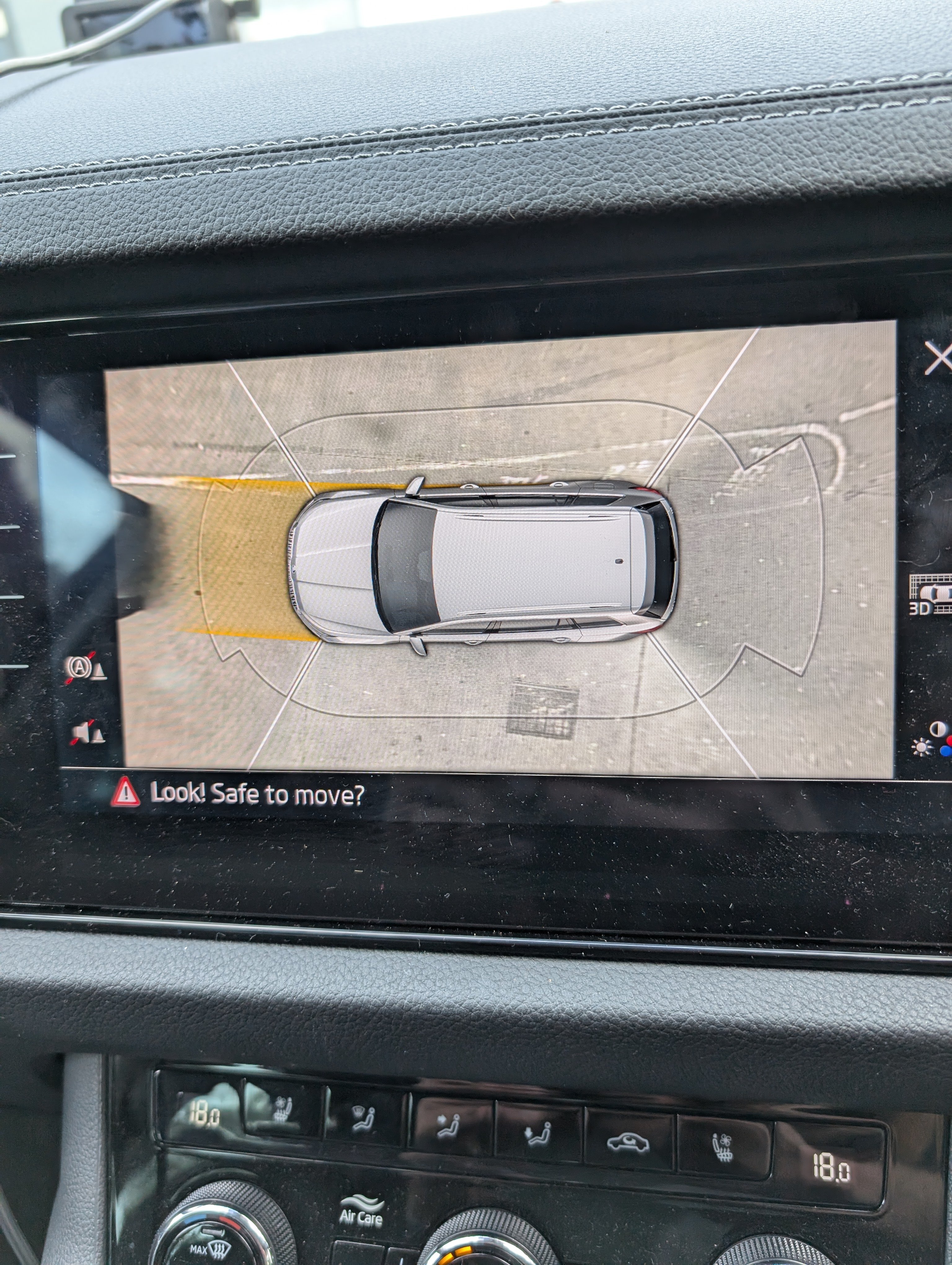

  1. Yeah that's the same video I watched. When I pressed park assist, I don't get the trailer view on the instrument cluster but a message similar to ' park assist stopped. Trailer attached ' 🤷‍♂️
  2. That sounds good but apprehensive that warranty would be void if I get the coding modified.
  3. I'm the second owner. The first owner bought this off the dealership floor. Its a demonstrator car so it came with almost all options for that trim level. That first photo is the view when you reverse to get the trailer hitched. The green line pivots when you turn the wheel and helps you back up right to the tow ball
  4. Ah, thanks! This is still Under warranty, maybe I should reach out to the dealer to check why trailer assist is not working
  5. Thanks @East_Yorkshire_Retrofits I m not very sure if I have the area view. I do have these options alongside 360 view and the photos I've attached. Does that count?
  6. Thank you for sharing that @ApertureS I recently used the trailer hook on the car. Noticed the trailer assist function is not active. It leads me to believe you need the blind spot sensors for the trailer assist feature. Would that be right?
  7. Hey, Guess your problem and mine might be similar. Mine says not available as I dont have sensors fitted OR the indicators in the mirrors Does your one have the blind spot indicators on the mirror?
