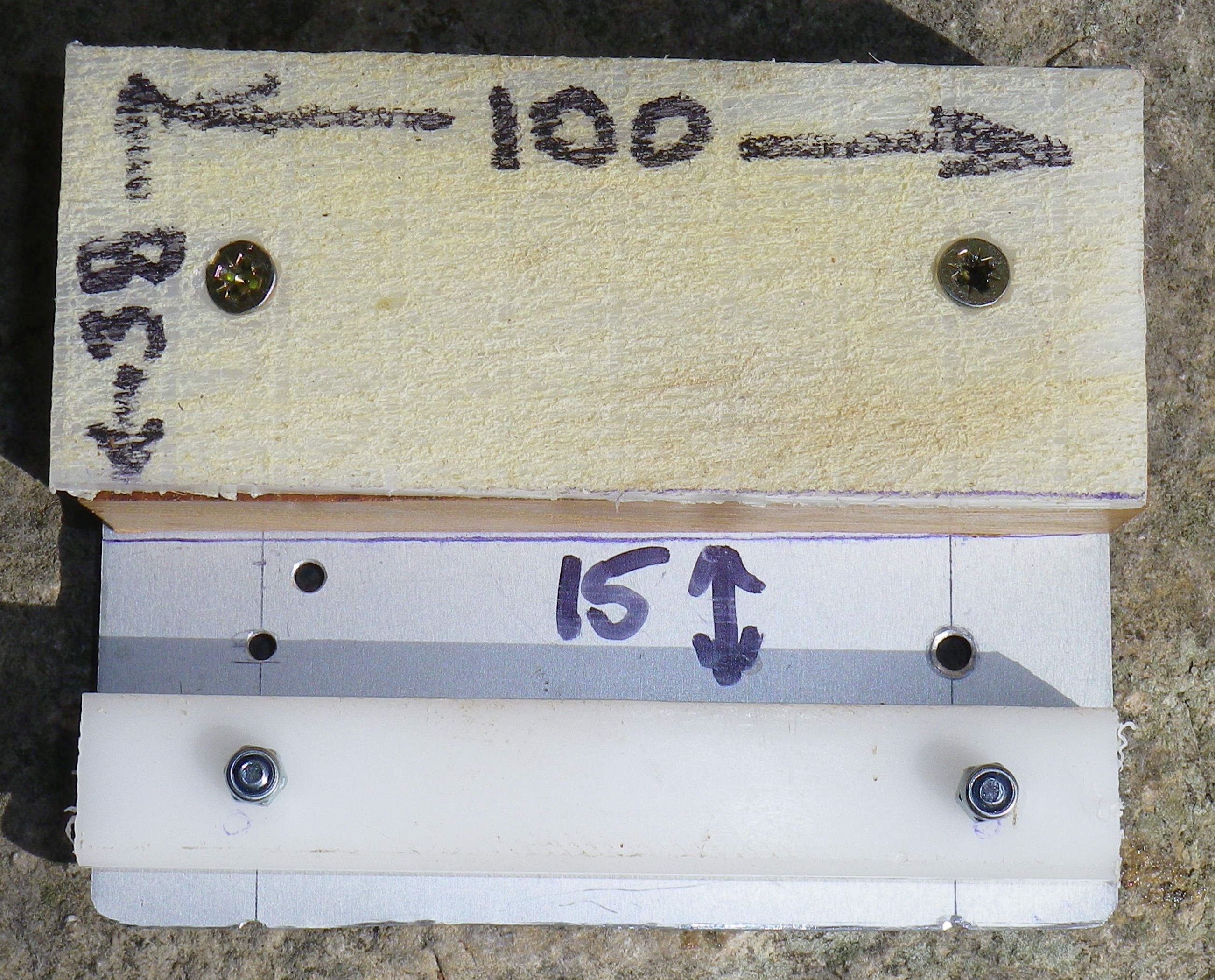

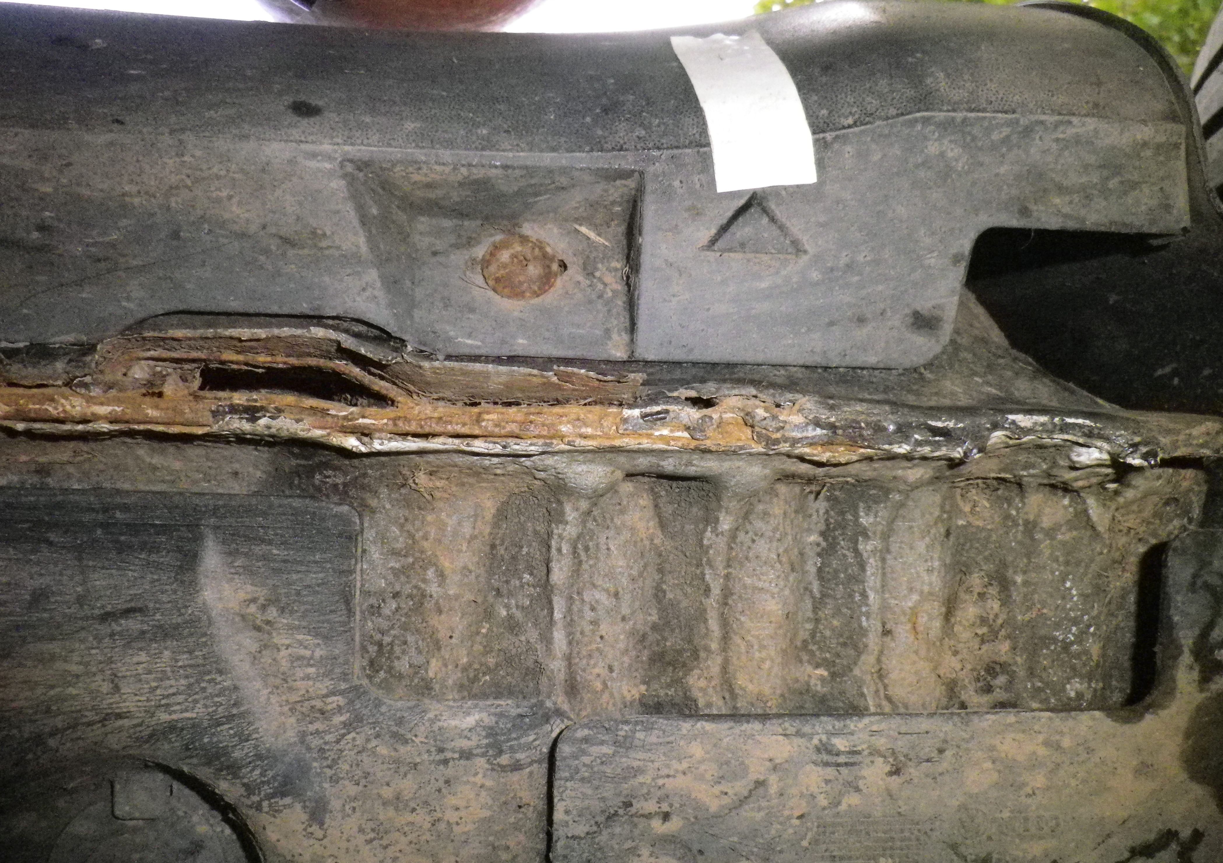

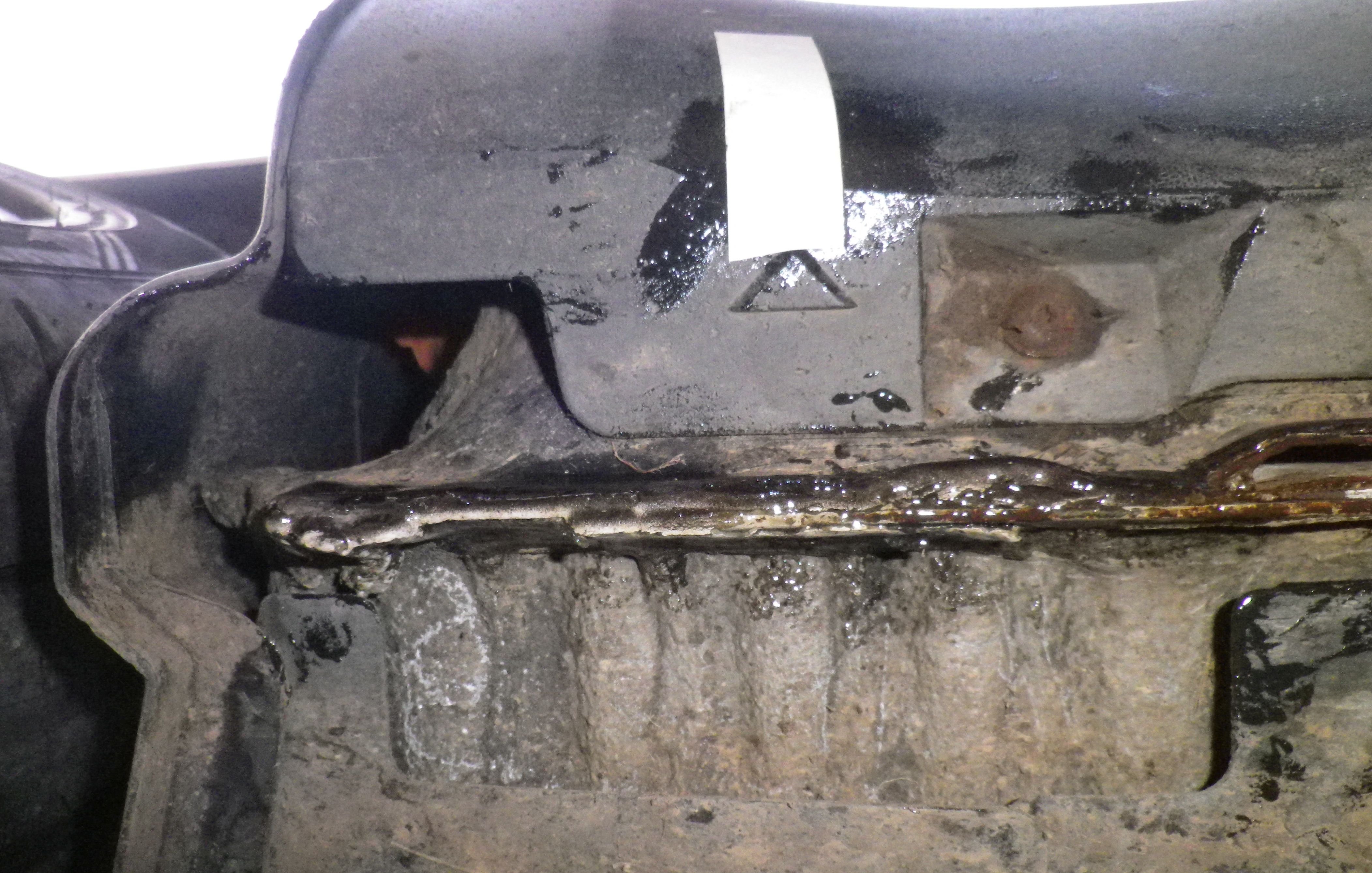

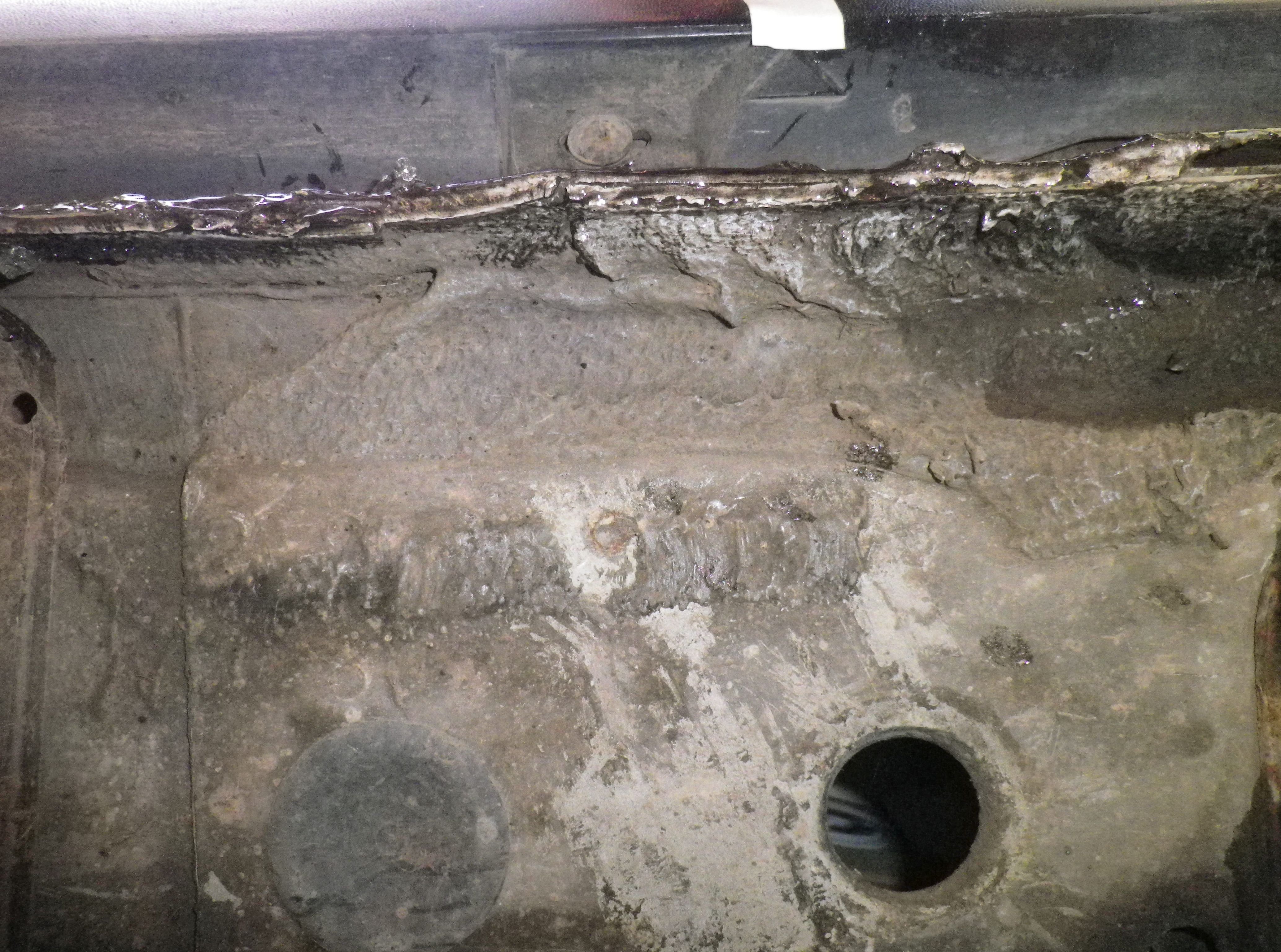

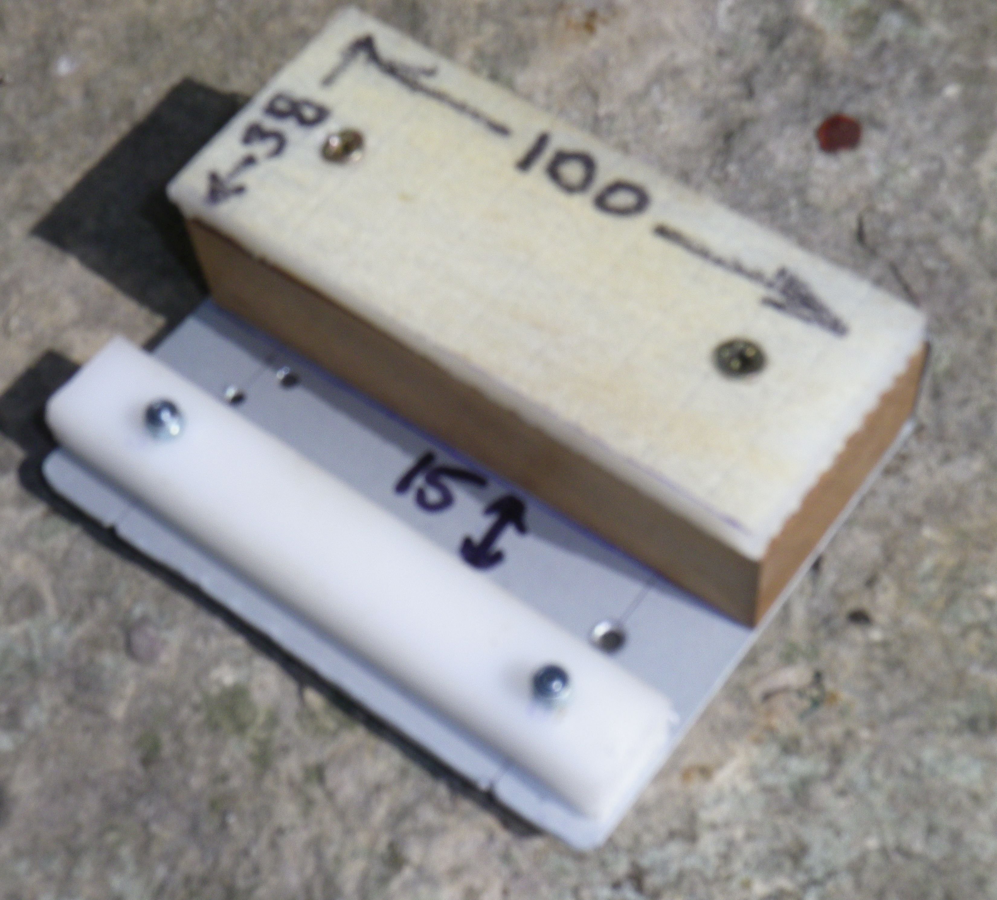

A load of stuff on this topic but here's mine to add: The front and rear trolley jacking points on the Elegance are a little inboard from the welded seam and should be indicated by the triangles. As you can see the underseal has obviously been broken for some time but I've poked a polymer sealant into the missing bits (only the front left so far). This particular sealant is Soudal's "Fix All", very sticky and sets quickly and somewhat rubbery even if damp. (I just happened to have the clear version). Best not to use silicone type sealants here. I made a simple jacking block from hardwood with a scrap of aluminium on the jack side and a piece of 100mm x 38mm polypropylene chopping board on the top. The wood and plastic combination sits inboard of the seam and the clears the seam height, just fitting inside the plastic under-cladding. Adding a small piece of plastic about 15mm outboard of the block assists location. This does work for the rear although there is a little more jacking area. Get yourself a mirror, mine was a from bathroom medicine cabinet.
