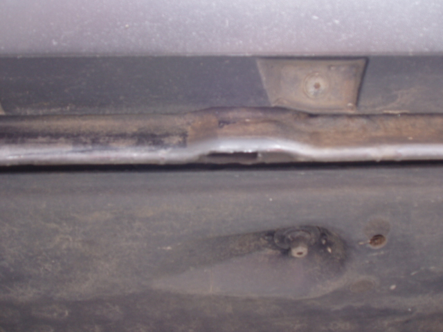

It's not that I think it's there , but as I said in my first post , " there's a similar 'jacking point' in the middle of the sill " , and I wondered if it was in fact a jacking point .
This looks the same as the officially designated jacking points at either end of the sill .
This is the point I'm referring to in the middle of the sill . . . .

They look like drains to me.
Jacking point usually has a downward pointing triangle on that seam.
Thanks , yeah they could be drain holes . The diagram in the manual pointed roughly to those areas so I thought they must be the jacking points , I've seen pictures of the triangles (arrows) you mention , but I can't see them on my car .
They are just drains in the sills, and NOT jacking points.

The triangles are not easy to see!
Cheers , I'm sure I'll find them if I have a proper look  :thumbup:
You need to get right down low to see the triangles properly.  It might even be easier to feel for them!  I marked the ones on my Yeti with a dab of yellow enamel paint.  There's still some clinging on there five+ years later - enough to make it easy to spot them still.
