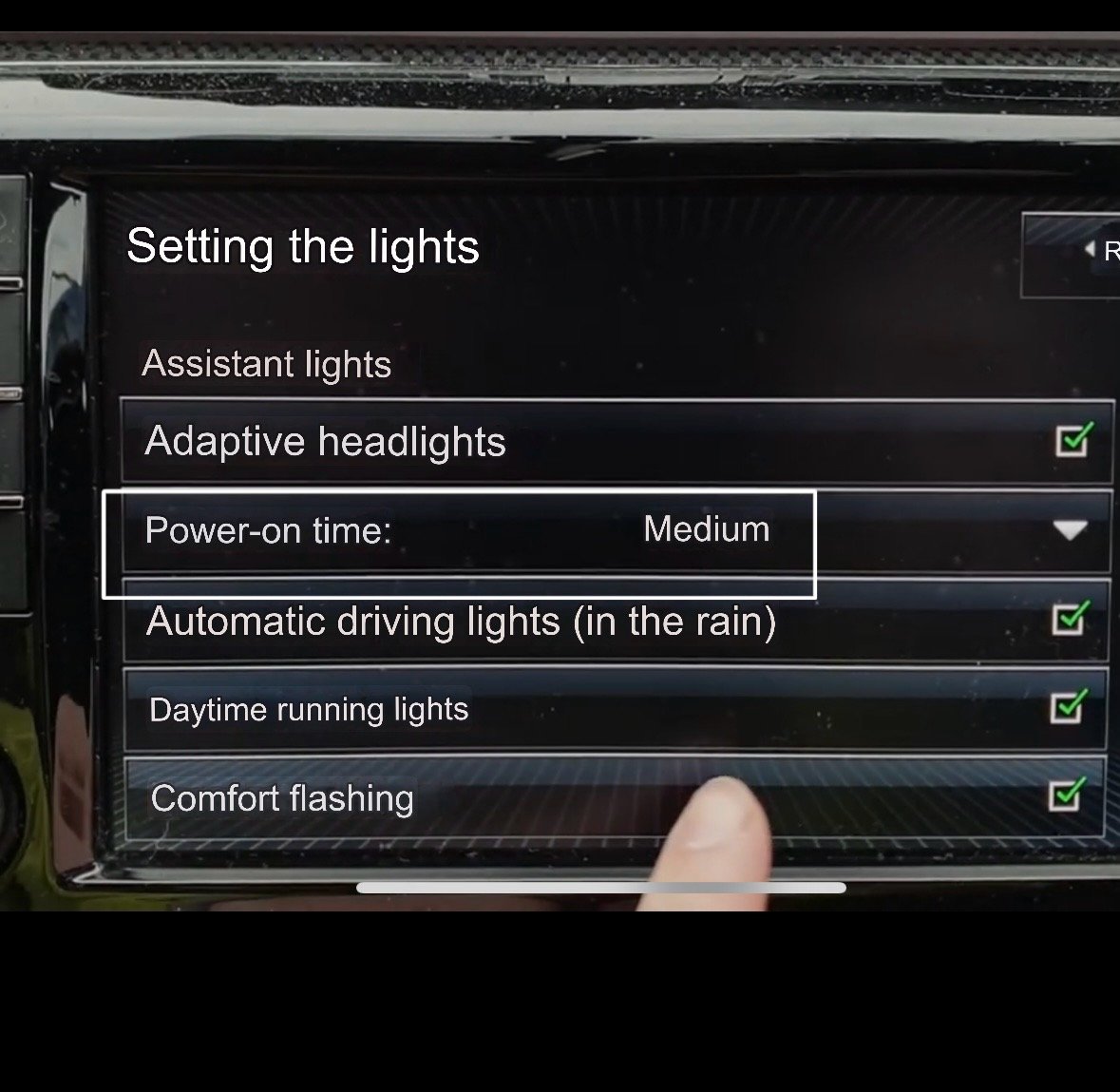

  3. You know this ?? when you drive the car at night and activate the high beam...the low beam rises higher for better visibility, after you turn off the high beam, the low beam goes down to its initial position

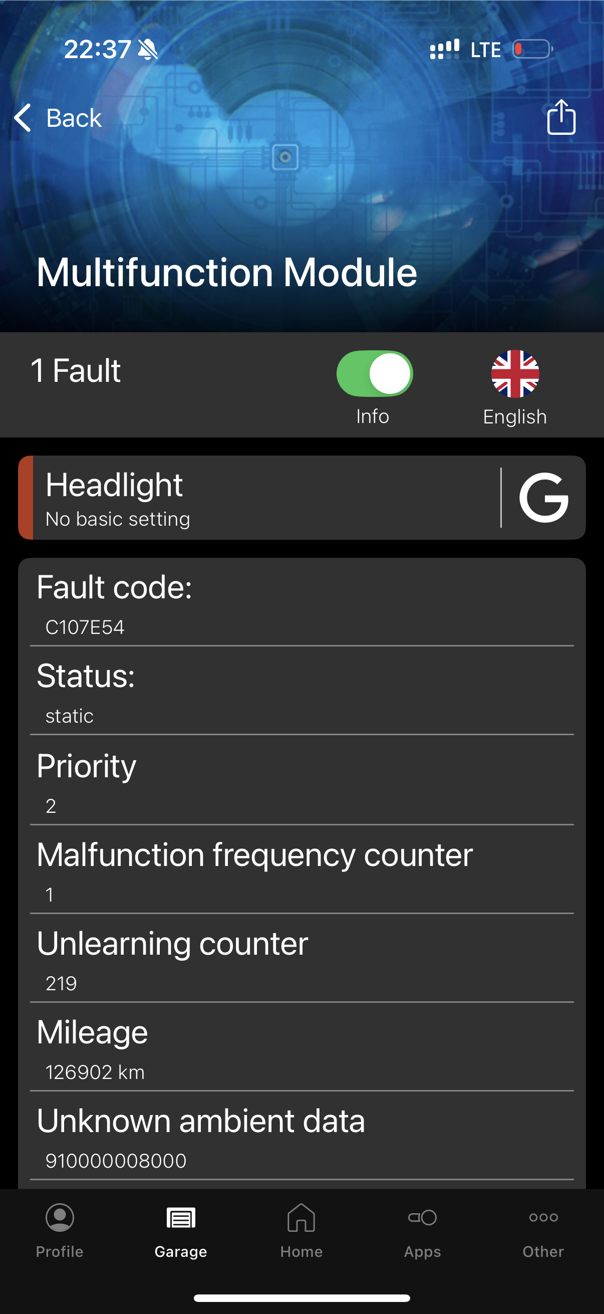

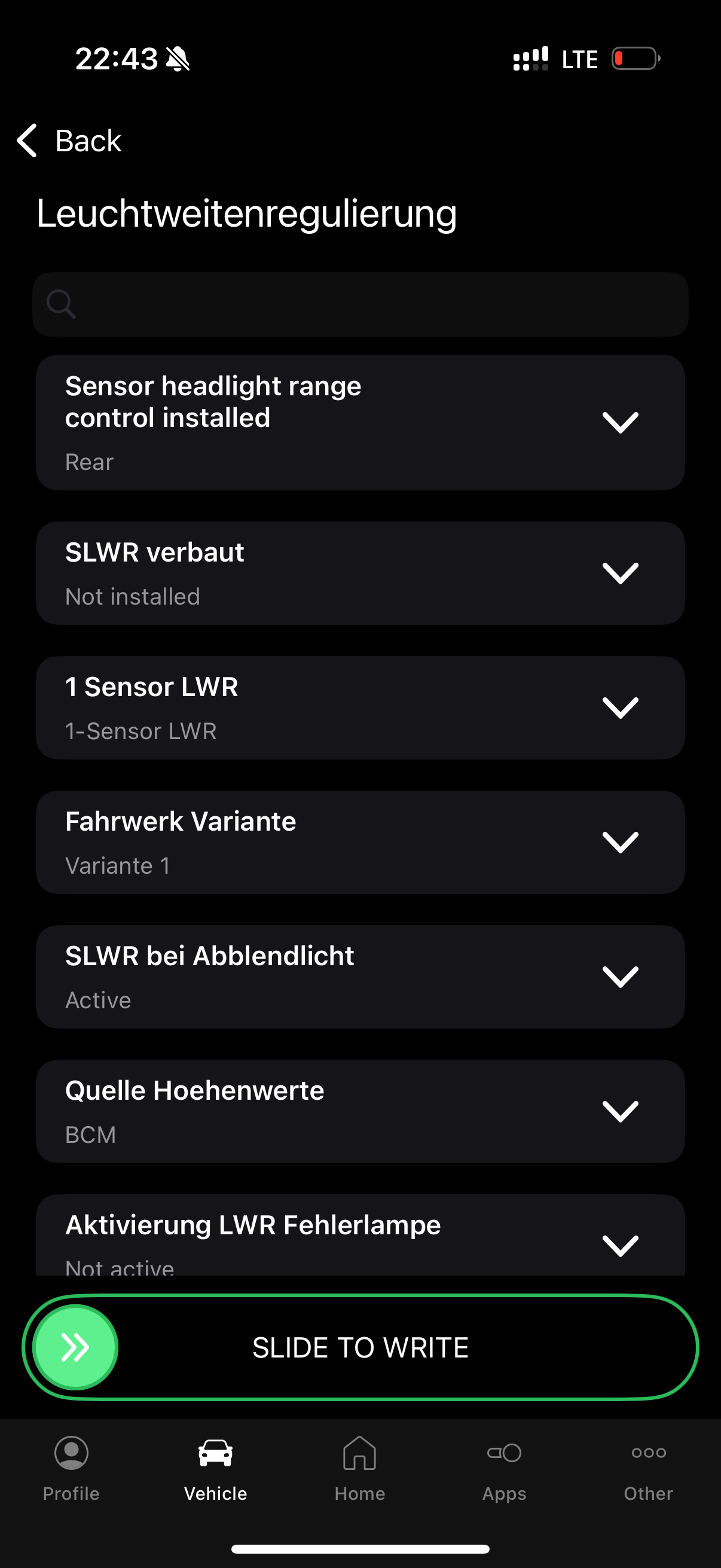

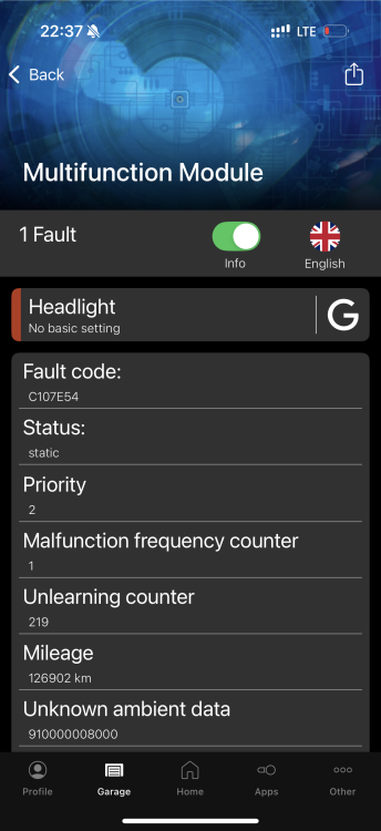

  4. In the end I don't have any errors anymore but what bothers me is the fact that the headlights don't move up and down when I turn on the basic settings.

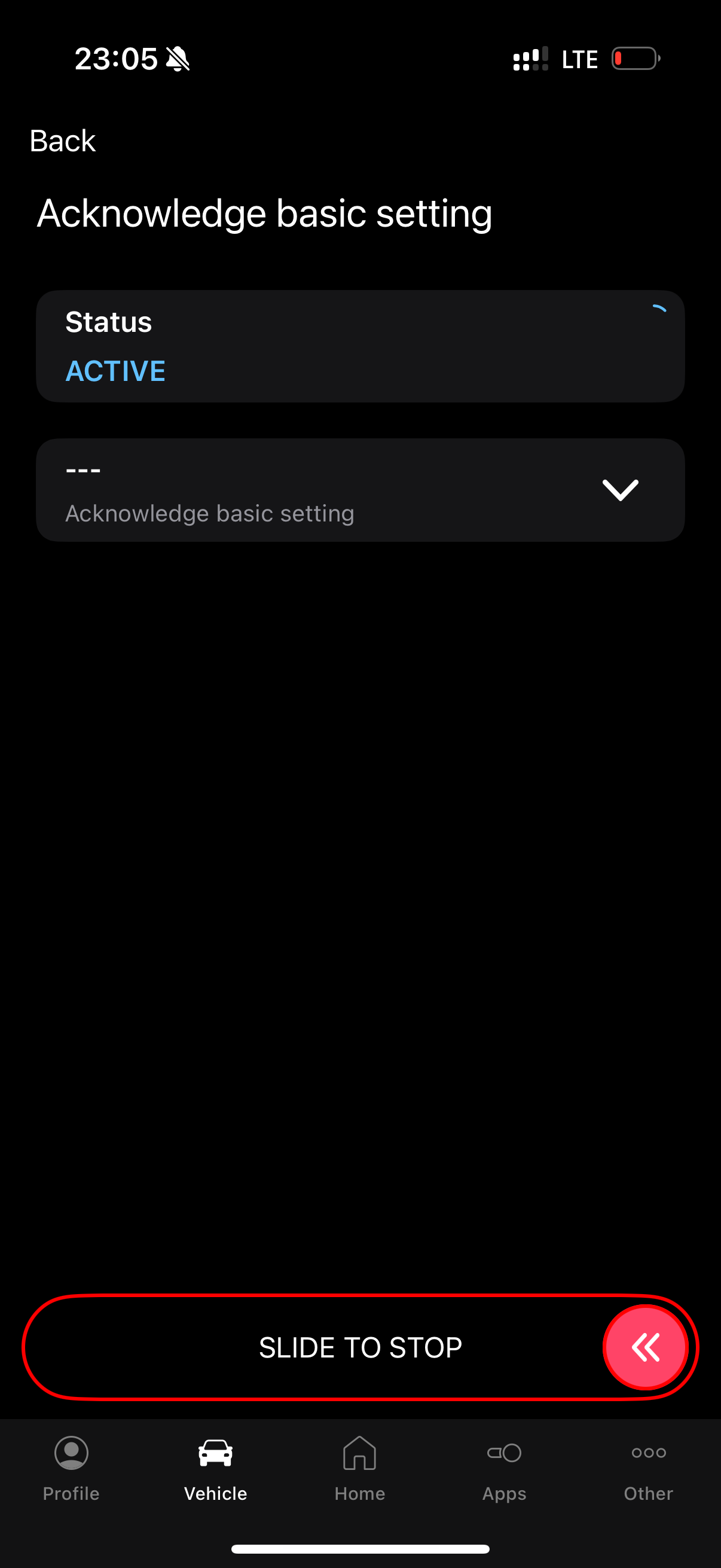

  5. I did, "Acknowledge" runs to the end as well as "Resetting counter for headlight range adjustment" only basic settings remain active or on vcds running
  6. I did this, but the problem is that in basic settings it remains active.

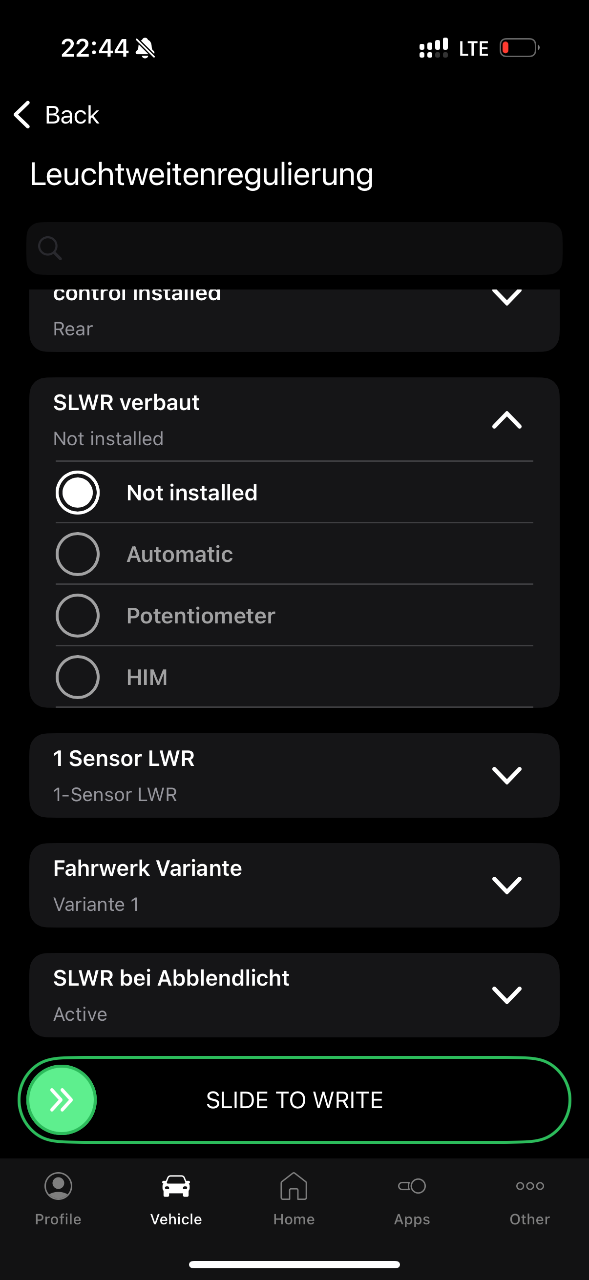

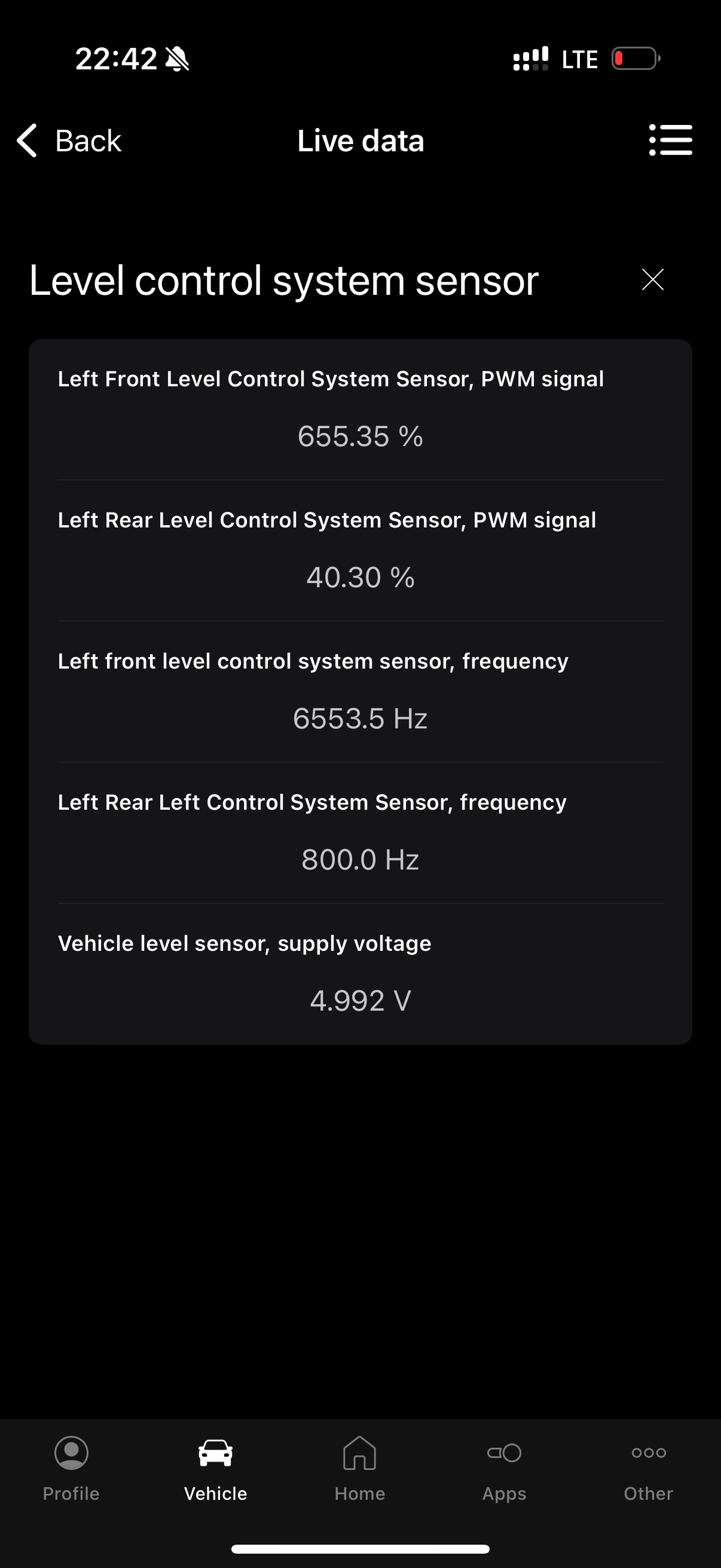

  7. hello everyone, I own a skoda octavia 3 vrs 2018 facelift and I bought the car with sports suspension, that is, h&r 40mm sports springs, the problem was with the headlights, they were too high, I also went to skoda to solve the problem but without success they said to put the suspension back in place... several searches on the internet I found that the sensor rod must be replaced with an adjustable rod, I changed the rod, I brought the sensor into working range, I try to do basic settings from the electronic control unit or from hex4b but it doesn't work..it stays stuck on active in obd11 and in vcds it stays on running, it doesn't change... I also entered live data Level control system sensor Left Rear Level Control System Sensor, PWM signal 40.30 % -should I increase the percentage to 50?? and here at "Leuchtweitenregulierung" SLWR verbaut Not installed is it normal?? Ps:one more thing, I manually adjusted the headlights so as not to blind other traffic participants I noticed that Skoda has a very interesting function (but it doesn't work for me)...when you drive the car at night and activate the high beam...the low beam rises higher for better visibility, after you turn off the high beam, the low beam goes down to its initial position

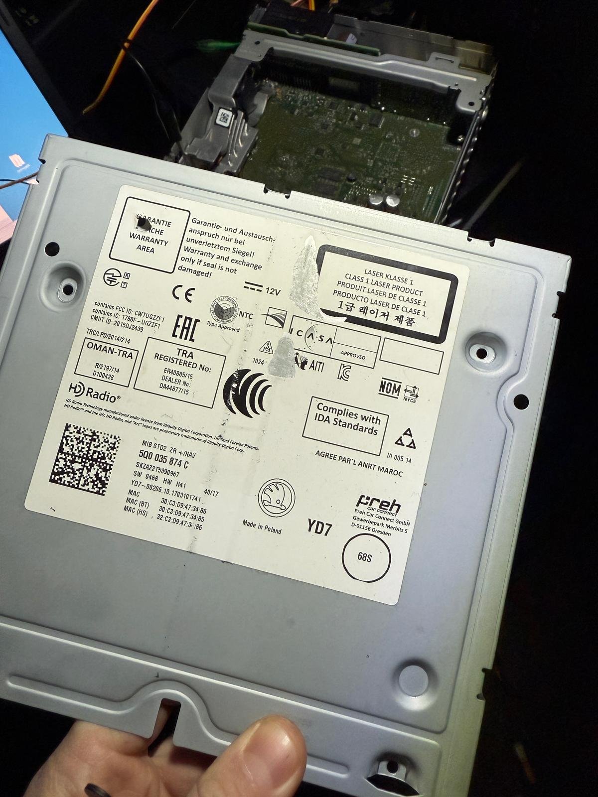

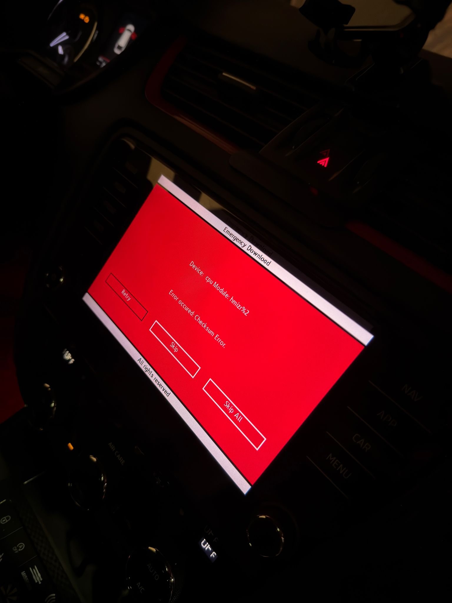

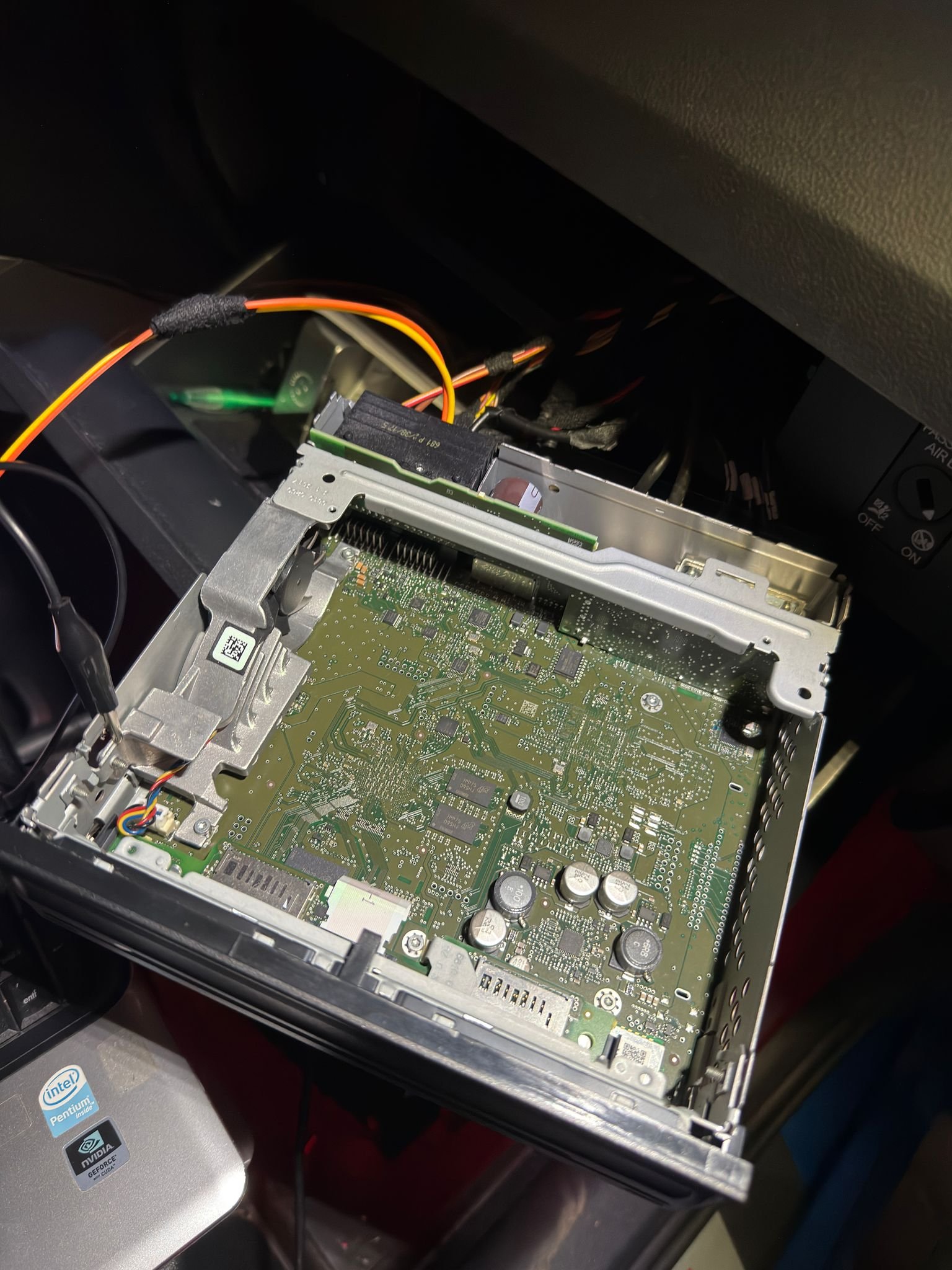

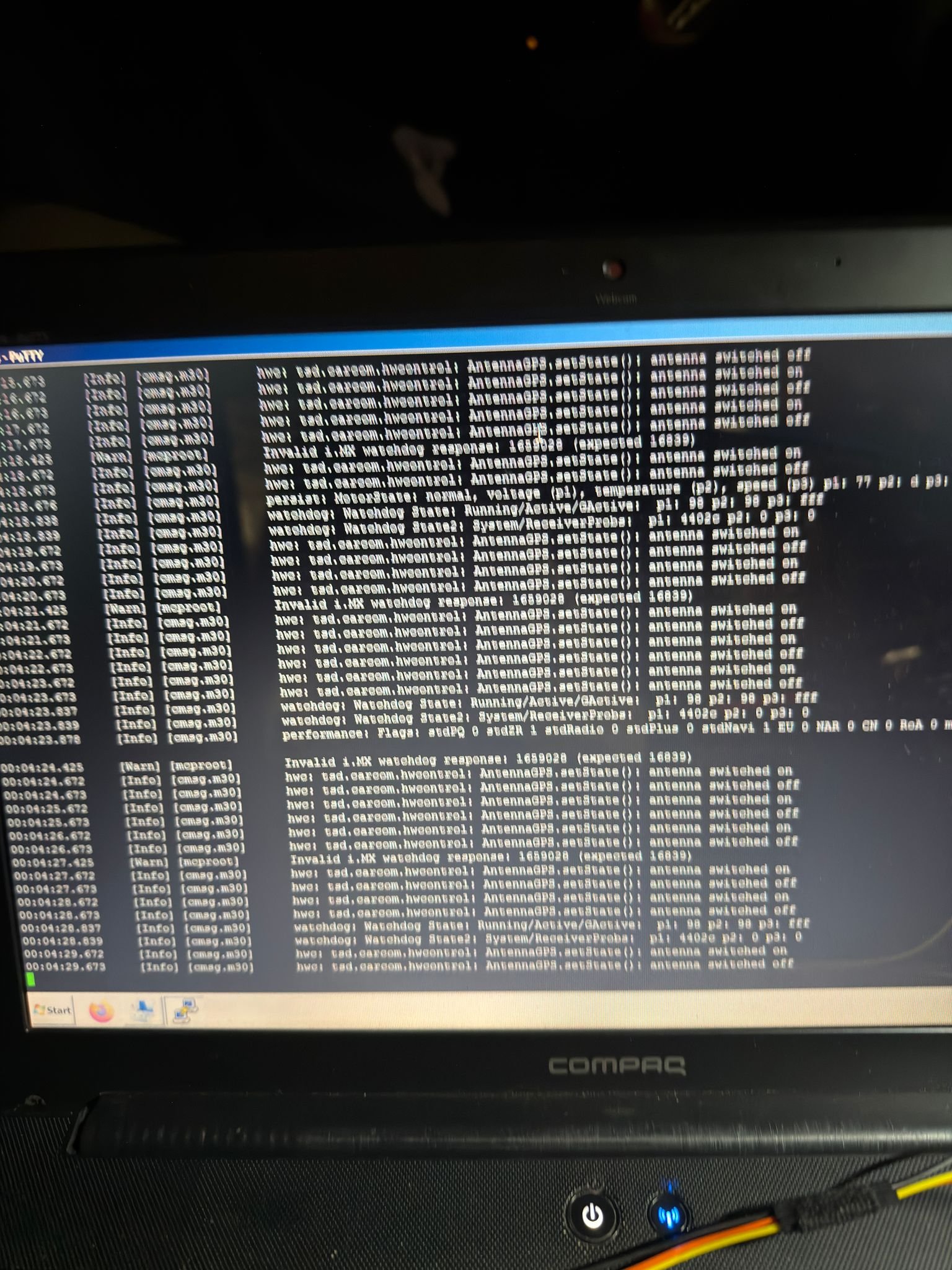

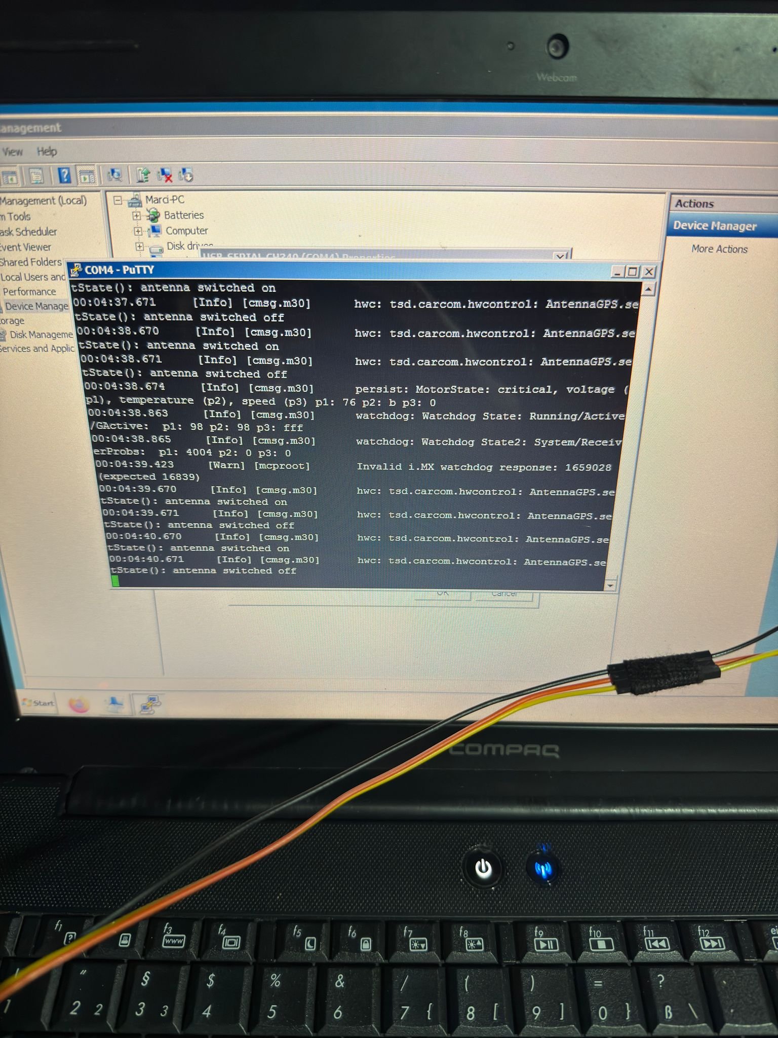

  8. i solved the problem with a emergency recovery and the firmware must be the same when the unit was stuck... now works perfect, no errors, no problem
  9. I made a mistake, I put the latest version of the software on the card, everything went perfectly, but I had a problem with navigation, when I put the address and started it, after 5-10 seconds I got an error "Navigation database not available", I wanted to go back to the initial version and put the old software on the sdcard and entered swdl, I checked the box, I started the download, I selected all, but the problem is that I did not deselect emergency, hmizr, etc., I wanted to do the same thing with the laptop and emergency download but I can't... is there anything i can do to recover it?? , please help me
  10. i downloaded from vw because from skoda the servers always crash i always download from vw tiguan 2019 discovery media and works good...after i made firmware update..i had this problem
  11. hello everyone can someone help me please. I updated the firmware unit and updated the maps...but after entering an address and starting it, after a few seconds I get this error "Navigation database not available"
