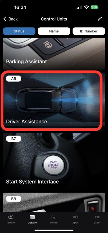

  1. Hi everyone—my car doesn’t have emergency assist. Video: https://www.youtube.com/shorts/jO6YF6rmtpE Is there a way to configure it like the newer models shown here? https://www.youtube.com/watch?v=vtzUGGS_3FQ

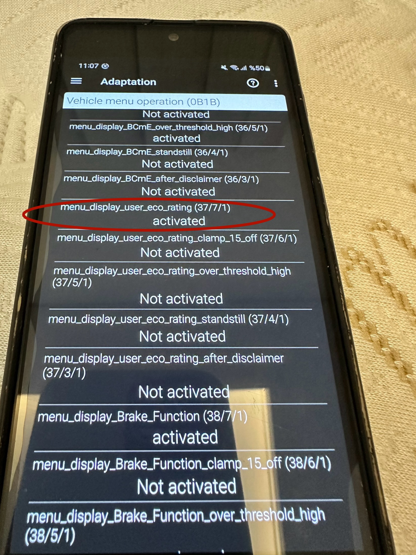

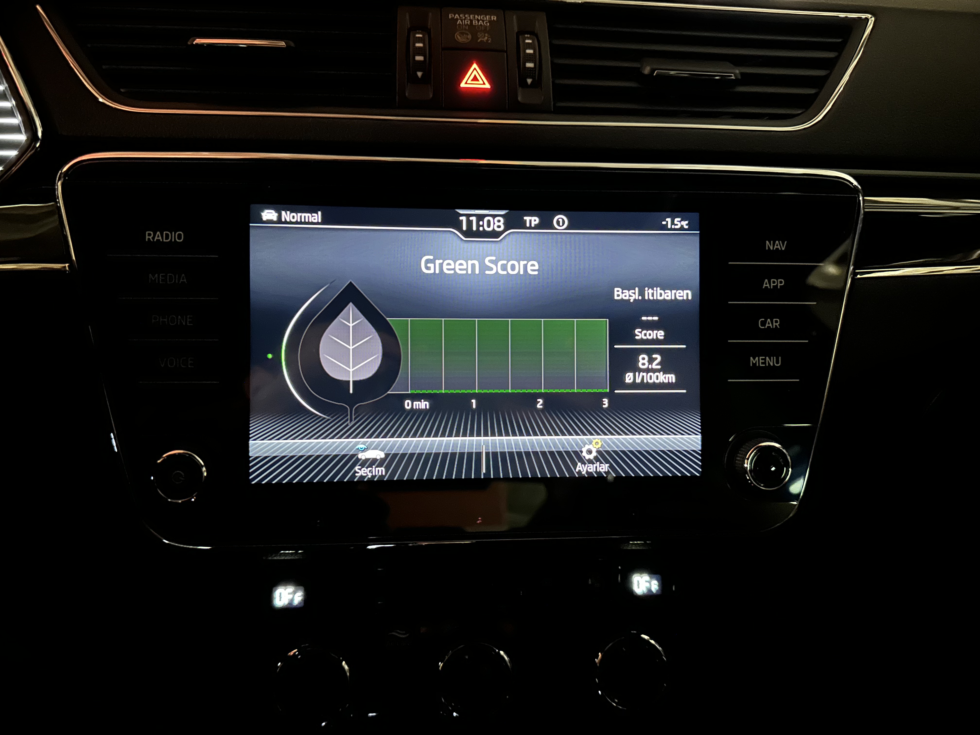

  2. Green Score ❌ Module 5F, Adaptations, change channel: (186)-Car_Function_Adaptations_Gen2-menu_display_user_eco_rating change from not activated to activated GREEN SCORE 2 (❌) GREEN SCORE MENU CONTROL UNIT 5F – INFORMATION CONTROL UNIT 1 ADAPTATION VEHICLE MENU OPERATION menu_display_user_eco_rating - activate menu_display_user_eco_rating_over_threshold_high - activate And GreenScore menu (❌) Module 5F Adaptations - 10 Wagen menu bediening (=dutch) EN: Car menu control menu_display_user_eco_rating: set to activated menu_display_user_eco_rating_over_threshold_high: set to activated

  6. hmm. this sounds odd. should it be possible considering not only consumption but other factors too? My idea to open this screen is that could be funny to keep tracking the scores and try to get a higher score each time @Bap33 If this is the fact I would not take the risk. Because they say that playing with swap codes may affect warranty. I would not wanna do that @ApertureS the last think that I wonder is that activating 'user_eco_rating_threshold_high' changes anything?
  7. today I changed the adaptation of menu_display_user_eco_rating from not activated to activated but still could not see any green dots or meaningfull info. Just empty screen. Do I need to change some adaptations too? an
