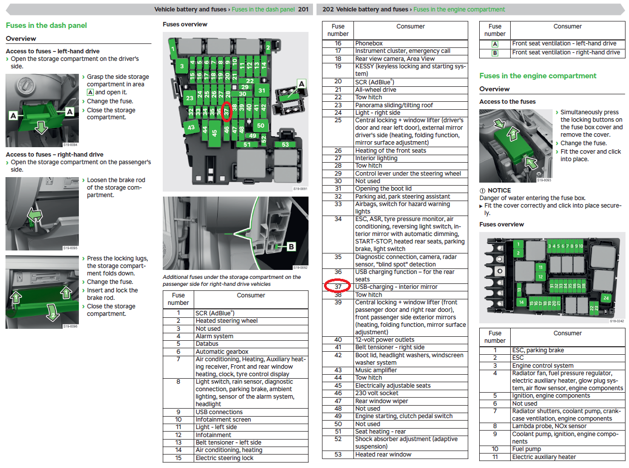

I also have the USB-C blanking plug in my mirror housing, and this morning I have taken a look at the fuse-box behind the glovebox and I have noted a fuse position 37 specifically for the mirror USB power supply.
It don't have a fuse of course but is also missing the wire that would take the power to the socket, it only has the feed voltage connection, ignition controlled so I think I will use it for my front dash cam, I cannot see the point in taking the mirror apart now in the hope the power is sitting their waiting because the wire is not in the loom.

@Tankdave - I've used the following Fuse locations for my dashcam and TPMS retrofit.
#16 - Phonebox (permanent)
#30 - Boot 12v socket (permanent)
#47 - Rear Wiper (switched)

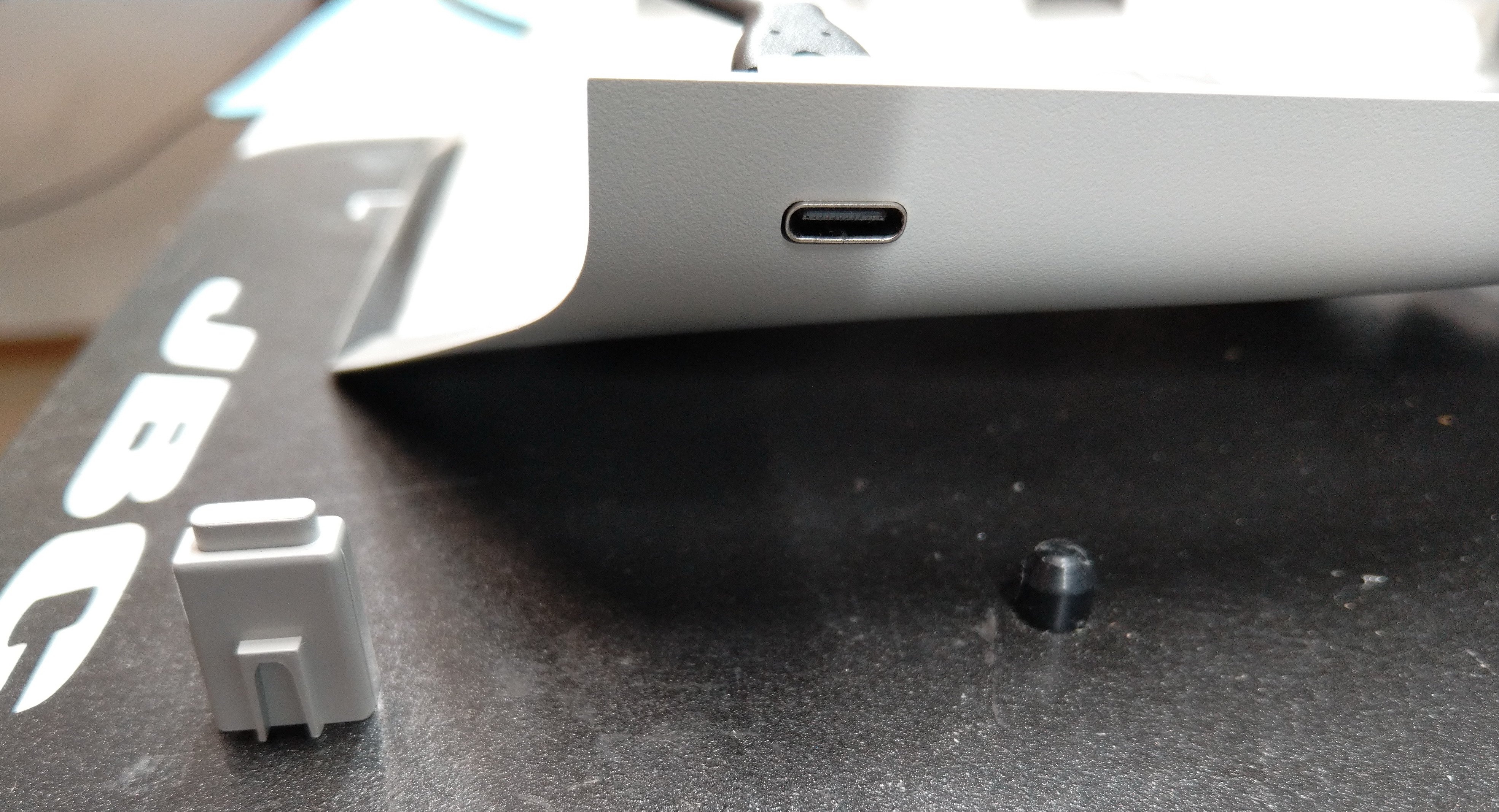

HI guys,

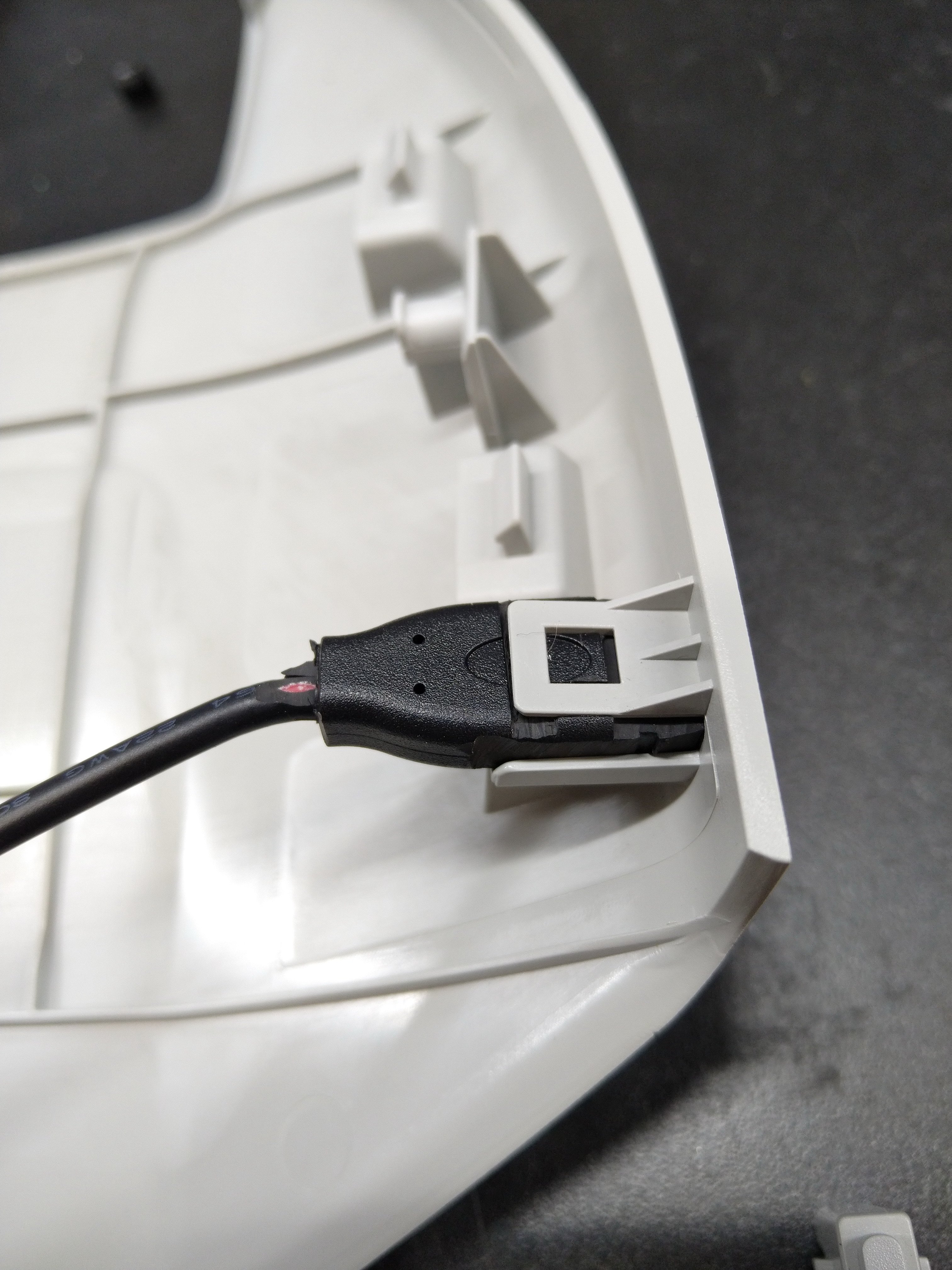

- I have tried to add USB-C power socket into interrieor mirror.
-  power source 12V - I have used an empty position in fusebox nr. 37 - reserverd for USB-charging - interior mirror (see pic.)

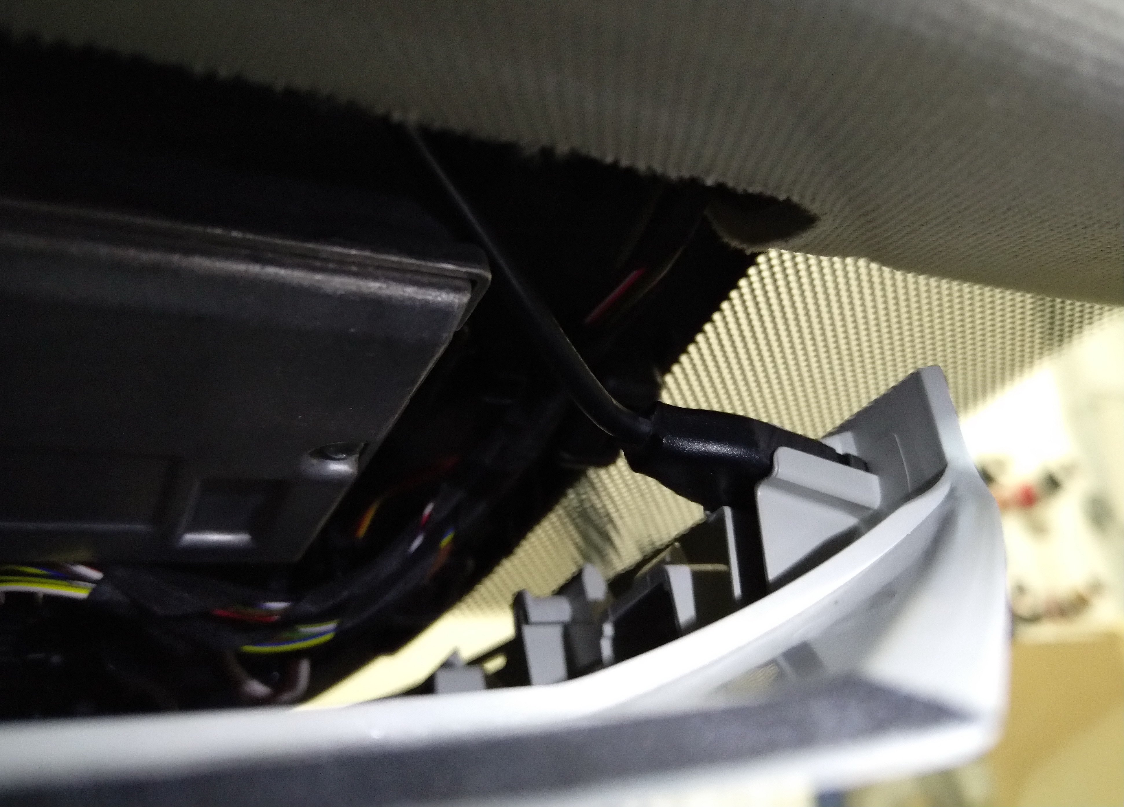

- As cabeling i used 1,5mm2 cable. I used route threw front pillar and than under upholstery (above the driver)

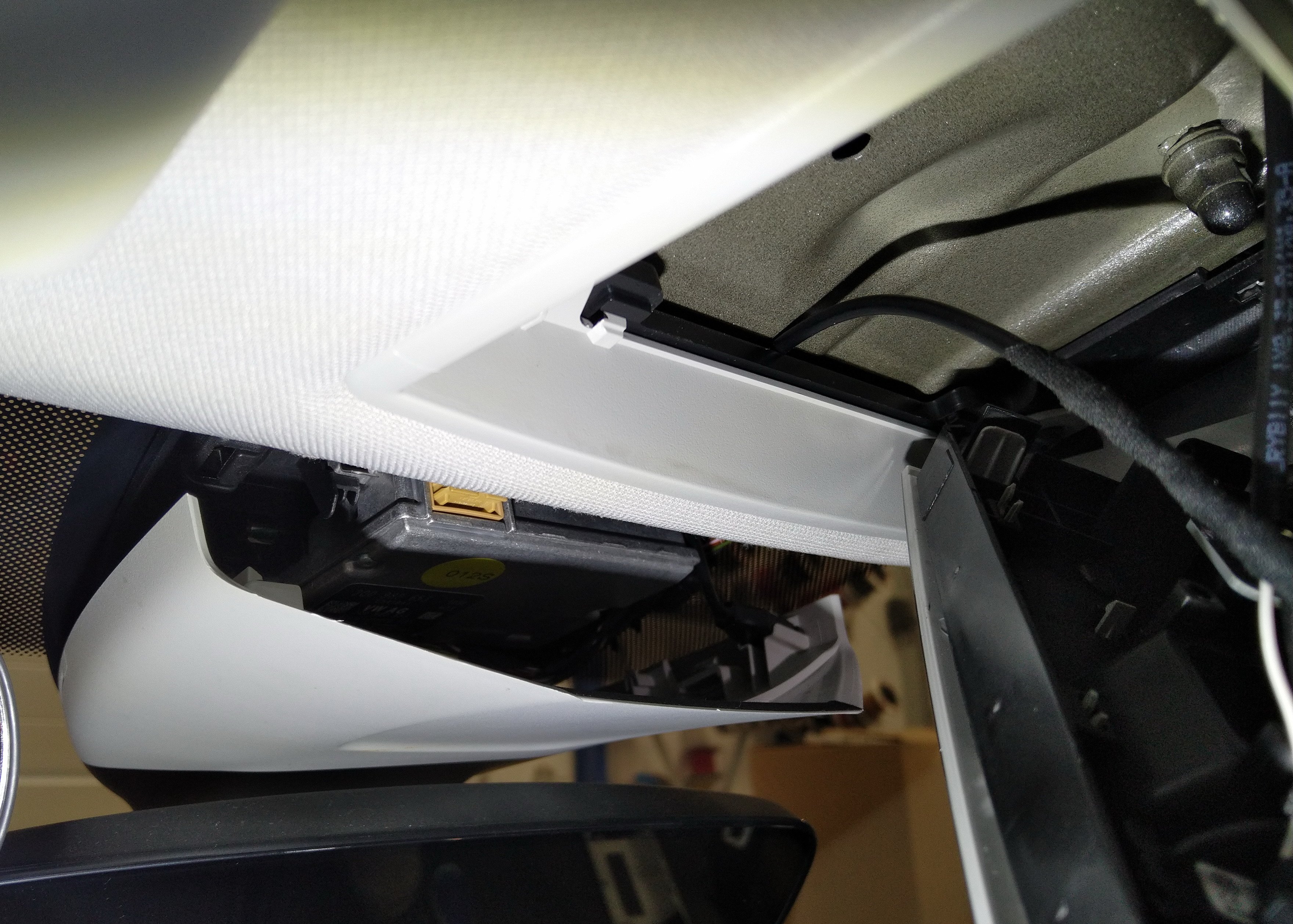

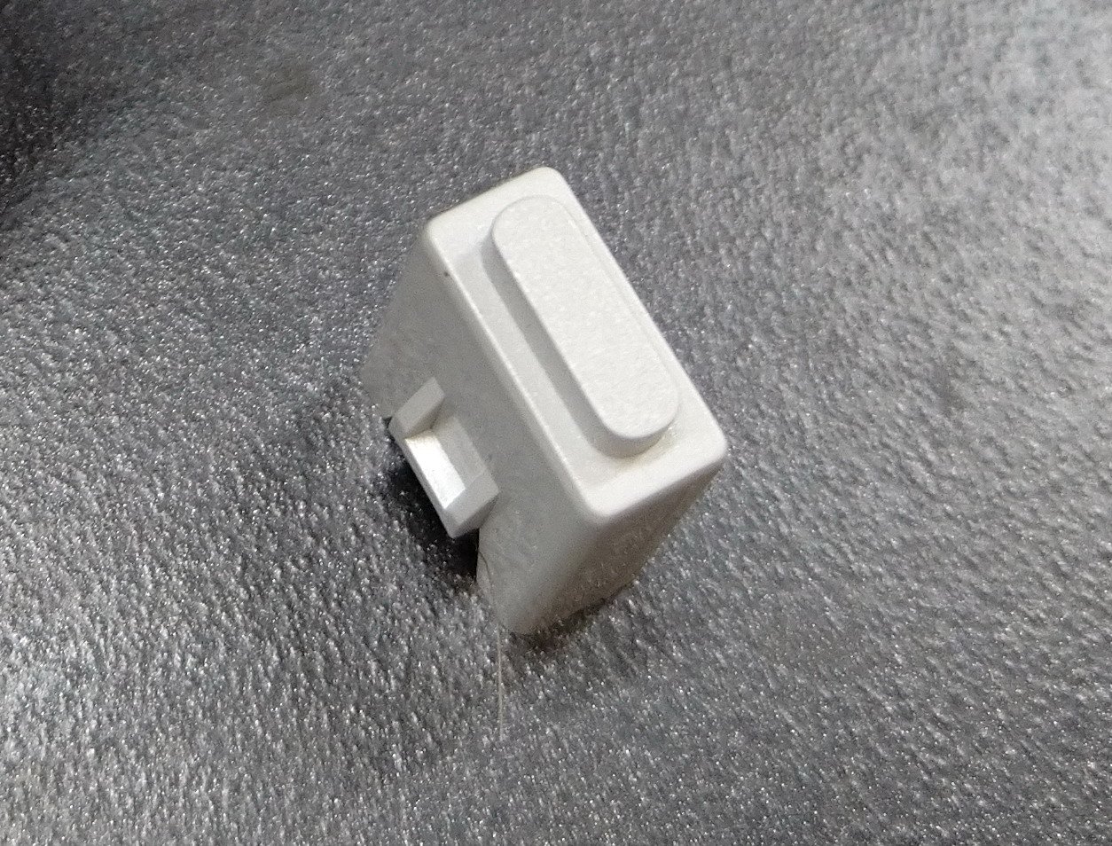

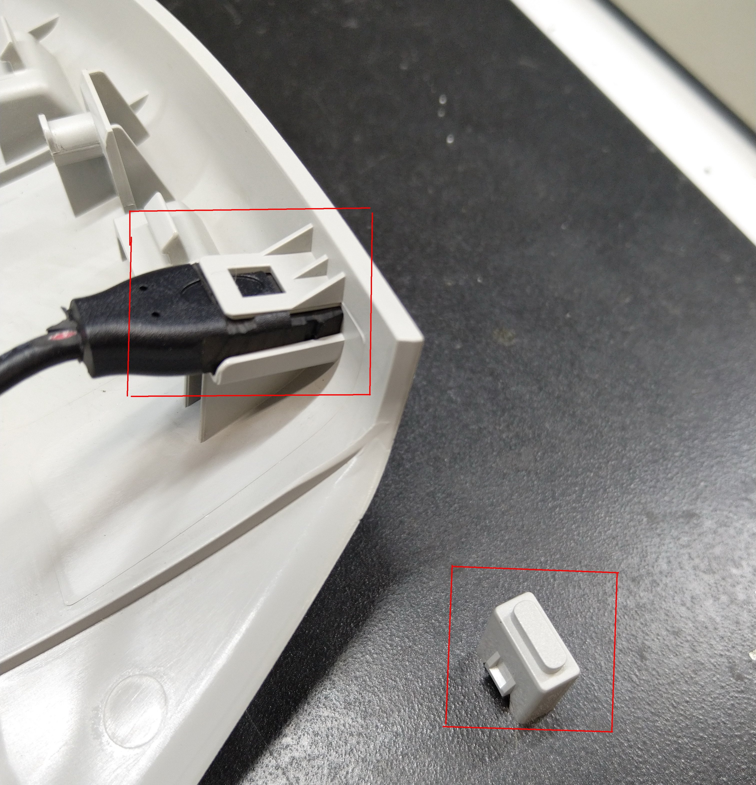

- after disassembling mirror plastic covers, I found out, that there is small plastic blind hole. After choose out there is nice hole for USB-C
- I have used USB-C female plug that a found in my supplies. I only cutted black plastic with knife to look as original plastic blind hole.
- I have not used any glue, just plugged in and it fits.
- All cables interconnections are above lighting - there you dont need unscrew any screwdrivers, just pull out lighting module
- I used DC-DC step down converter (8-22V) to 5VDC / 5A.
- if somebody want to use higher voltage (for example 9, 12 or 20V) should use DC-DC converter with communication module to comunicate the right voltage with device. And also USB-C socket with 4 wires (i have used socket with only 2 wires for power)
