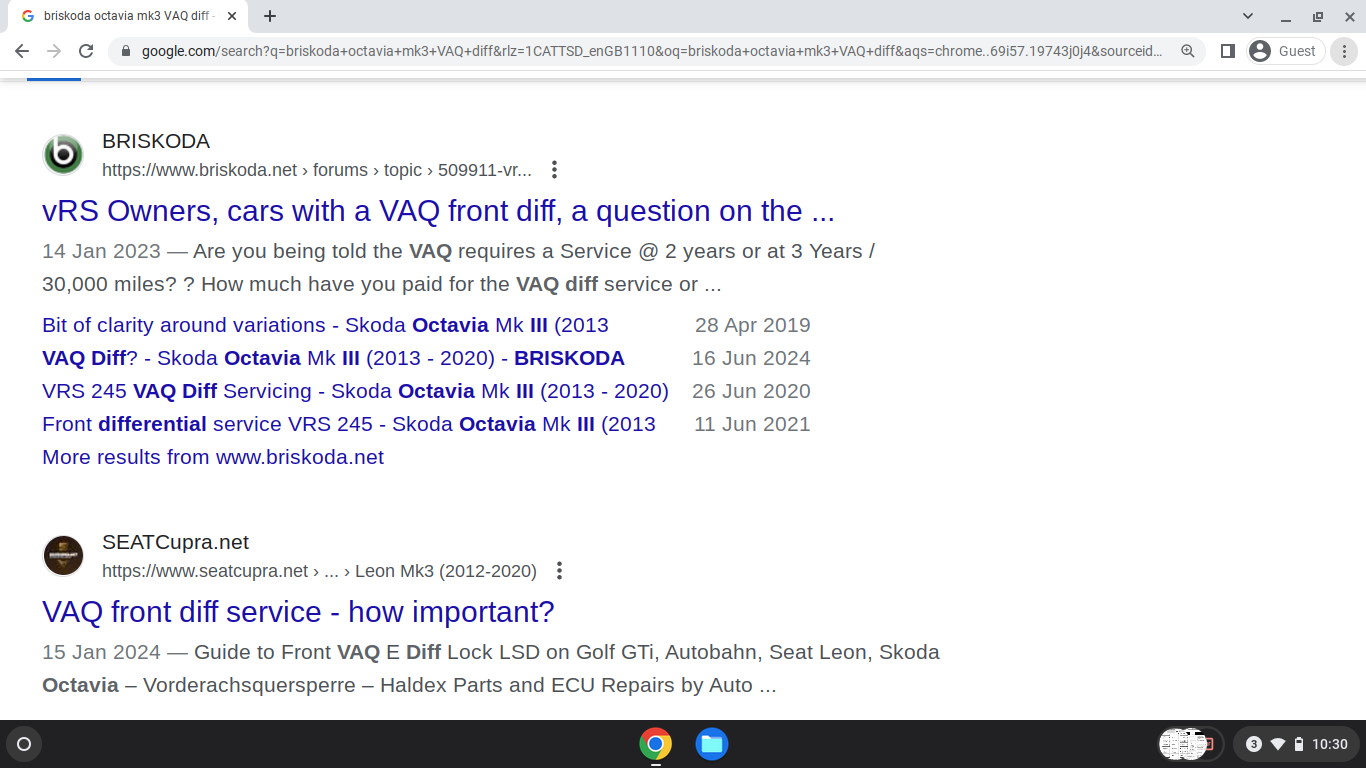

As for whether 'final drive oil' means diff oil, I couldn't say for sure - maybe someone else can answer that? I do however have a screenshot from the service dept's system at the main dealer showing what they call it internally - which is what any normal person would also refer to it as ('Front differential lock oil') and it shows the service intervals and cost, which might be useful for you:
