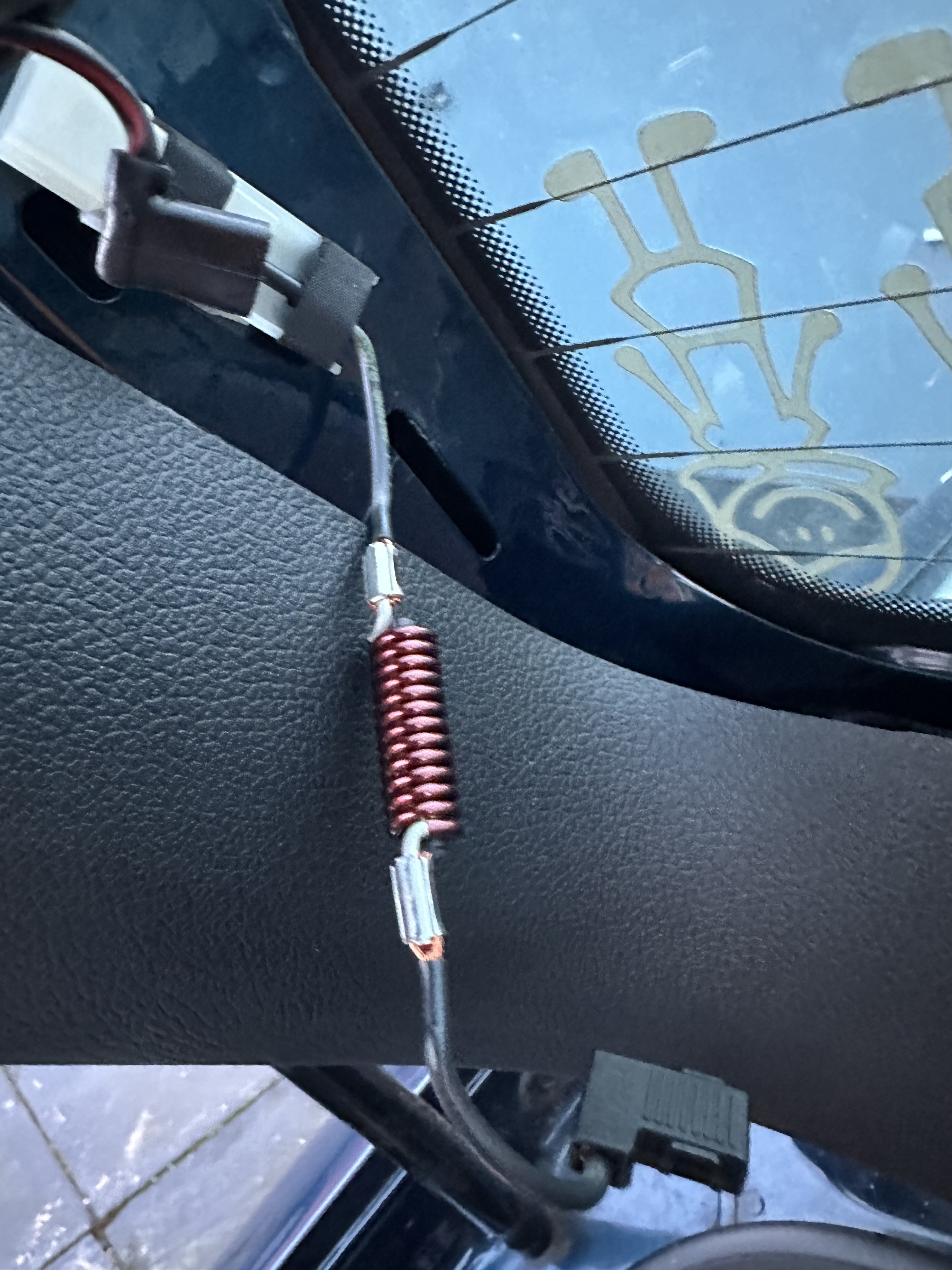

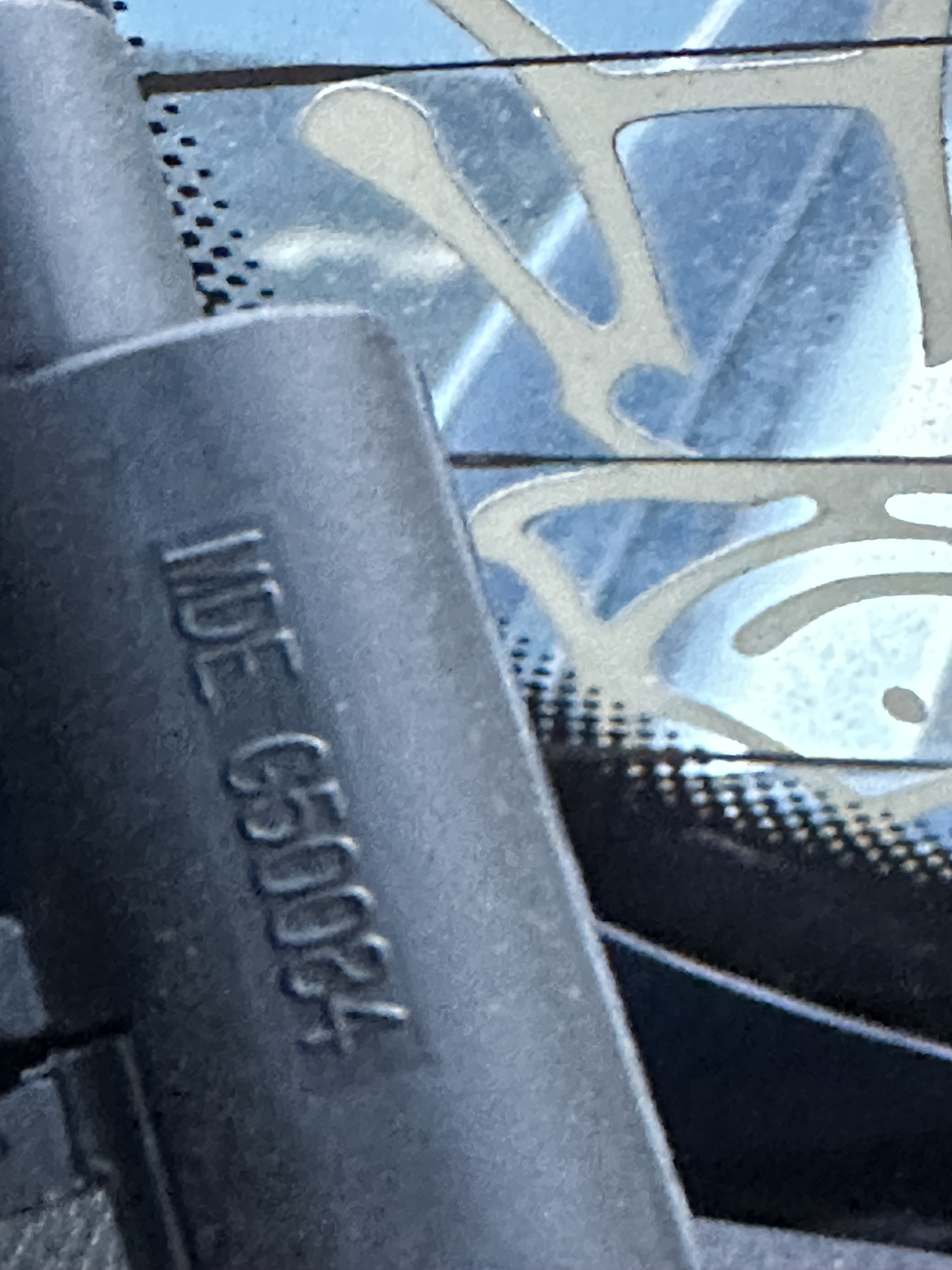

  1. Hi. I’ve problem with my dab aerial. It snapped cable in the boot lid. After finding price for new cable I bought dab aerial and followed by manual stick to the windscreen. Cleared error codes caused by factory aerial (dab aerial open circuit). Connected new aerial to the radio. I’ve no reception and on dab. On service mode it shows dab antenna off? Any advice? Does heated windscreen can completely wipe off the reception? Thanks.
  2. Any advice how to mend dab aerial cable?

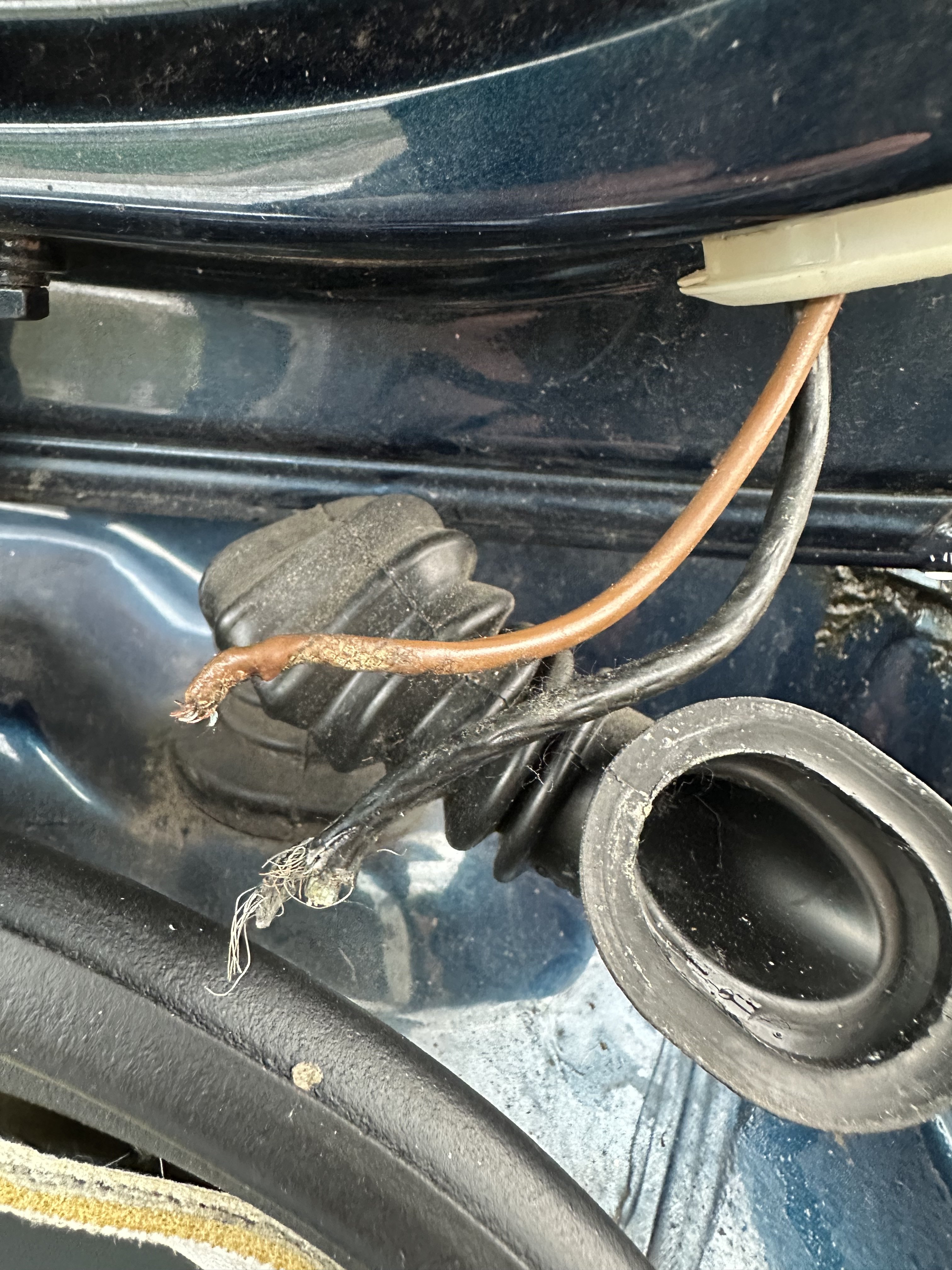

  3. Thanks for advice. I’ve checked everywhere and I found 2 cables snapped in right hand side rubber. 1 I think it’s missing neutral, but another one is dab aerial cable. Any idea how to join or replace the dab cable? I’m not sure if it’s soldered to the rear windscreen. This dab cable is in one piece straight to the radio?

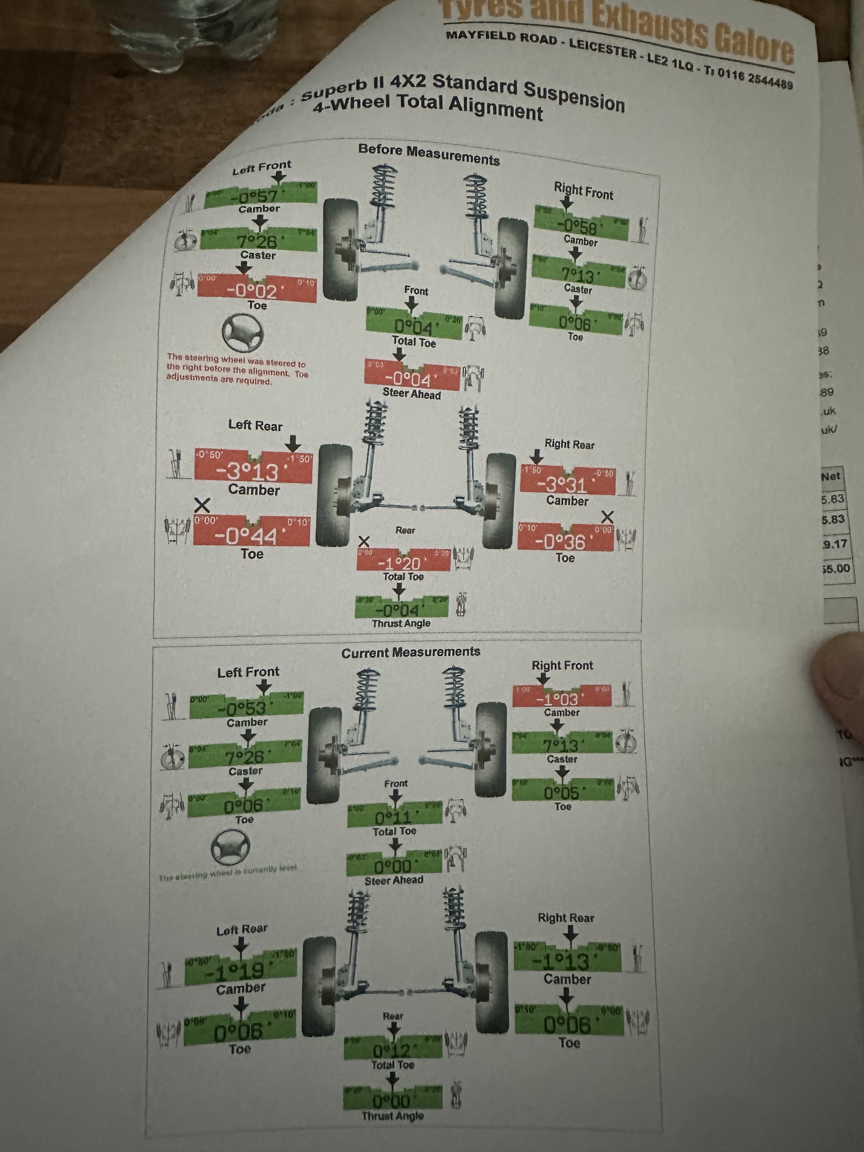

  6. Hi. Just replaced nearly whole rear suspension, just left springs. Went for the alignment, and guy adjusted it just front right camber stayed on red as he said there’s no adjustments. He also said to not to worry about. But it is in red and I still have it in my mind. Car is driving fine. Thanks for advice.
