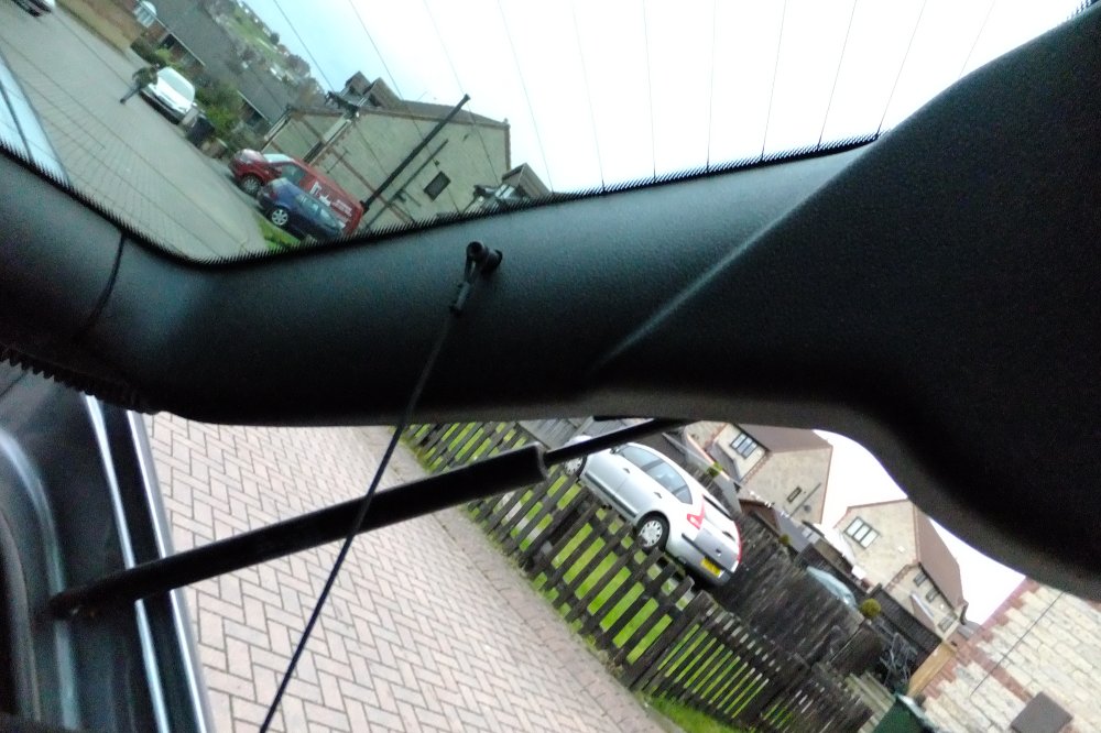

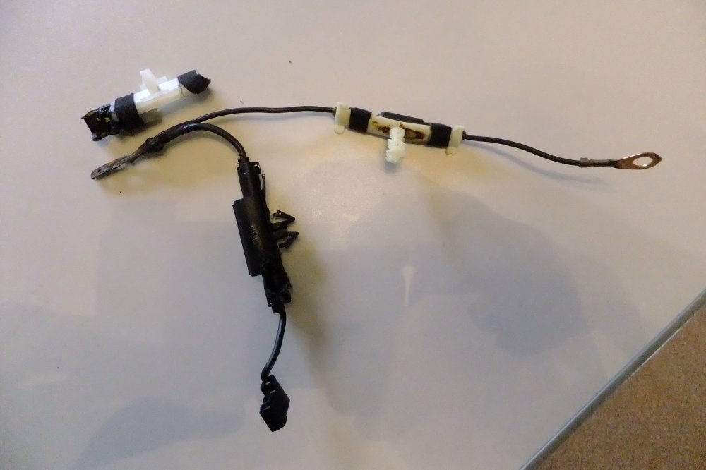

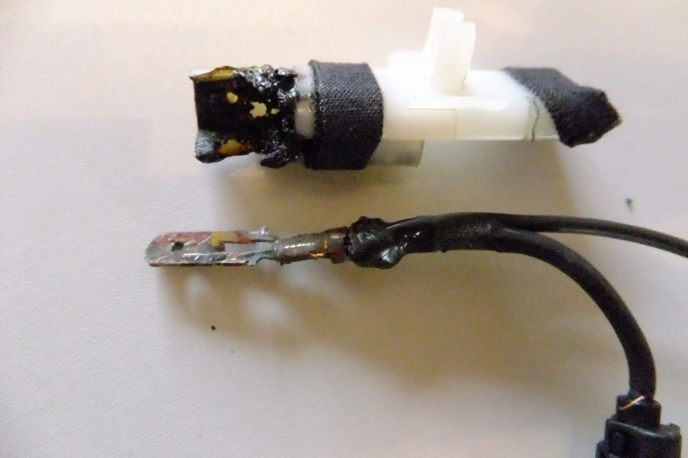

hi first time I've posted so don't know if I am doing it right but he goes my rear heated window as not worked since I got the car so I thought I would have a look today. I have found that what looks like a resistor has burnt out its situated behind the plastic cover on the side of the rear hatch I have not check the right side yet this was on the left side just wondered if any one else had come across this problem and wondered if there was any problem getting parts, ill try and attach some pictures ?
That looks very dodgy to me, a fire waiting to happen.

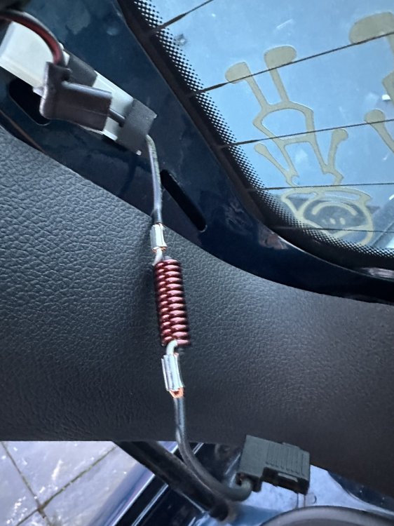

however I think I only did the right side which is similar to your pictures but there's a large copper coil inside a plastic cover and it was the connections to that part that was corroded.
the wire was still live when the switch was pressed no fuse was blown I thought I was going to find a broken cable was not expecting to find this. went to dealers and ordered two new parts one for each side although I have not checked the right side yet but I will replace both to be safe they cost £32 for both so not to bad, just got to wait for them as one is on back order.

hi the part is a adapter cable loom condenser,[ that's what the parts manual says?]  part number 3t005570 and 3t005570b one is for right side one for left side they are located behind the plastic trim on either side of the rear window located near the peg that holds the parcel shelf . The part i replaced was burnt out and was not allowing any power though it the right side looks slightly different but was ok on mine

Hi. I’ve the same problem. I’ve checked everything. Fuses, relay, all wiring. I’ve checked power on the rear windscreen On both sides I’ve power on connectors, but heating still not working. I’ve checked for error codes, but it doesn’t show anything. Did you found solution for it?
Thanks for help.
Resistance is 0.1 ohm.
With the connector leads disconnected on both sides of the window, test the heater element for continuity resistance - you may need assistant to hold test probe on one side while you probe the other, unless your probes have crocodile-clips.
You should read continuity with some resistance in the heater element.

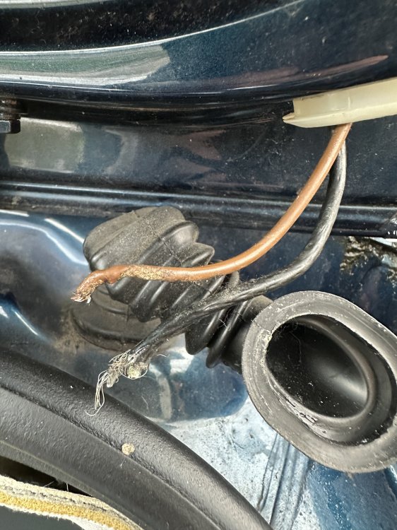

Thanks for advice. I’ve checked everywhere and I found 2 cables snapped in right hand side rubber. 1 I think it’s missing neutral, but another one is dab aerial cable. Any idea how to join or replace the dab cable? I’m not sure if it’s soldered to the rear windscreen. This dab cable is in one piece straight to the radio?
Any advice how to mend dab aerial cable?
