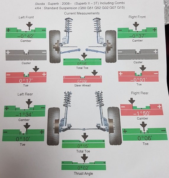

Seeking some advice on toe and camber settings following a 4 wheel alignment done this morning....
After getting a full set of new tyres I booked in for a 4 wheel alignment locally.
The rear passenger side tyre was badly worn on the inside so things were clearly out of adjustment, seems to be a common Superb Estate issue....

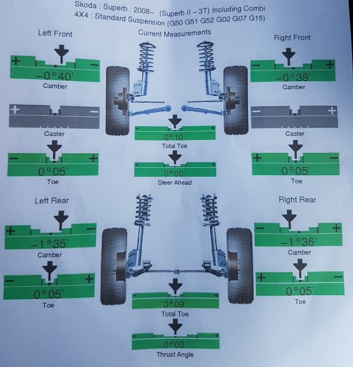

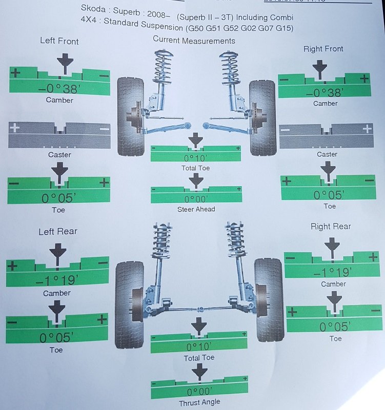

The garage was using a Hunter system and gave before and after prints as attached.  Anyway, I am not convinced on the new settings and questioned these at the time, but was told 'its a 4 wheel alignment and we only ever adjust the toe, and not the camber as its not adjustable...?!'  I got a second opinion elsewhere (Kwik Fit of all places....) and was advised everything should be 'green' suggesting camber is adustable.  I questioned the original garage again but was pretty much told they only advertise 'alignment' and not camber....  Am I wrong to expect the camber to be part of the deal on a 4 wheel alignment ?
Left Front and Rear camber appear out of tolerance, and worse than before alignment...should I be getting this re-done ....?
Thanks
Before
After
