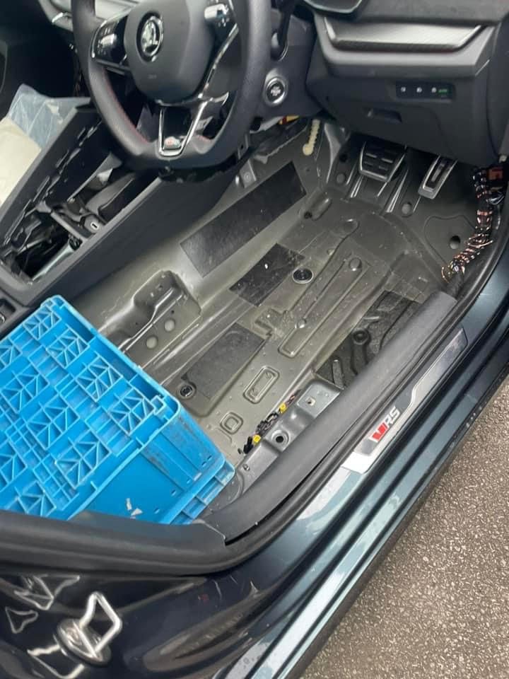

  6. I had a bad experience with Water ingress on Drivers [ RHS ] Footwell and behind. Removing the small carpet revealed 'lots' of water under there. Took to the dealer "We can't find anything" - Over a week latr they found a faulty Firewall Grommet behind the Console After 5 weeks of stuck at the Dealers doing nothing, they finally got the right grommet, & replaced the carpets under warranty luckily. Nightmare
  7. I had a bad experience with Water ingress on Drivers [ RHS ] Footwell and behind. Removing the small carpet revealed 'lots' of water under there. Took to the dealer "We can't find anything" - Over a week latr they found a faulty Firewall Grommet behind the Console After 5 weeks of stuck at the Dealers doing nothing, they finally got the right grommet, & replaced the carpets under warranty luckily. Nightmare
