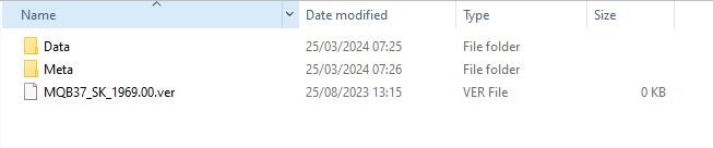

The wisdom seems to be to avoid downloading to an Apple Mac due to the way that the OSX operating system creates invisible files which makes sense.  I downloaded to a Windows PC and unpacked the downloaded Rar file using the free application 7Zip:
https://www.7-zip.org/
Format your media to ExFat and copy the unpacked files (should be two folders and a file) and look something like this.
Finally, if you are not confident in doing the manual update yourself then I would just wait for the OTA update to make its way to you.  It's not like there is any new functionality so the "If it Ain't Broken...." adage is appropriate.  I have read that those using Android Auto have had issues with version 1941 so possibly this update fixes these but as I am an Apple person I can't comment so will leave that to Android users to report back on.
