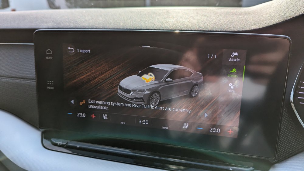

  6. @aaaaplay I have sent you a direct DM regarding this. I will send this pic to my dealer hopefully prompting them to finally update it. Was there anything else you had to do to get them to update it.

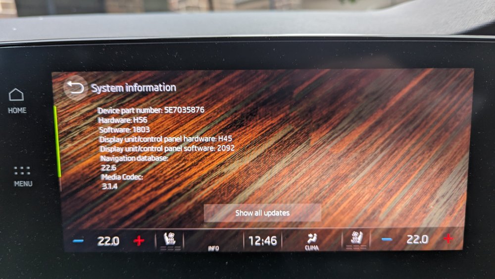

  8. Any one in Aus with a 2021 model that got skoda to do the upgrade to a newer firmware? My dealer hear confirmed i have the 0341 firmware but could not do any update as their was nothing on their system showing as updates are available.
  9. Went for the safety recall and other issues mentioned in my earlier post. The finally did some updates: 1. MIB from 1803 to 1941 (not 1969 😞 ) but still a lot better than i was. I will leave it on this for a few weeks before jumping to 1969 if possible 2. Audio Controller to 4019 - should fix my canton no Audio and pop issue. Plus the safety recall stuff. They did not fix the AC SYNC issue πŸ˜• said it is normal for the 2021 build cars... 2024 car they had for service did not have any issue. but as their system did not show as an update available they did not do anything.
  10. I called my service center and they want to book a diagnostic, and if they cant reproduce it they cant do any update as Skoda Australia will not pay for it. Is the AuSkoda group the one on FB?
  11. Thanks for the very detailed response. Looks like I will need to have an argument with them:/ 1. I do have the canton system 2. I do notice the AC sync control issue I though it was standard and so annoying good to know there is a fix. I am calling them tomorrow to book the safety recall and going to try and get them to do these updates. From what I can gather I need to get the following done by them 1. Infotainment system update to 1941 or higher (random park system not working & faster overall system) 2. TPI update for the audio issue after the above software 3. Climate control module firmware update. (fix for sync issue) I have the limited edition that came to AUS. i may need to call a few dealers around if my one does not do it.

  13. Hi all. First time here. I am based in AUS. I have had a few issues with the software on the car but every time i ask the dealer to look for updates they just say that it has the latest and at most update the maps data. I have had issues which i assume can be fixed withe software. 1. android auto connection via wireless. sometimes just fails to connect. 2. I hear a loud pop sound played from all the speakers when approaching a locked car. This renders the audio function. ie no audio from any system, radio, android auto etc. It says assisted parking is not available. Also when reverse parking the sound does not work. and there is a orange triangle on the dash stating systems not available. 3. randomly no pop sound or anything but no error message but audio just does not work. I try to reboot the info system but no audio. I have to lock the car and wait for it fully power off no power in infotainment system or dash maybe 10 -15 min and then if i turn the car back on ti starts working again. This issue has been happening more frequently now. I have tried to look for OTA updates but i don’t now if that even works in AUS as nothing happens when i search for that even after connecting the car to Wi-Fi. I assume i cant do the software update myself as the version is super old? Anyone in AUS found a dealer that will do the updates ?
