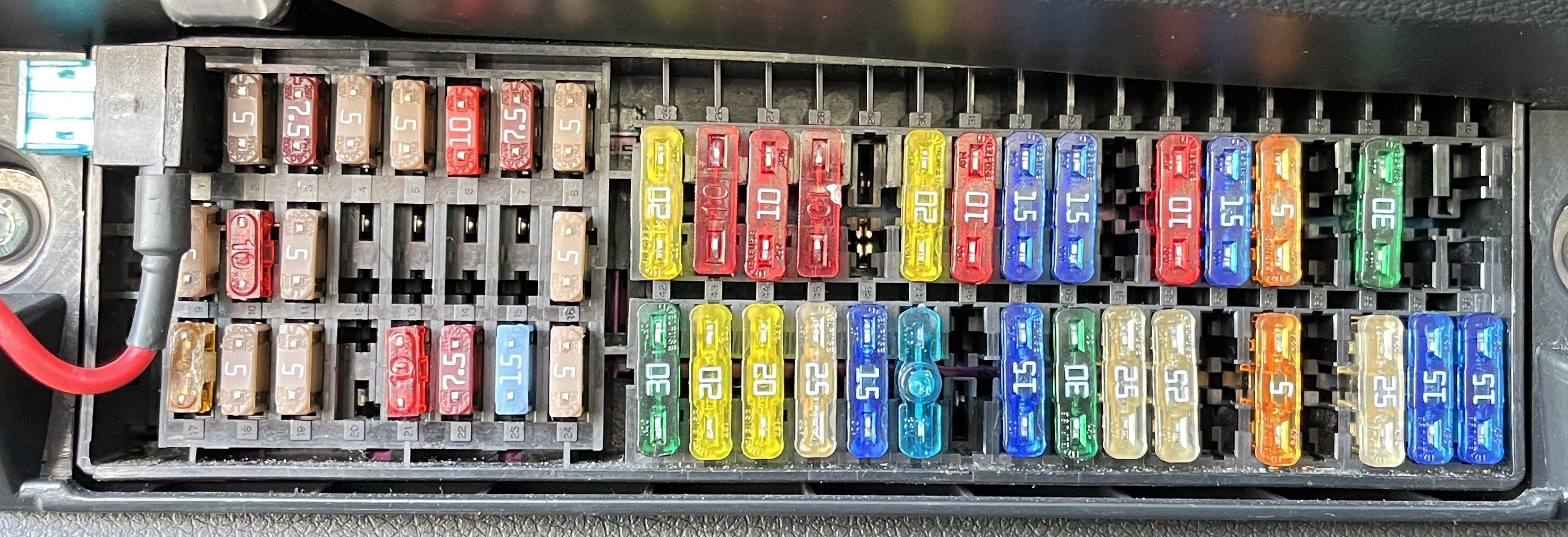

relay-J359 and relay -J360 Open circuit/short circuit to ground
well i'll be darn. did not notice. learn every day thank you i will come back to answer if the problem is fixed as soon as i find a mechanic to diagnose the car
yes you are right 33 is ok, counted wrong and it dont have contacts too :)) i will come back later this week me with a update for the diagnostic the mechanic did not have time today thank you @Breezy_Pete a legend can you recomend a cheap diagnostic tool, or solution so i can do it myself?
one more thing fuse 33 is missing to. before i go to the mechanic to check the errors again :))
yes not super hot but worm. hot air comes in max 10 minutes. having in mind i live in sweden is 6 celsius today. hot air is most of the time on for me.
i will add a 10a fuse there and see if that fixes the problem. i will have to go to the mechanic again because i dont have a diagnostic tool
what fuse is missing more? i see fuse 48 is missing too :)) yes
Funny thing is that the heating works. hot and cold is coming in. i will add a 10a fuse there and see what happens
