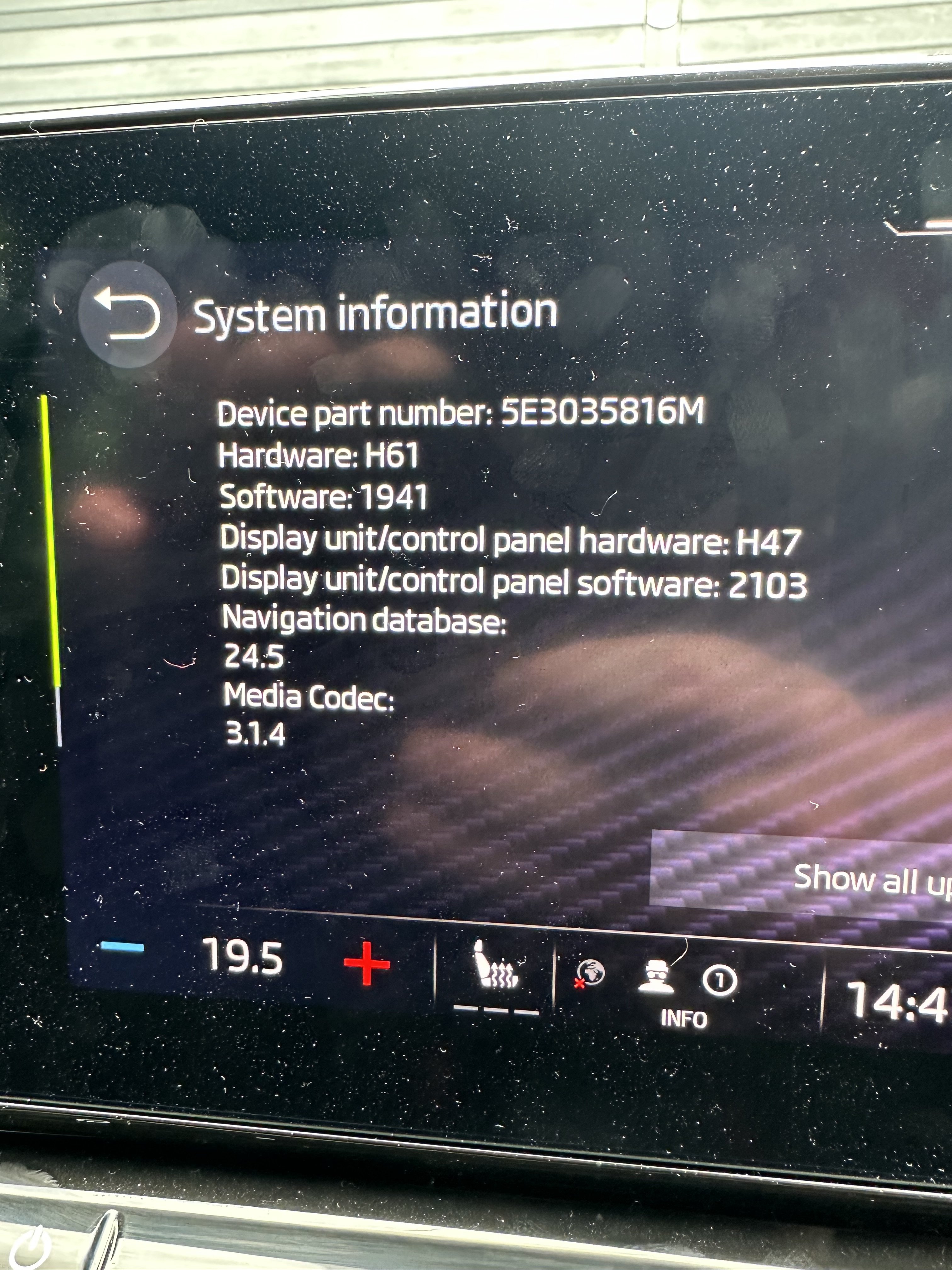

  7. Hi all, new here. Unfortunately I’ve seen this thread a day too late. 1941 installed a few weeks ago on my mk4 vRS and all was fine until Friday, when I had to reset the tyre pressure system after a low pressure warning. As soon as I did that, the infotainment screen started pop-popping and switching on and off, and taking the satnav on my digital dash down with it. Then I started getting PDC warnings over the weekend, and yesterday my screen stopped working completely, alongside new warnings about parking sensors and the SOS system not working. So I suspect I won’t be able to do this update myself as my screen seems to be dead. Can anyone reassure me that the problems stop with things linked to the infotainment system ? I’m slightly worried about the electronic handbrake suddenly not working, or the DSG being affected. This is my info, taken when the screen still worked.
