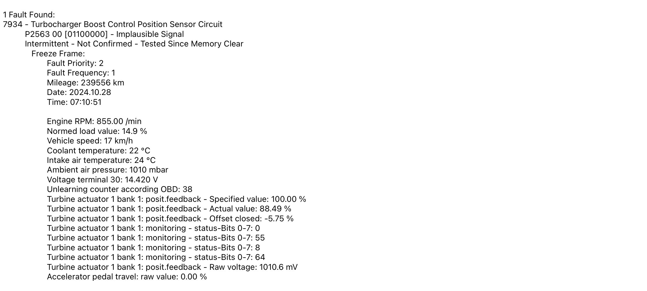

Please help: P2563 (VNT actuator was replaced - did not help)
Old post I know but did you sort yours out or find what pipe the earlier poster mentioned? Thanks.

Thanks for the info, yesterday I bought a vacuum tester and activated the actuator several times (it keeps pressure ok) fault was still there but it was close to a regen it then done a regen which lasted a lot longer than normal and hopefully it’s done the trick. Is it worth putting an additive in the diesel?

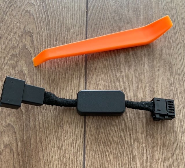

Stop Start disable
That’s the problem I had, the light was flashing all the time. So just removed it and sent the cable back, not worth the risk of using power up.

Thanks, yes checked connections several time, no worries I will use Vcds to sort it.

Hi just wondering if anyone has used one of these cables to permanently disable the start stop feature? I connected it but the start stop light flashes even when engine off and car locked? I vaguely remember someone saying similar in one of the forums but can’t find it. Thanks.

Thanks for the reply, I cleared the code and it hasn’t appeared again yet, but will try some additive and a good motorway run.

Thanks so appears I need a new turbo boost actuator? Anyone agree? If so would anyone have a part number and where it is located in the engine bay? It’s a 2013 1.6 tdi CLHA. Thanks again

Hi everyone first time I have received this code, any help would be much appreciated on a possible solution. Would a recent start stop disable adaptation via Vcds be the cause? I did have the flashing glow plug light but that went after a restart of the engine, then ran the VCDS diagnostic just now. Thanks in advance for any advice.

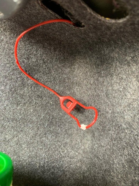

Stuck fuel door
Update, bought a new one with emergency pull cord from AliExpress. Easy job to do and works perfect.
