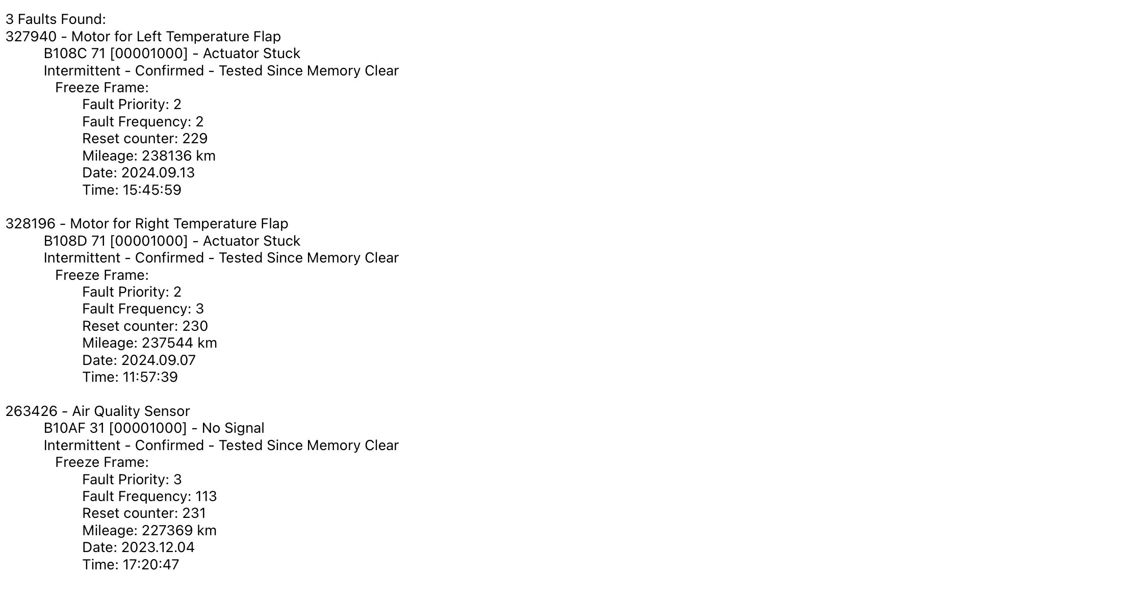

  1. Yes probably correct, I wasn’t even aware of anything till I done the scan 😂.
  2. Thanks I have tried that, not sure if it’s re calibrated anything. I think I will clear the fault codes and see what faults if any come back.
  3. Thanks for the info, I had my windscreen replaced a few days ago and I know they took the wipers and scuttle off but the date on the codes are last year so wouldn’t think Autoglass has broken anything.
  4. Hi everyone done a VCDS diagnostic and have some faults, see picture. Any ideas of rectifying ? Thanks

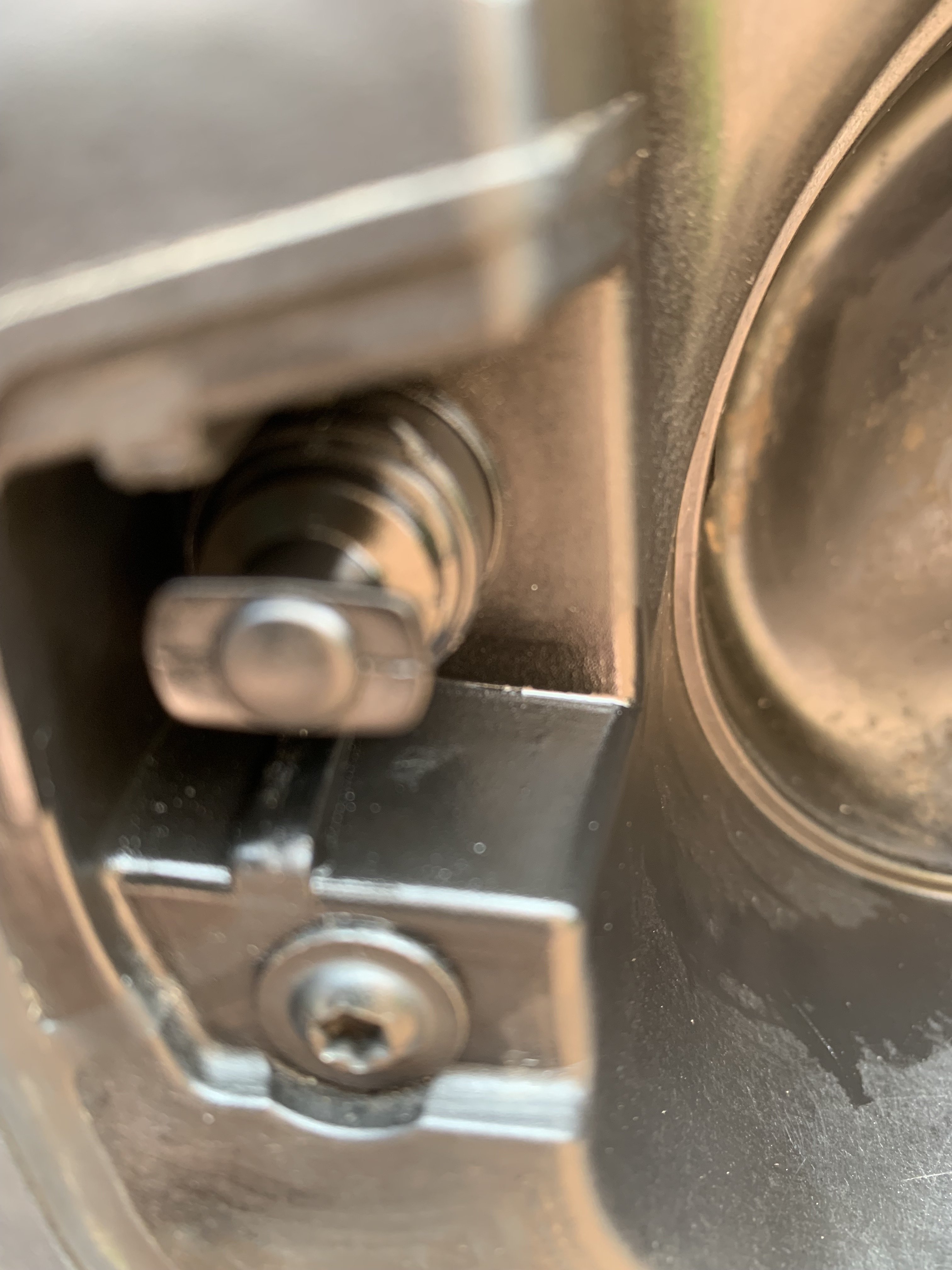

  16. Thanks for the reply, it does indeed rotate as you manually push it in. When I keep the flap open and manually push the stem in you can see it has rotated, then if I lock the car I hear a loud buzz but can’t see anything happen. If I then open the stem manually and push the flap closed and lock and unlock the car the flap gets stuck again.So must be the actuator knackered.
  17. Here is an update on my issue. I gave it a good wack whilst unlocking the car and it popped open, perfect. So I cleaned the stem of the actuator and it presses in and rotates really easily now, strangely though when I close flap and lock the car the flap can still be opened? How should it lock, is there like a shoot bolt somewhere?
  18. Thanks everyone, I have now realised how to search the forum! I see lots of info on here so will try some of the tips. Just hope it opens, then try some alteration and cleaning to help stop it happening. I may even cut a bit of the flap and just lose the locking feature. Just wondering how does the flap stay closed when the car is unlocked?
  19. Help required please, the fuel cap doesn’t open when I push it in a bit? The car is unlocked, does anyone know of a fix without damaging anything. Thanks

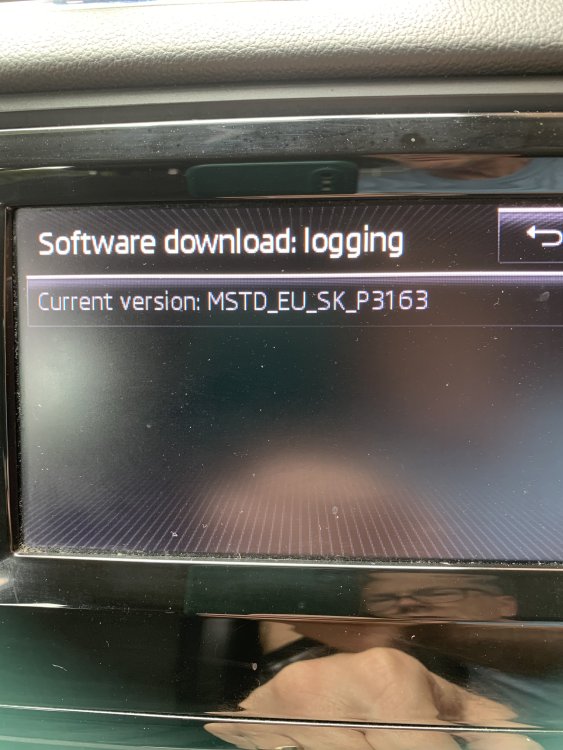

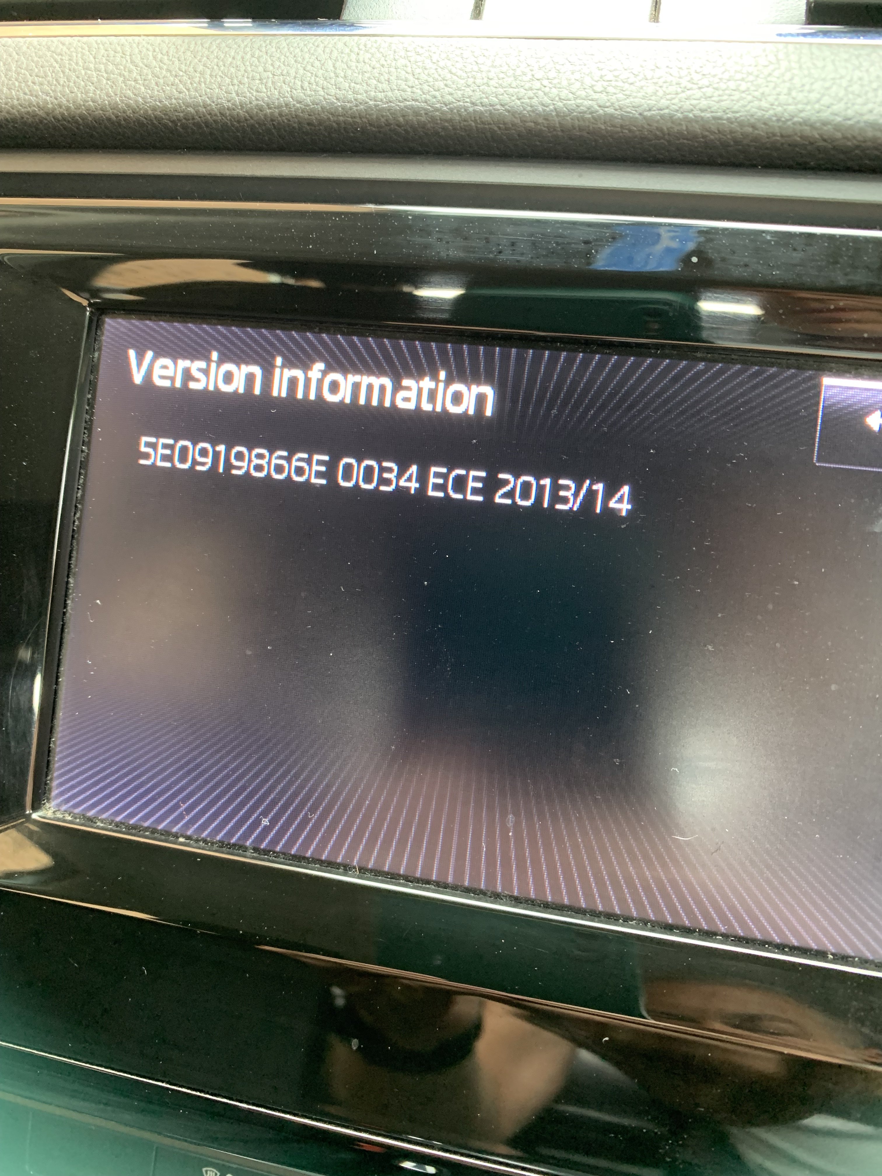

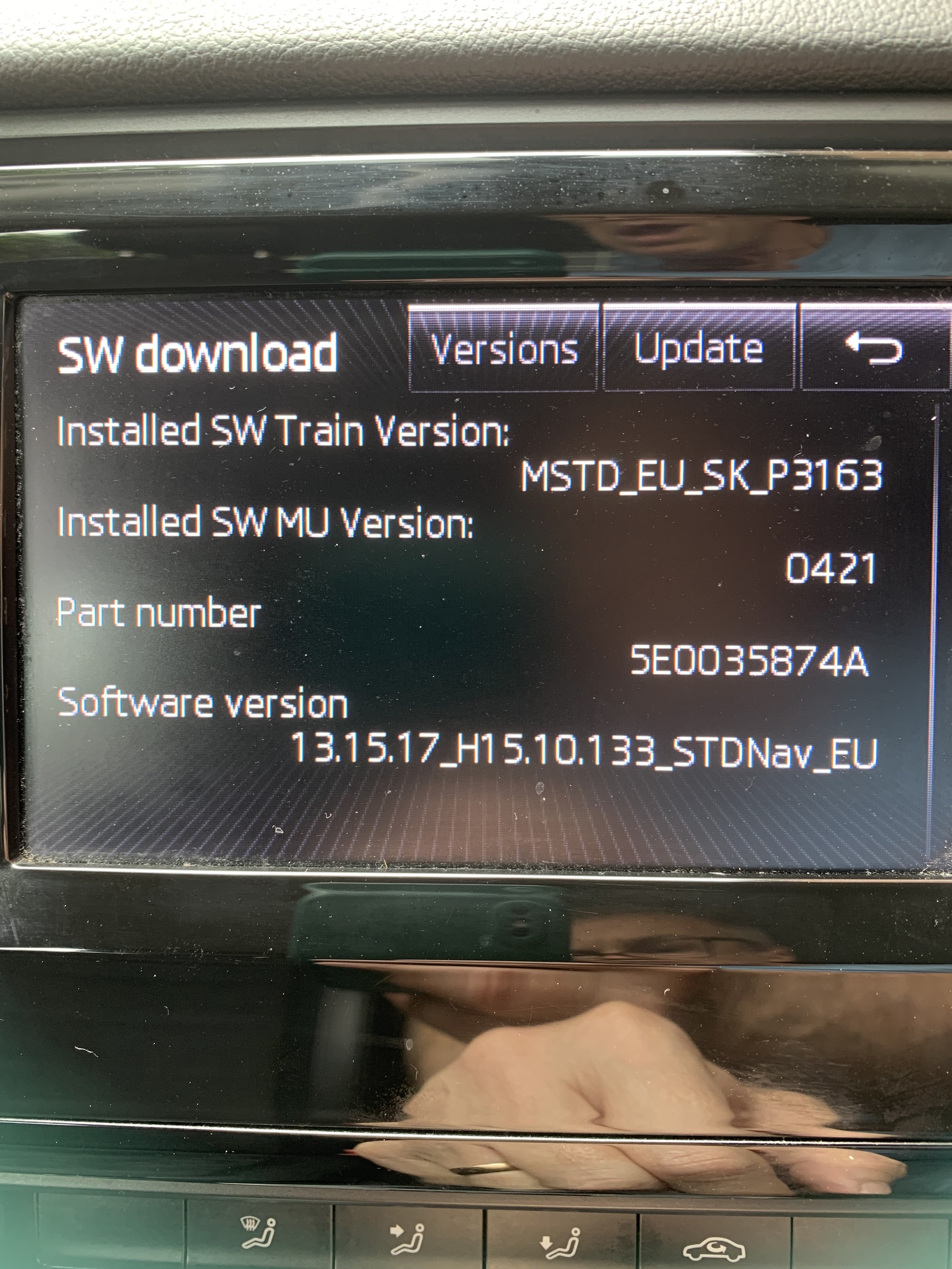

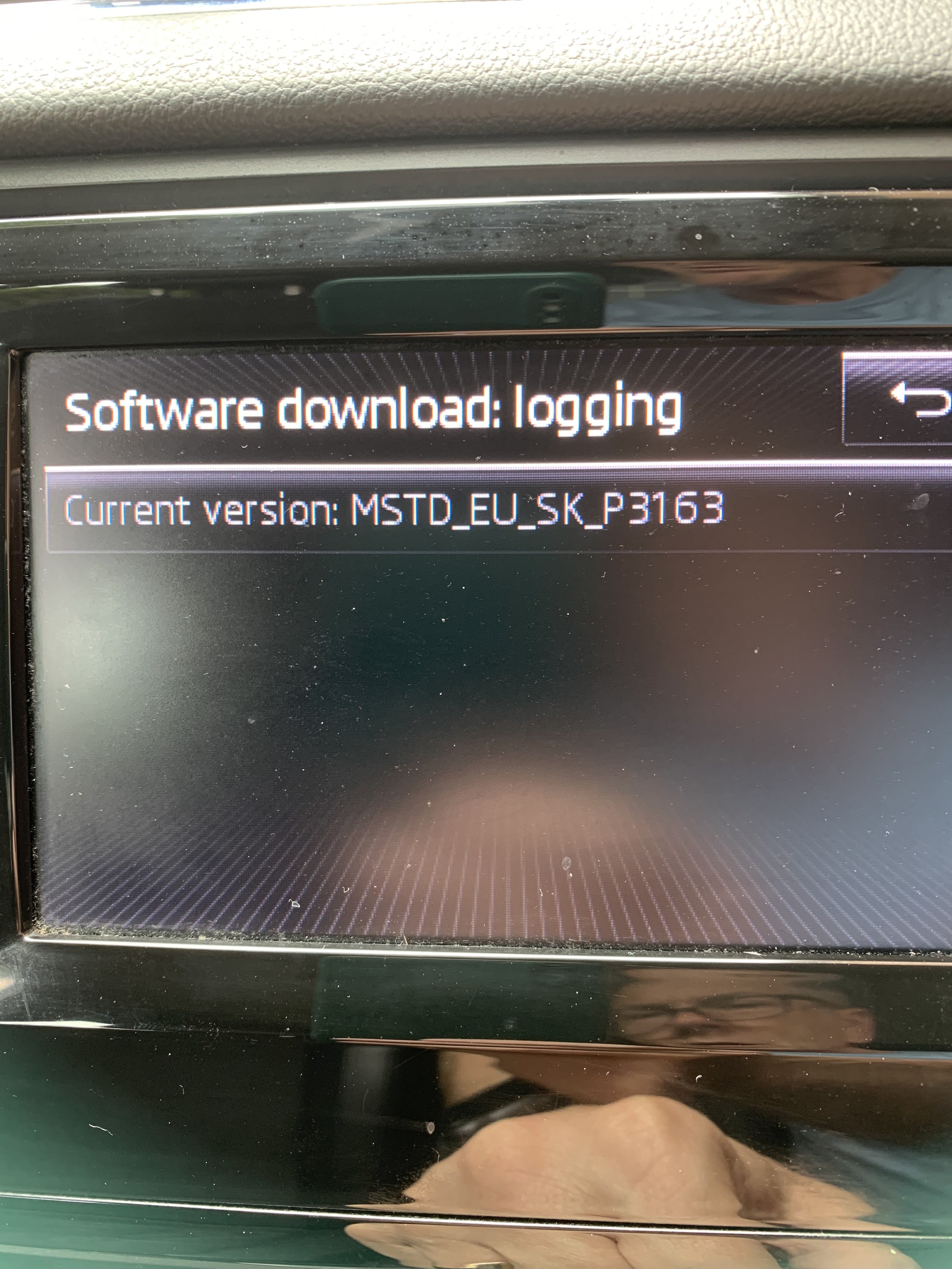

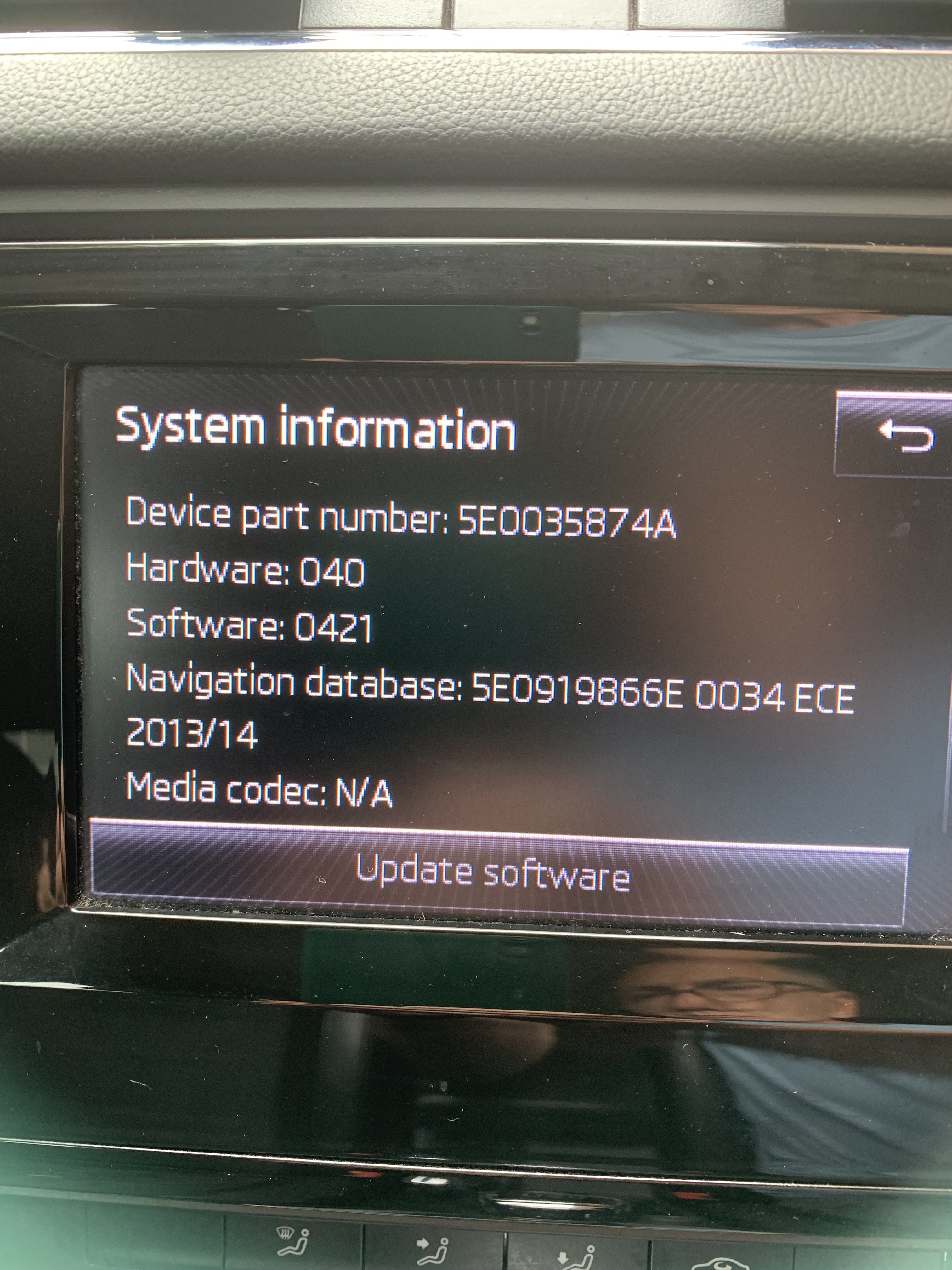

  20. Hi everyone, I know this is an old post so not sure if I will get any help. What can my head unit be upgraded to and where to download it also would it be beneficial to do the update? Many thanks
