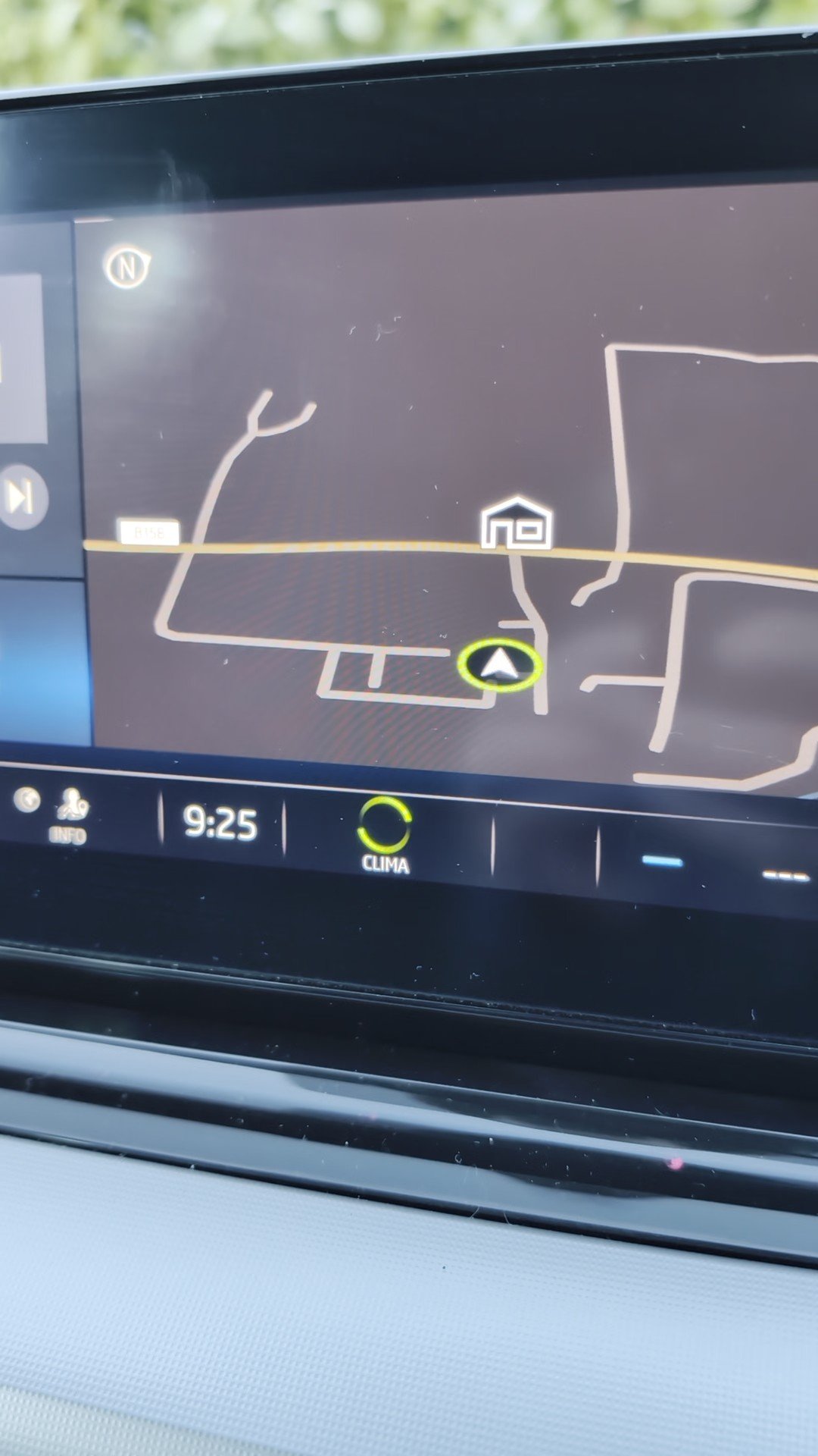

  12. What software version have you got? I've had these issues in the past, updating to 1941 then 1989 seems to have fixed most, but the car still finds new ways to annoy me.

  15. Hi. Has anyone experienced this? Lost ability to control driver's side climate and heated seat, and climate hard switch not responding. 1989 software that has been fine so far. Thanks.

  18. If you're prepared to do a factory reset, there's no reason not to install the update. I think it's slightly quicker and slicker than 1985 and mine has been perfect since the reset.

  22. Exactly, it's an old problem that was resolved around 1941 (version not year). Beyond belief that the fault has been reinstated by this update. Anyway, factory reset seems to have sorted it
  23. That's exactly what mines was doing following the update, factory reset seems to have cured everything.
