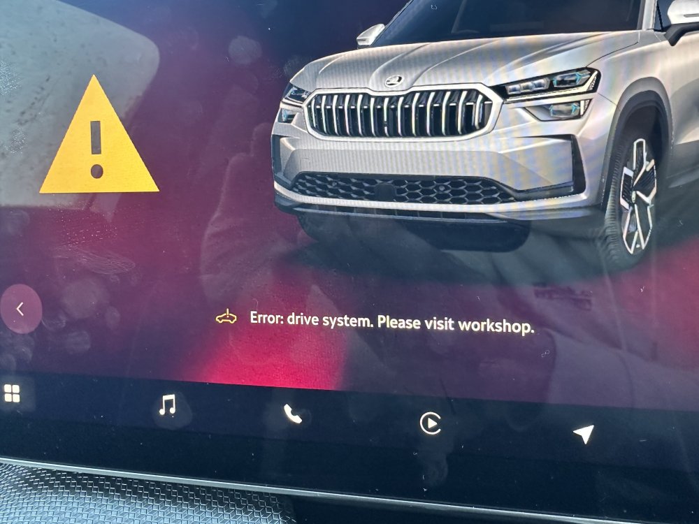

  9. Evening, has anyone had this error before? It’s on a 2 month old 2024 Kodiaq IV. It’s gone to petrol only mode with the electric motor refusing to start. Just had it taken to the local dealer by Skoda Recovery. The mechanic who came out said it was the second time he had seen this fault in two days.
  10. I have the same issue with 2024 Sportline. Dealer told me a few week ago it was a software update. Not heard anything since.
