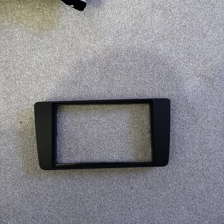

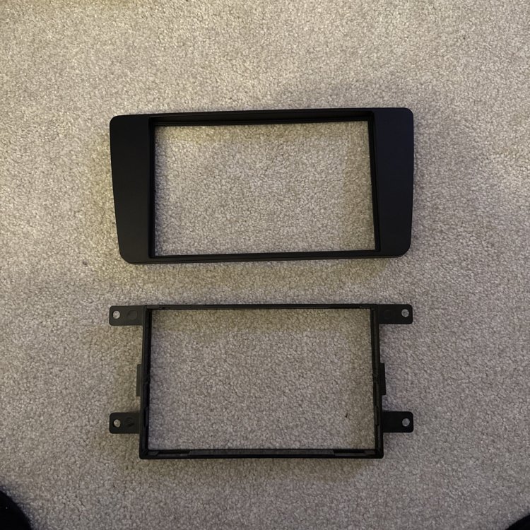

  11. Hi Dave, Would you be willing to sell the fascia separately? I need one and can't find one anywhere.
  12. MK2 Octavia double din adapter / fascia. This is a direct fit for the Škoda Bolero dash fascia. Made by connects2, never been used. I ended up sending the aftermarket headunit back. £12.50 delivered.

  14. You're right I completely forgot they were plain silver. The fascia I got for my Android headunit is brushed. In that case I will pass mate. Might be worth sticking them on ebay if you have an account. Somebody will have them.
  15. Have you still got these mate or have they gone?
