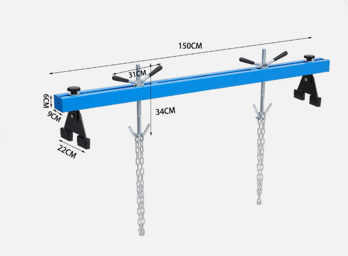

  11. This is the one I have, it's a Godsend when you need it, Β£59 Ebay purchase.
