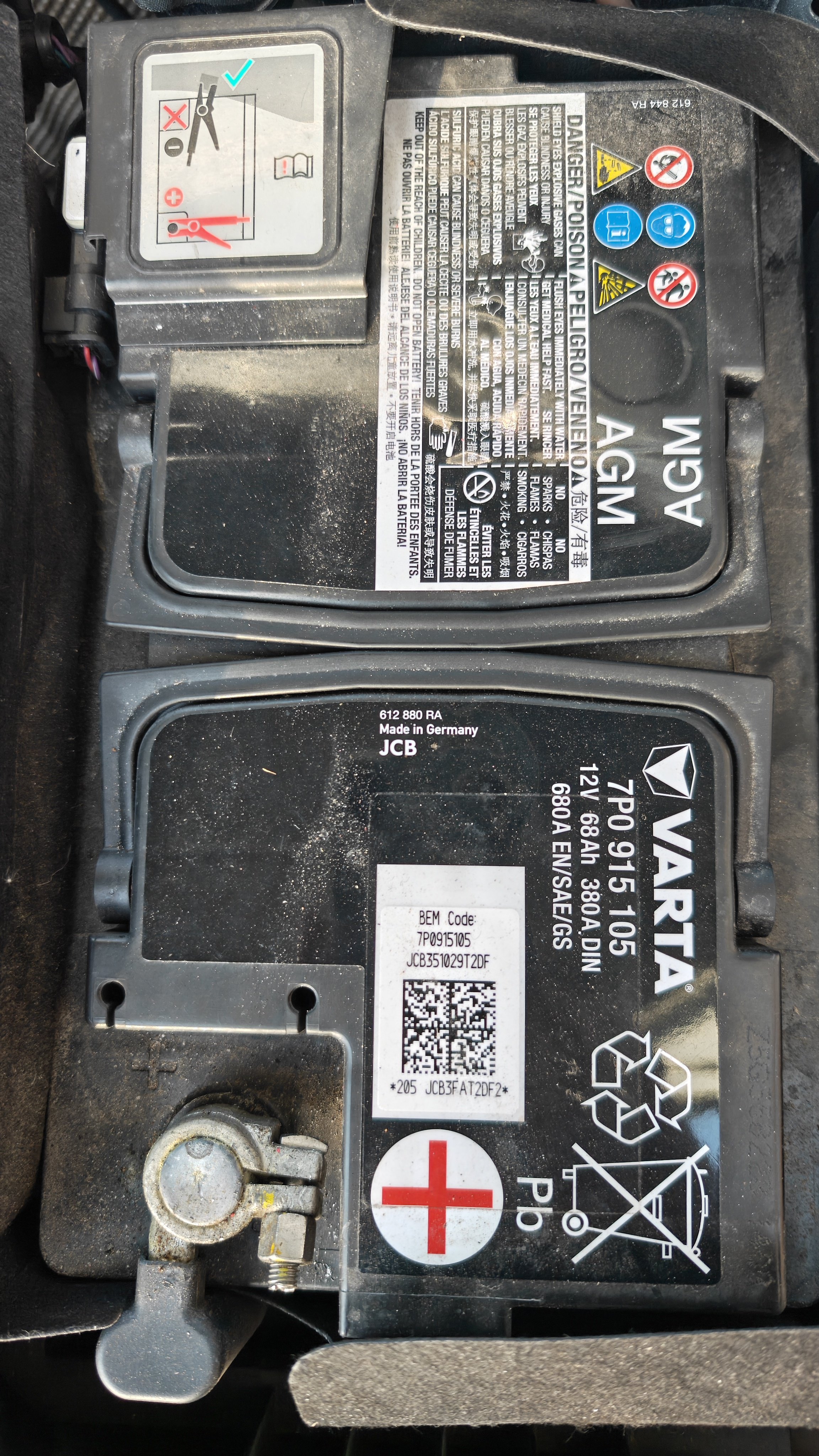

  1. Thanks for replies thus far! Unfortunately I have a concern regarding the replacement battery exact version. The "096" as recommended here also features with several vendors when I enter the registration number into their websites. However the fitted battery seems to be different, yet its manufacture date match the first registration of my Scout. Is the "096" an upgrade compared to the "7P0 915 105" currently fitted?
  2. I think my battery is close to failing. The start-stop system is permanently auto inhibited and the cranking sounds laboured. Resting voltage is 12.05 and 15.03 with engine running. Existing battery is a Varta AGM and deciphering the datecode would imply it is the original, having a manufacture date of October 2015. Nearest independent Skoda specialist has quoted £250 for Yuasa or £330 for Skoda original, (which I assume is a Varta) including coding. Does this all sound reasonable to experts in this forum? I think my battery is close to failing. The start-stop system is permanently auto inhibited and the cranking sounds laboured. Resting voltage is 12.05 and 15.03 with engine running. Existing battery is a Varta AGM and deciphering the datecode would imply it is the original, having a manufacture date of October 2015. Nearest independent Skoda specialist has quoted £250 for Yuasa or £330 for Skoda original, (which I assume is a Varta) including coding. Does this all sound reasonable to experts in this forum?
