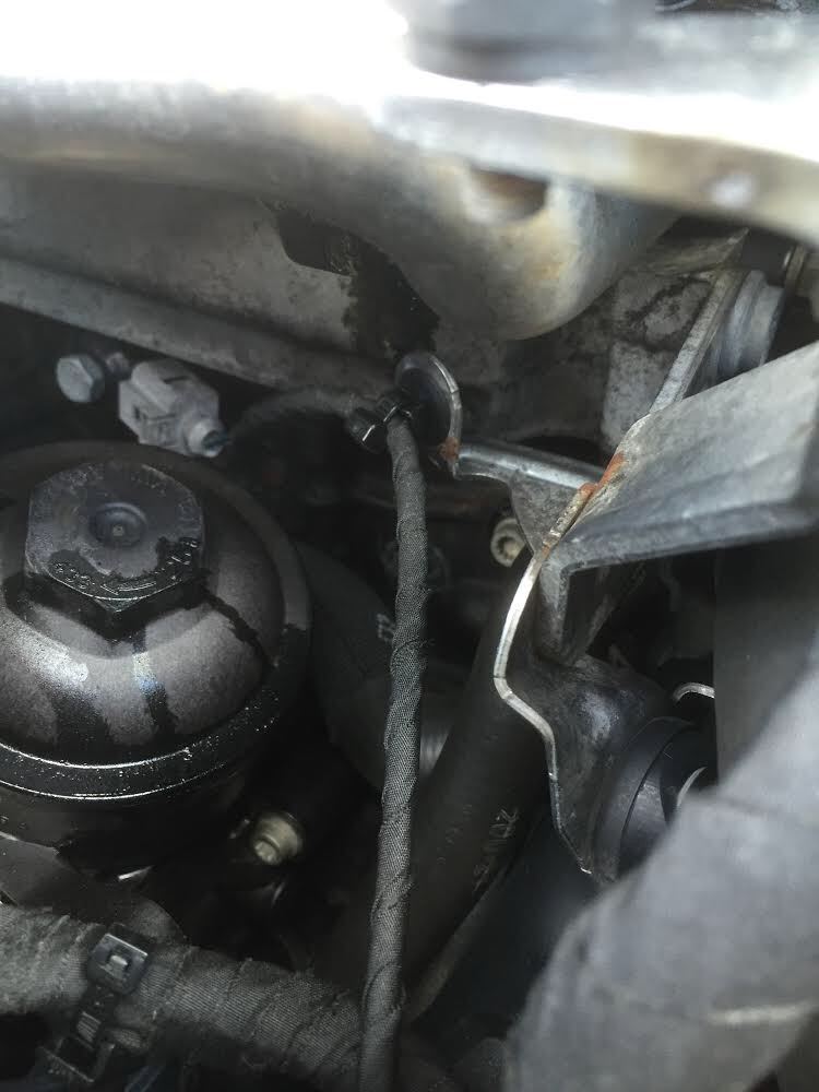

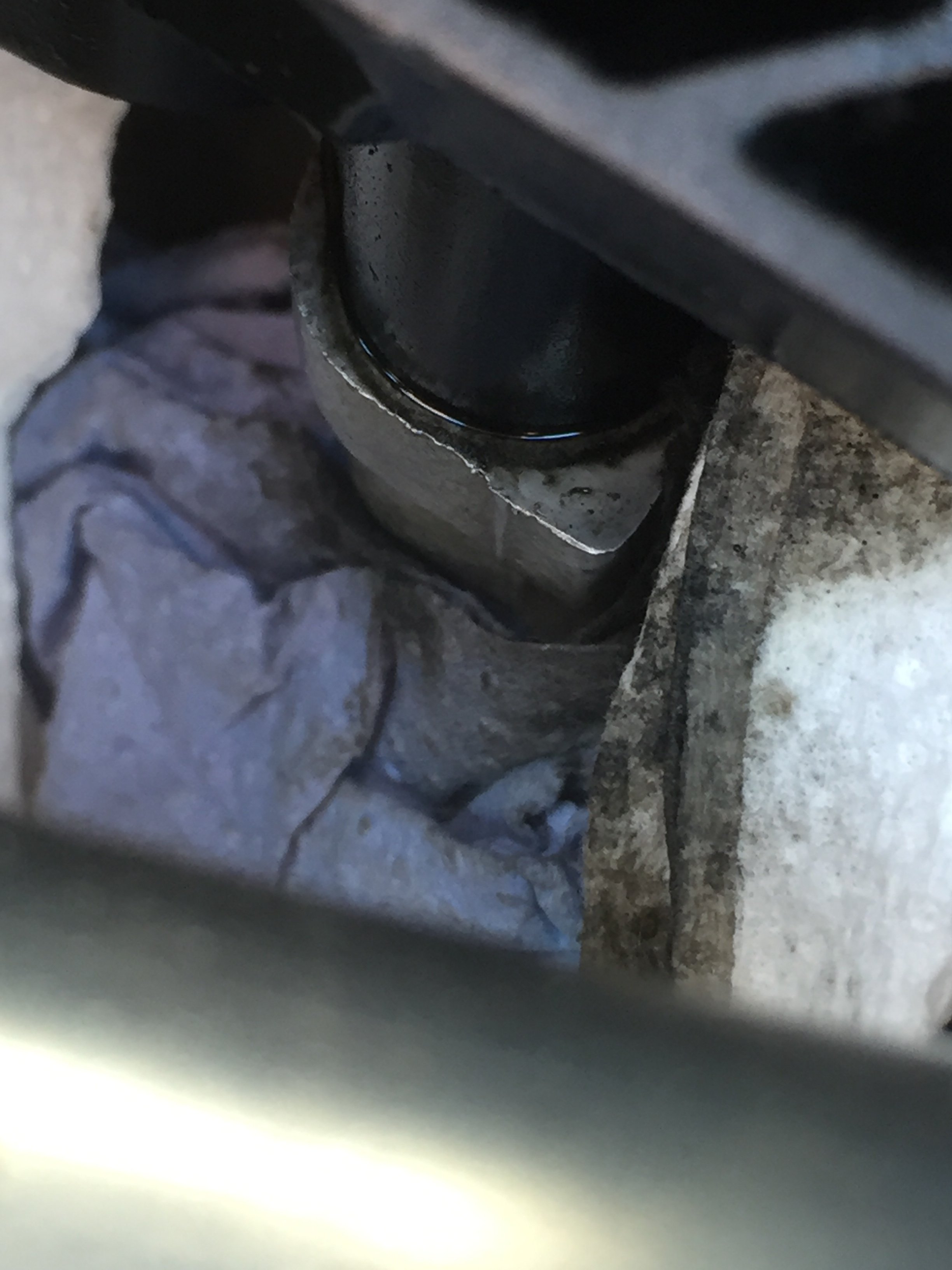

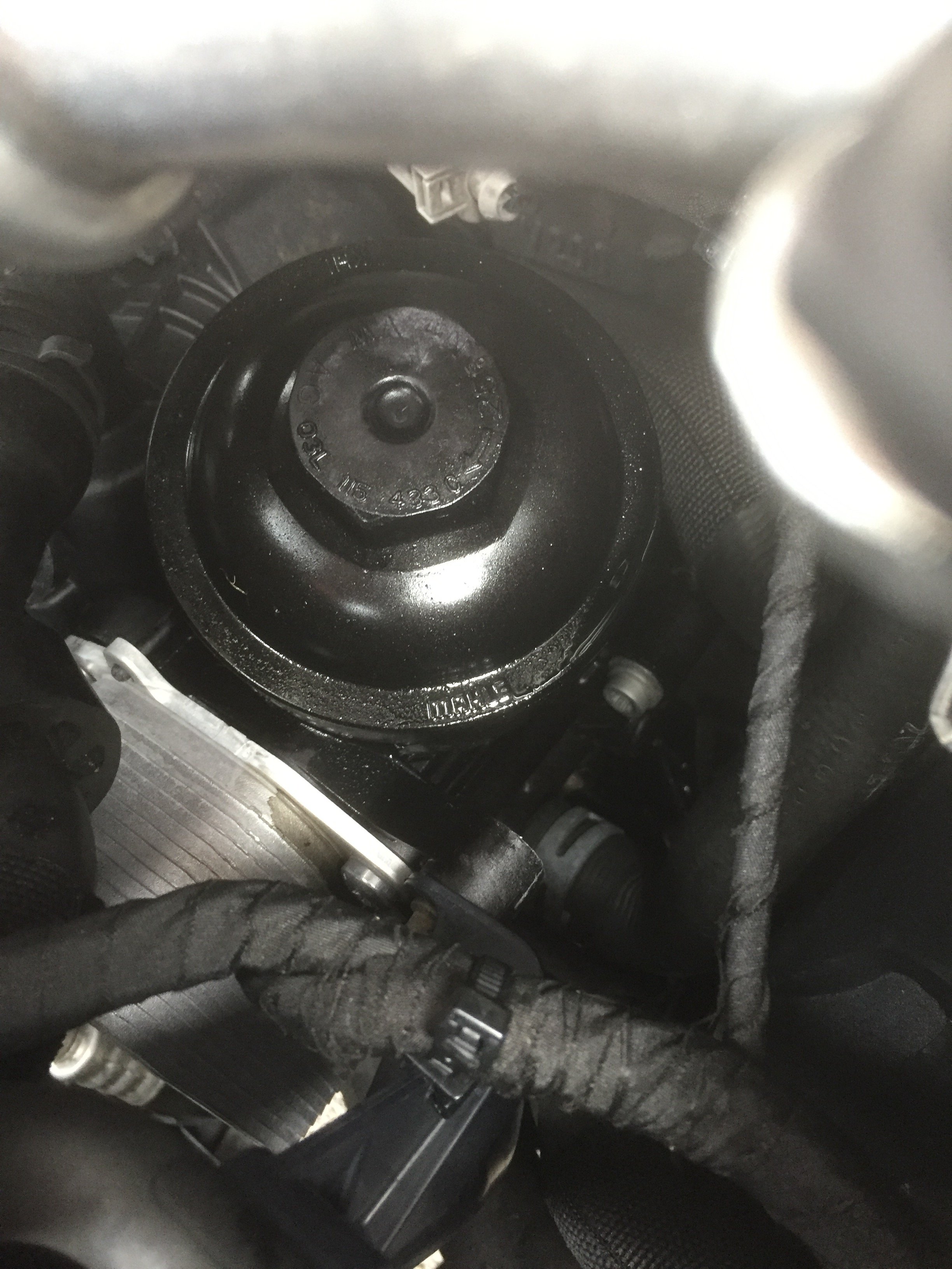

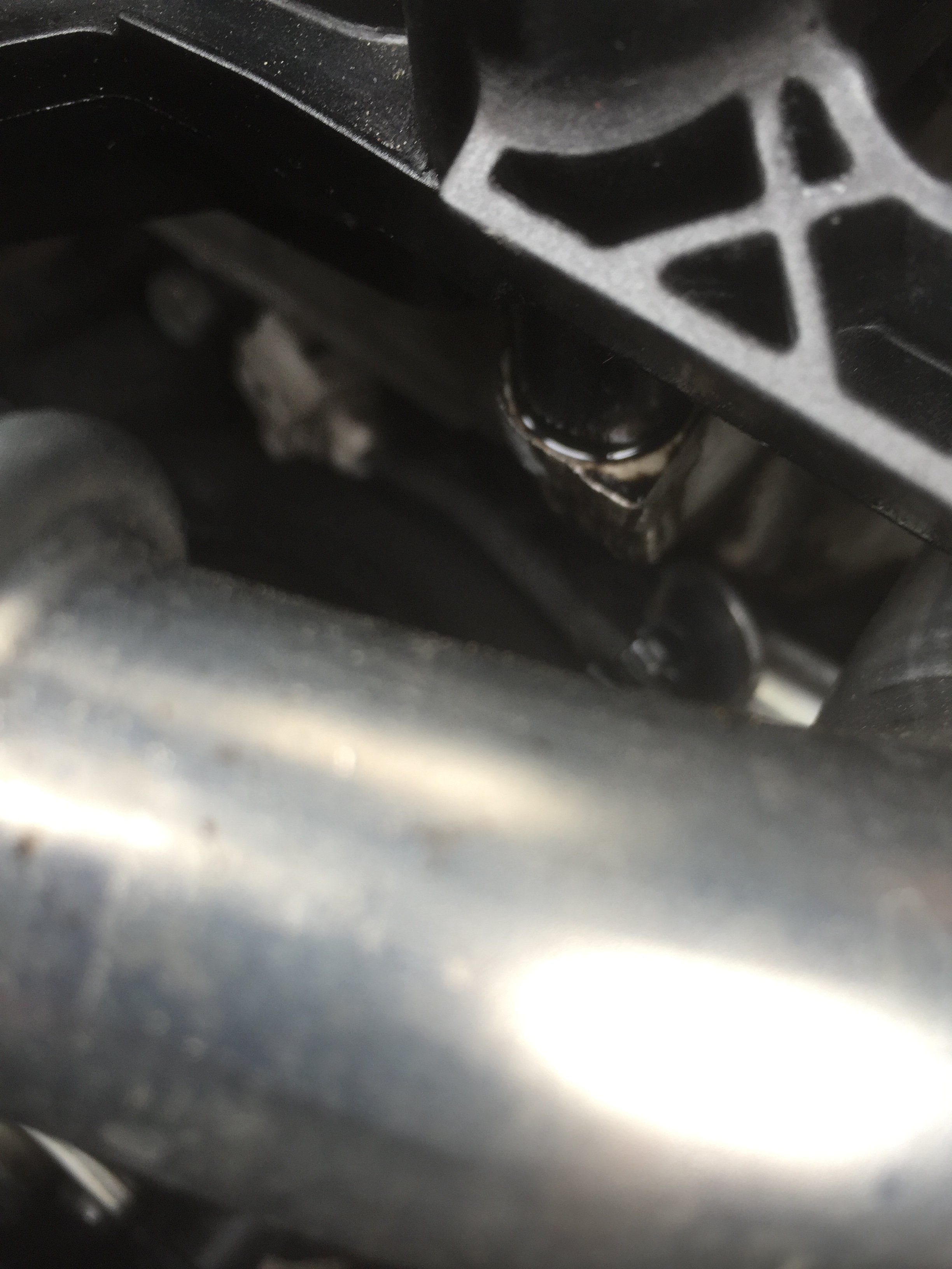

As requested some pictures of the weep. I believe it occurs more so when boost is demanded. For example hill climbs. The oil runs underneath the inlet assembly and drops onto the oil filter housing. Apparently these engines are a bit dirty internally and there will be oil residue in the intake side but the garage tells me the turbo could be letting more through. Thanks again.

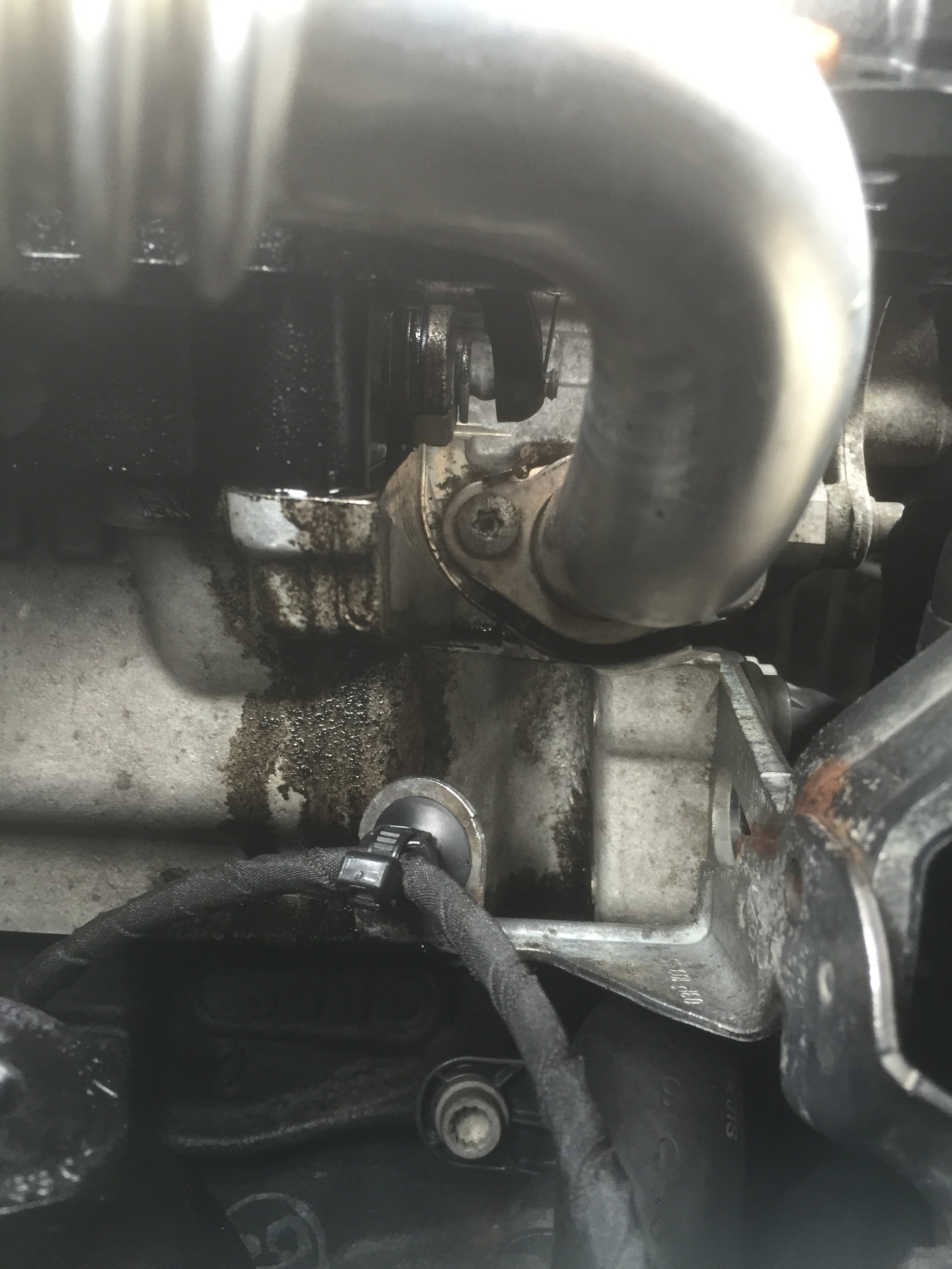

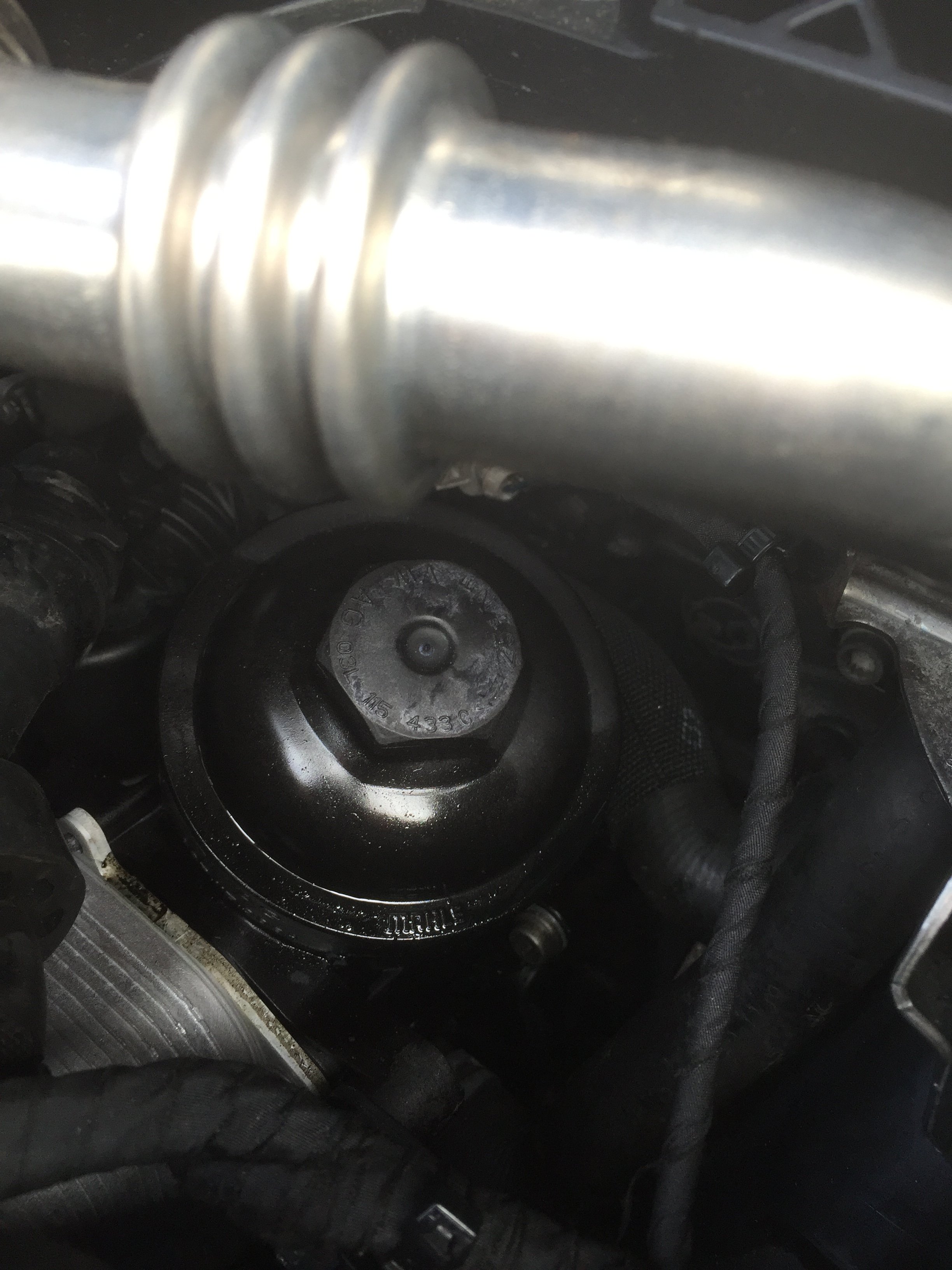

I'm having the same issue on a 1.2 TDi Polo 2013. Same engine I'd presume, CFWA.

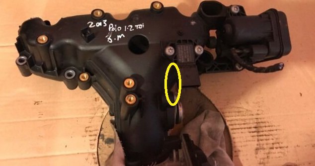

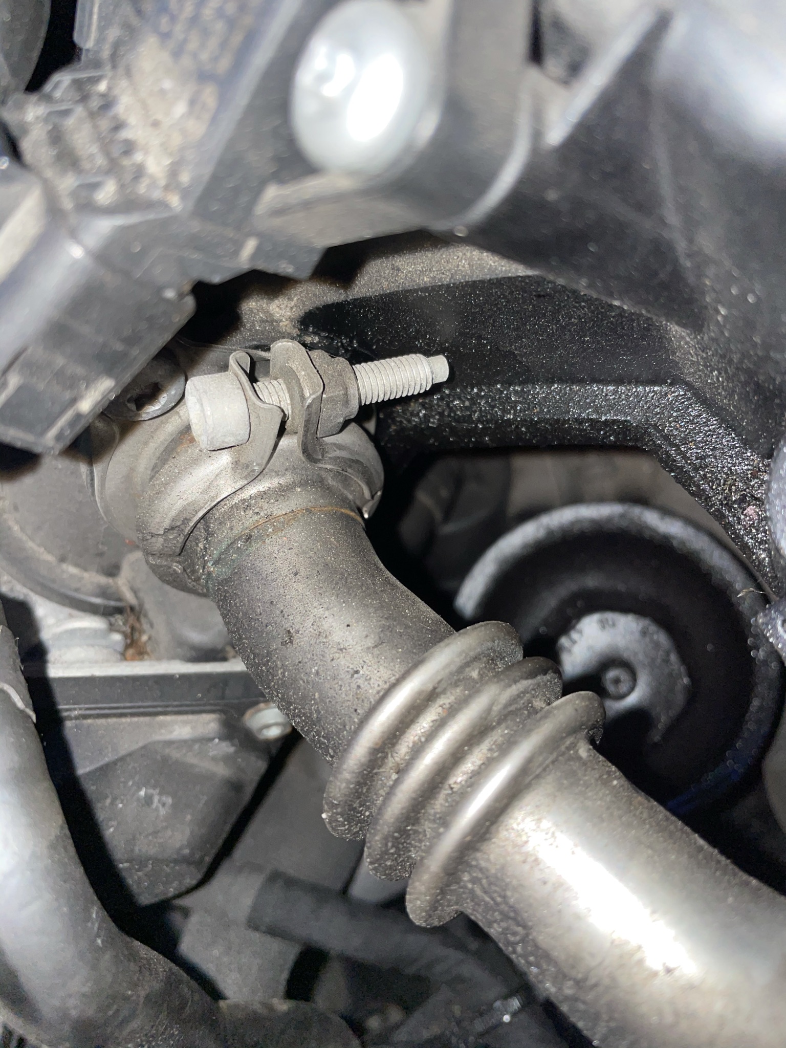

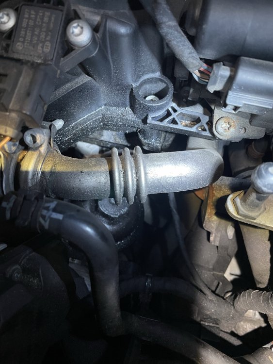

It seems like it's wet wround the "snout" where the "throttle body" sits. Maybe a bit more on the EGR pipe side. My main suspect is the gasket behind the pipe/coupling for the EGR pipe. Right now I suspect either the "throttle body" gasket or the EGR coupling gasket.
Photos for reference.
Same thing - wet on the edge of the manifold and on the top of the oil filter housing. But seems like it's more "recently wet" just around the EGR coupling pipe.
