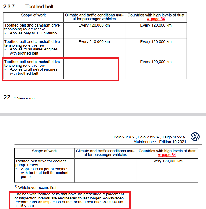

Hello, I am trying to find information about what km interval the timing belt of a DKRF engine needs to be changed. This engine is fitted into my Seat Ibiza 2019 1.0 ecoTSI and i found some information that also the Octavia mk3 has this engine. If i am correct then this engine belongs to the ea211 family and i found one reference here in BRISKODA that the timing belt lasts 240 000km and after that inspection is needed every 30 000 km. Currently i have driven 107 000km with my Seat. Does anybody have some more info? BR

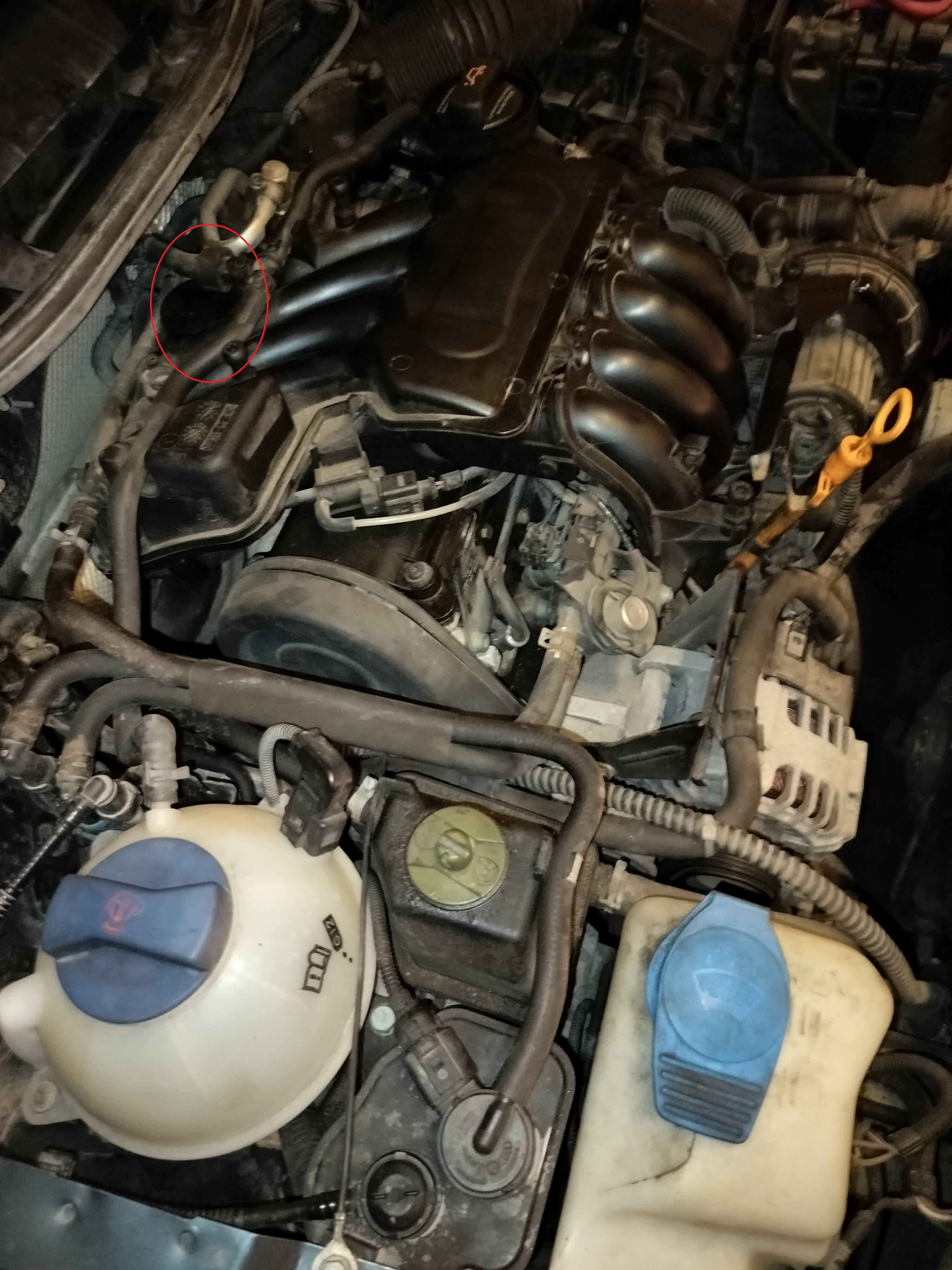

Regarding the air intake pipe, for now it is fixed with a piece of hose. As tight as possible and sealed. The membrane in the pipe is possibly gone bad, not sure how to check its integrity but i was planning to buy a new air intake pipe. If the device attached to the connector pipe is indeed just a heater then i might go with the cheaper type without heater untill the issue is resolved. Tough i live up north so this might need to wait till better times... Alternator seems to be fine, battery voltage at 14.2V steady when idling

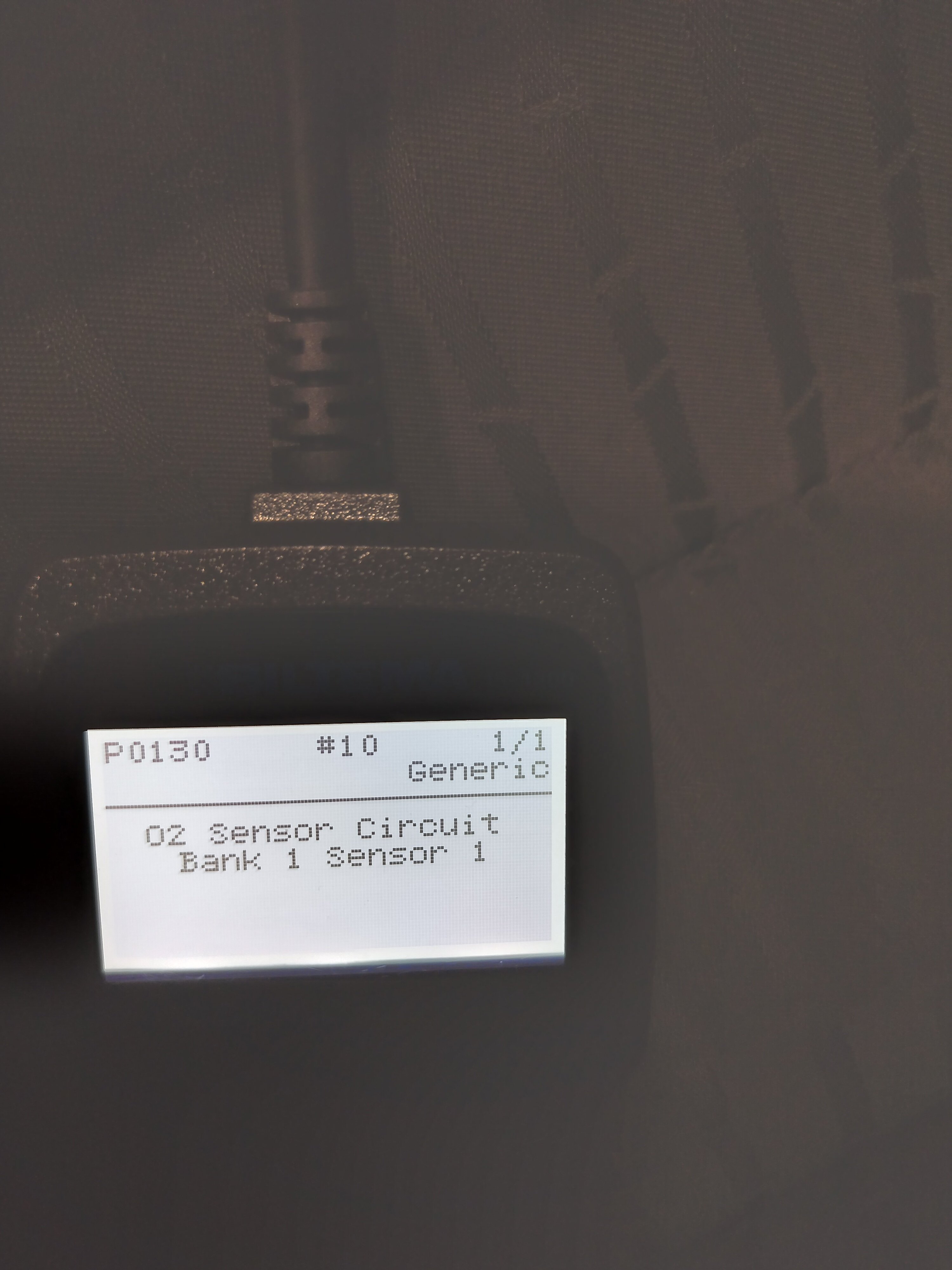

Did this get resolved @BFQnightmares? I am experiencing on my skoda octavia 1u2 bfq similar lambda problems (P0130) and also the intake pipe (with that what Breezy_Pete described as a heater) has a leaking/broken connector pipe. So i am also thinking to get a replacement part. I think the part needed is 1J0129684CH https://www.lllparts.co.uk/product/1J0129684CH At least if i search online with that code i find images of the intake pipe with the heater element. I have not ordered anything from lllparts but i assume it can be purchased there? I am also curious if you got your problems solved...

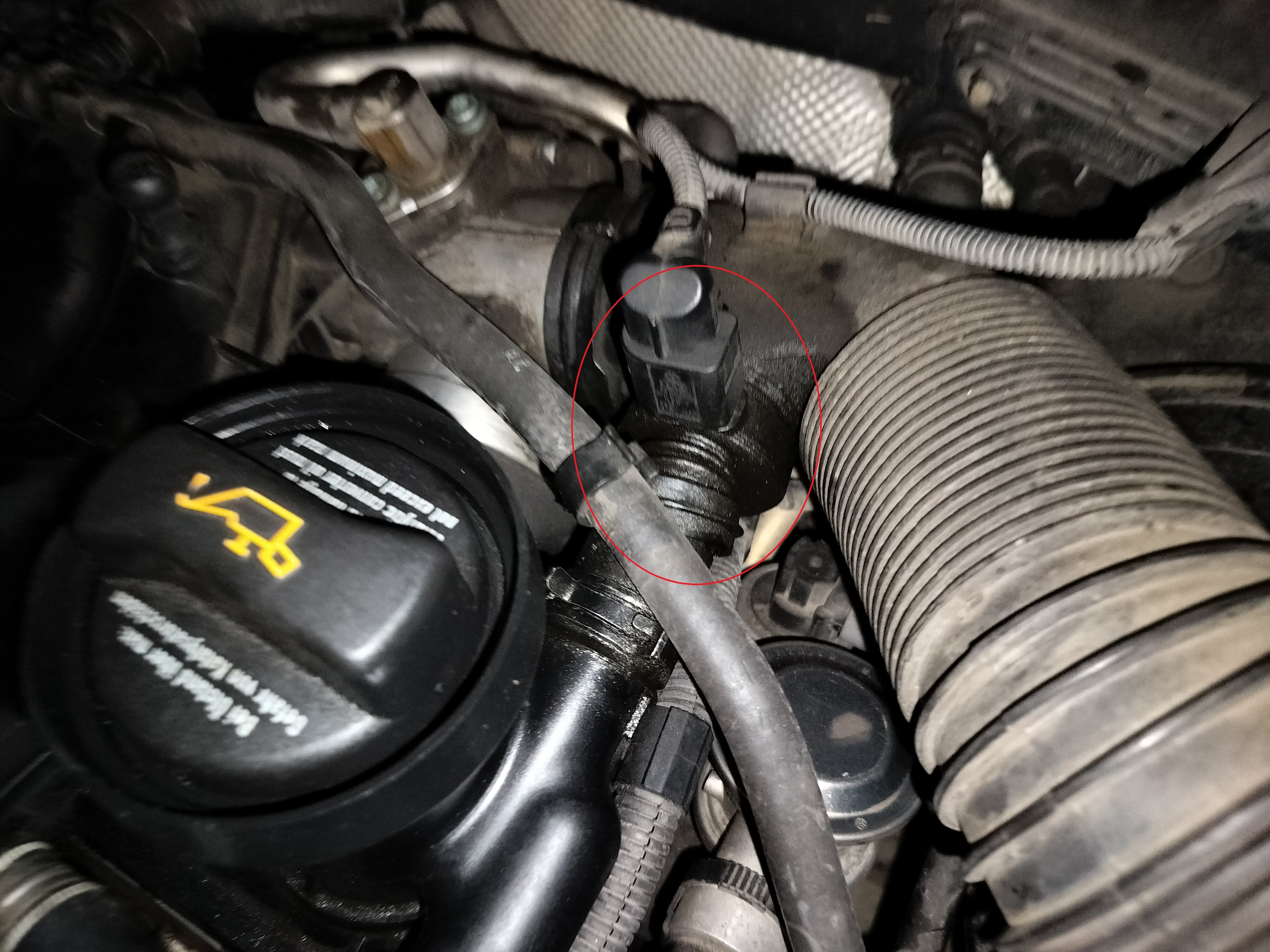

Hello, Would somebody know the location of the PCV valve on my skoda octavia 1u2 from 2004 with bfq engine code? Is it hidden under the cover of image 1 or is it that part in image 2?

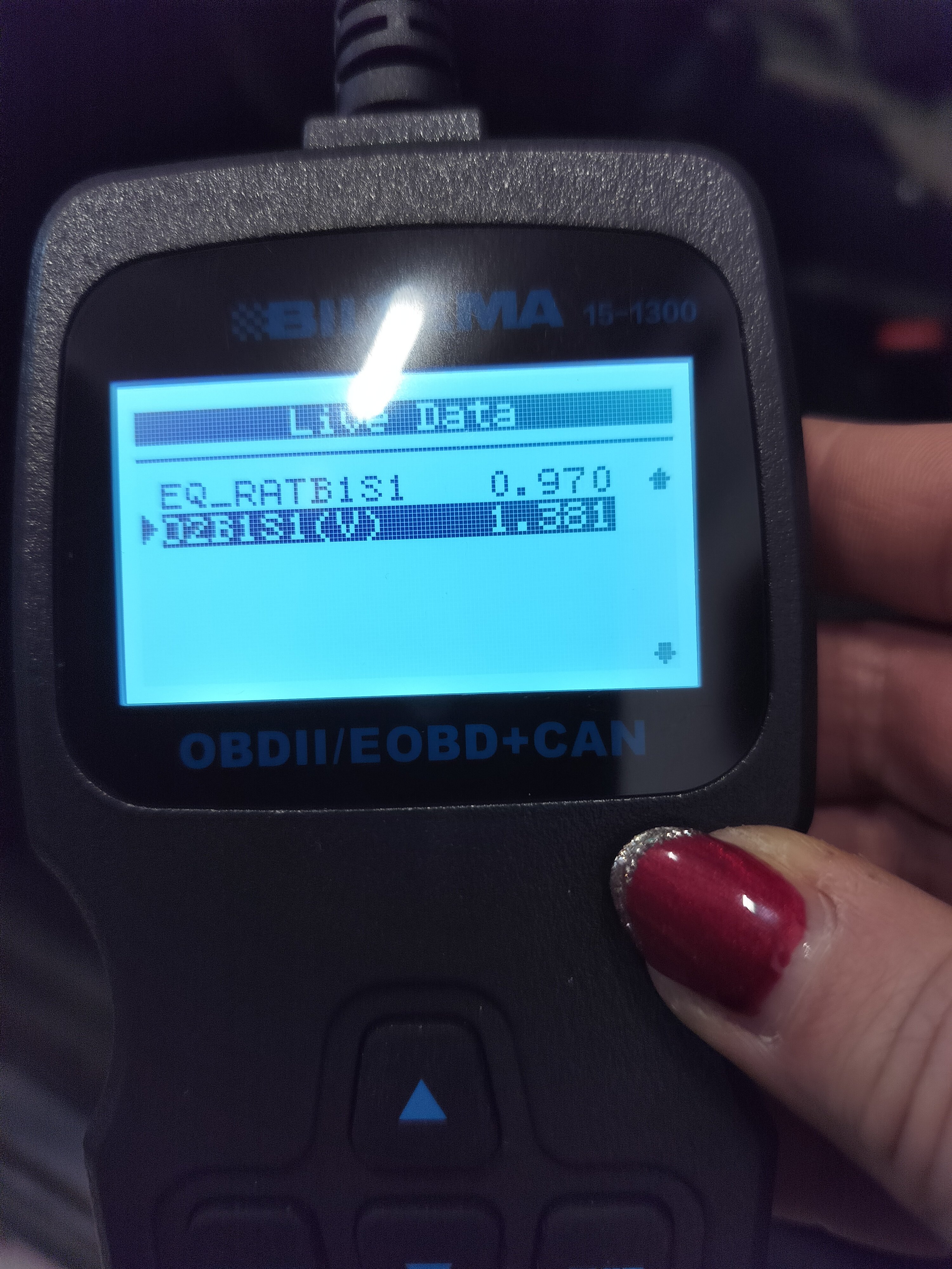

The sensors voltage reading remains over 0.9 volts even when the lambda is disconnected
Octavia vrs lambda sensor wiring issues
I am not sure what readings should i get. S8me sources say lambda heater resistance should be somewhere between 10 and 20 ohms. And if not it could mean a short circuit. Maybe thatswhy the signal voltage is over 0.9 volts? That would mean that the lambda sensor needs to be changed. This would be an easier fix than ecu or ecu wiring issues...
