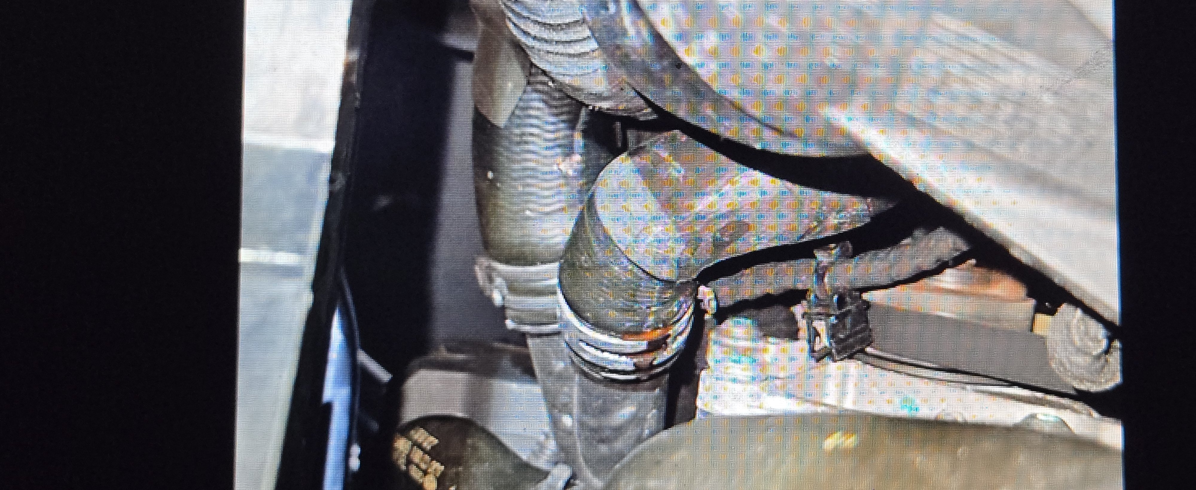

This is the part in question, this is the new piece held above the old piece in situ. Can it be replaced from the top/bottom, or does the throttle body have to come off?

So I've finally traced the leak to the plastic Y piece under the throttle body, the bottom hose on the Y is weeping where the hose clamp is, I have replaced the hose but looks like I need to replace the Y piece. I think I have to remove the TB in order to have access to the Y, is there an easier way, if not how do I remove the TB to gain access? Thankyou.

Hi, It is 99% leaking from that under that hose clamp, there is no fluid at a higher point than that. It's a plastic Y piece that comes off the waterpump, two hoses come off the Y, and it's the lower one that's leaking at the clamp, what is this lower hose called please, it seems to disappear towards the passenger side. Thanks in advance.

Please help! Coolant leak, need advice! Mk3 Tsi. This hose is leaking where it clamps onto the plastic pipe - can this be repaired or do I need to replace? Also, 20250215_171830~3.mp4 what hose is this, struggling to work out what this one is called. This pic is taken from below, you can see 2 hoses going Into a plastic Y piece next to the waterpump, it's the lower one that's leaking.
