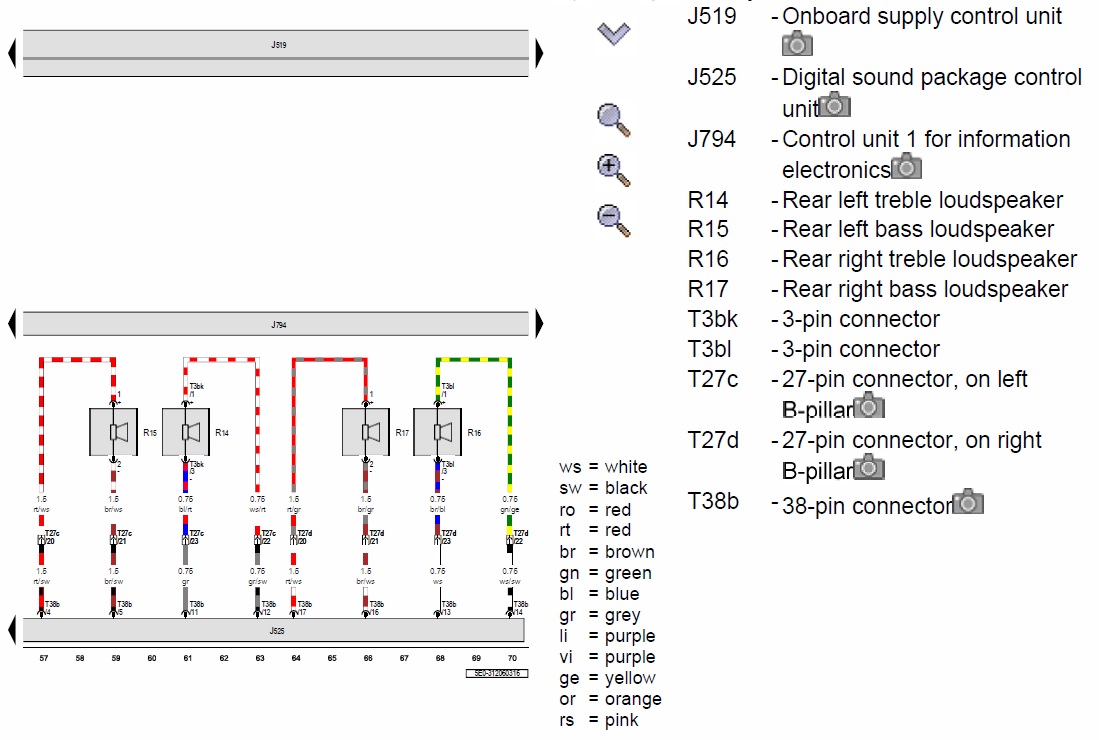

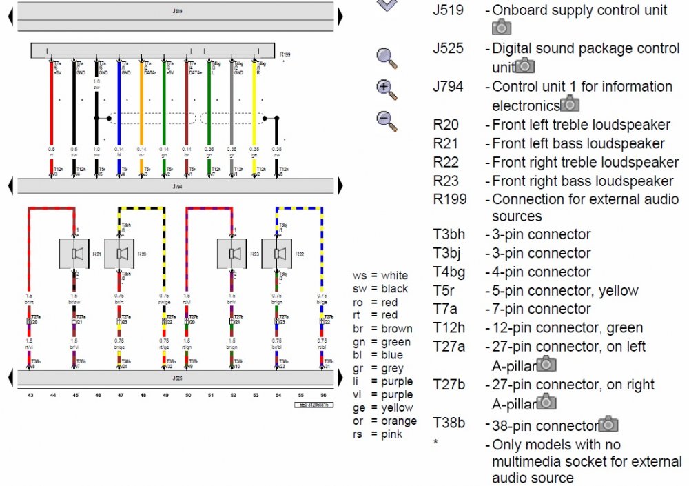

Would someone happen to have Canton's speaker wire color code list / full wiring diagram?
Yes :-)
I'd kiss you norsko if I could. Many thanks!
