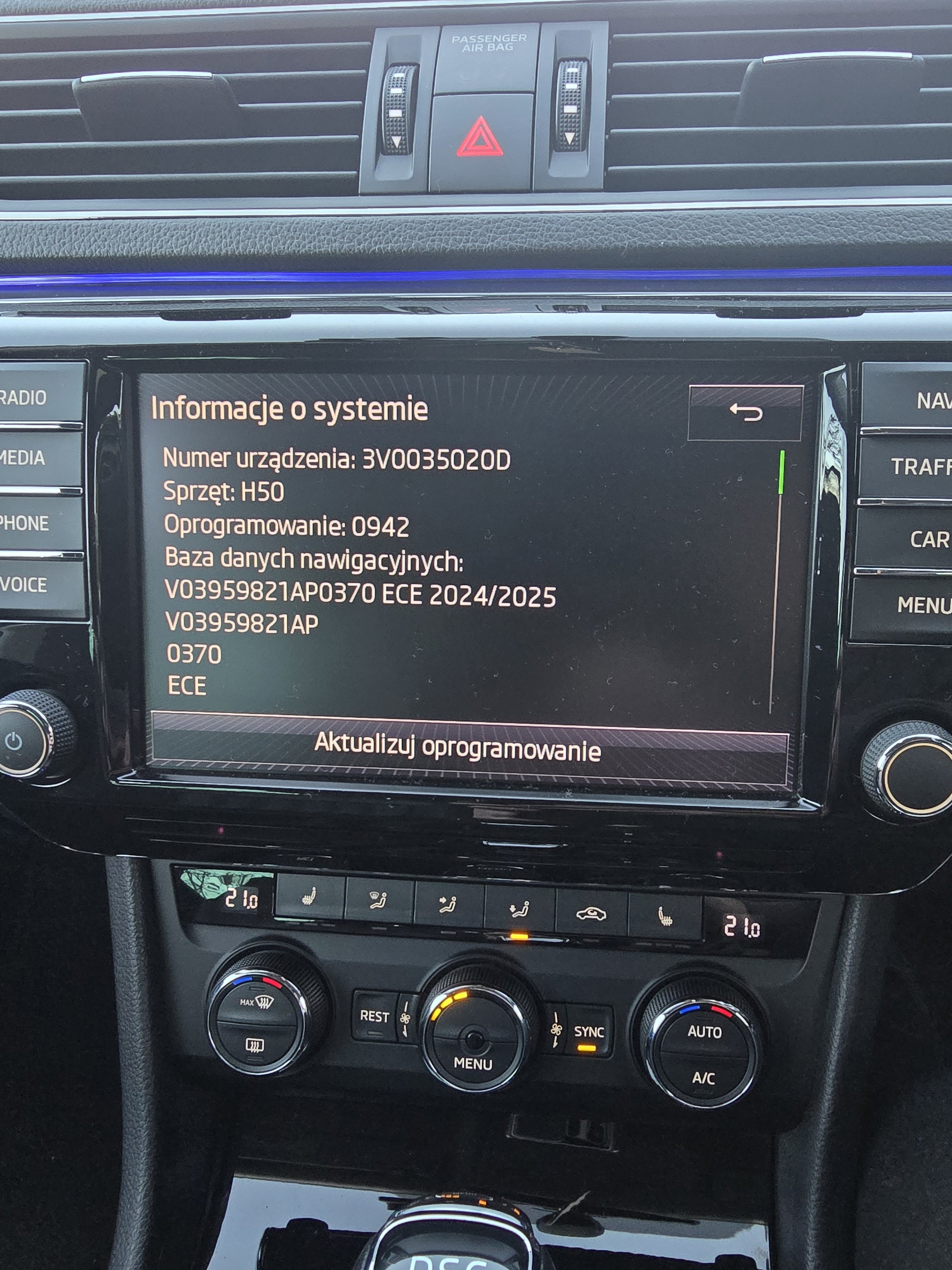

  9. Mine is harman too check attach. 3V0 035 020 D
  10. So by only update software you change mib 2 to mib 2.5 I'm right? I thought we have to buy main unit so it looks easier then.

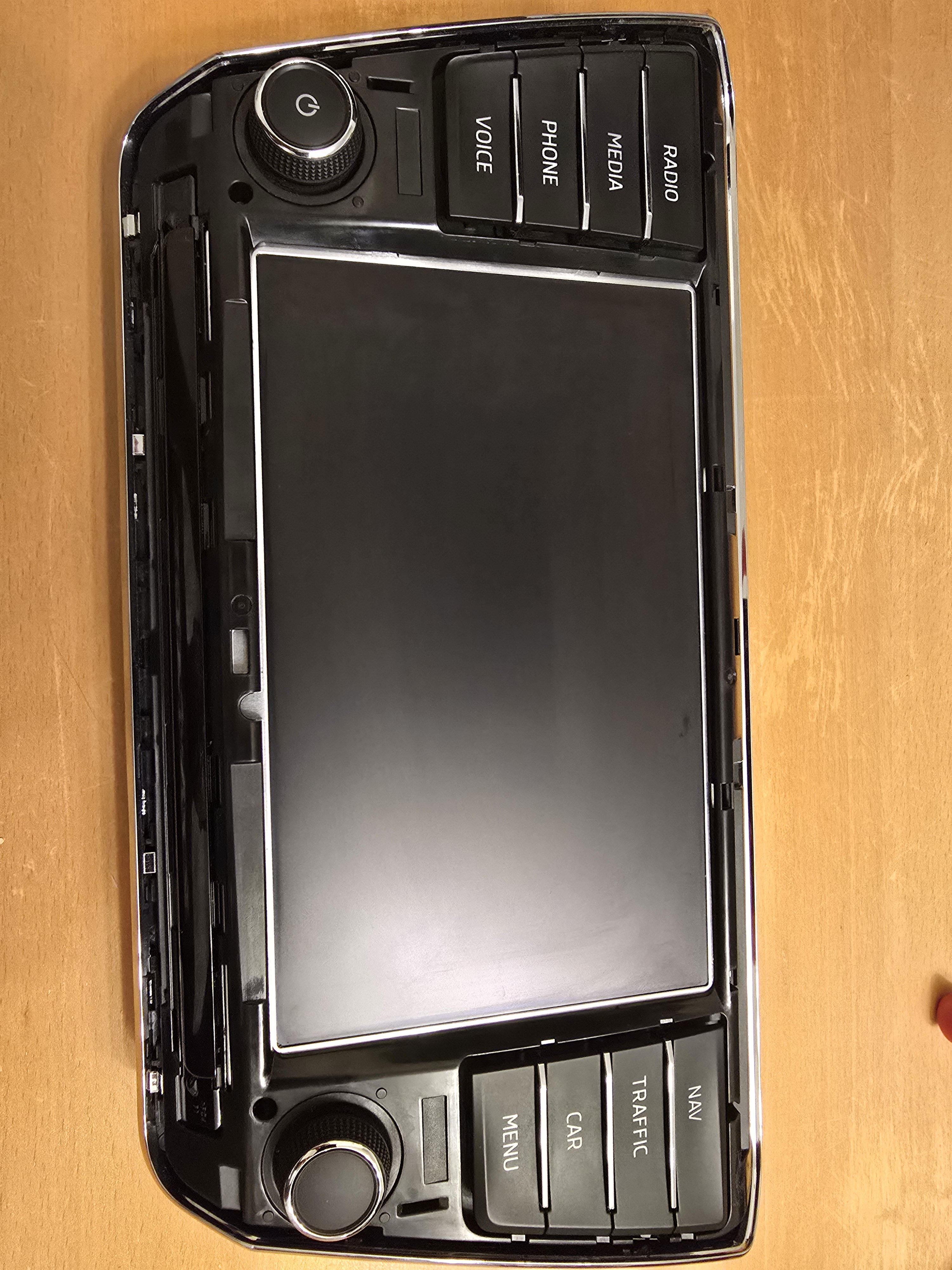

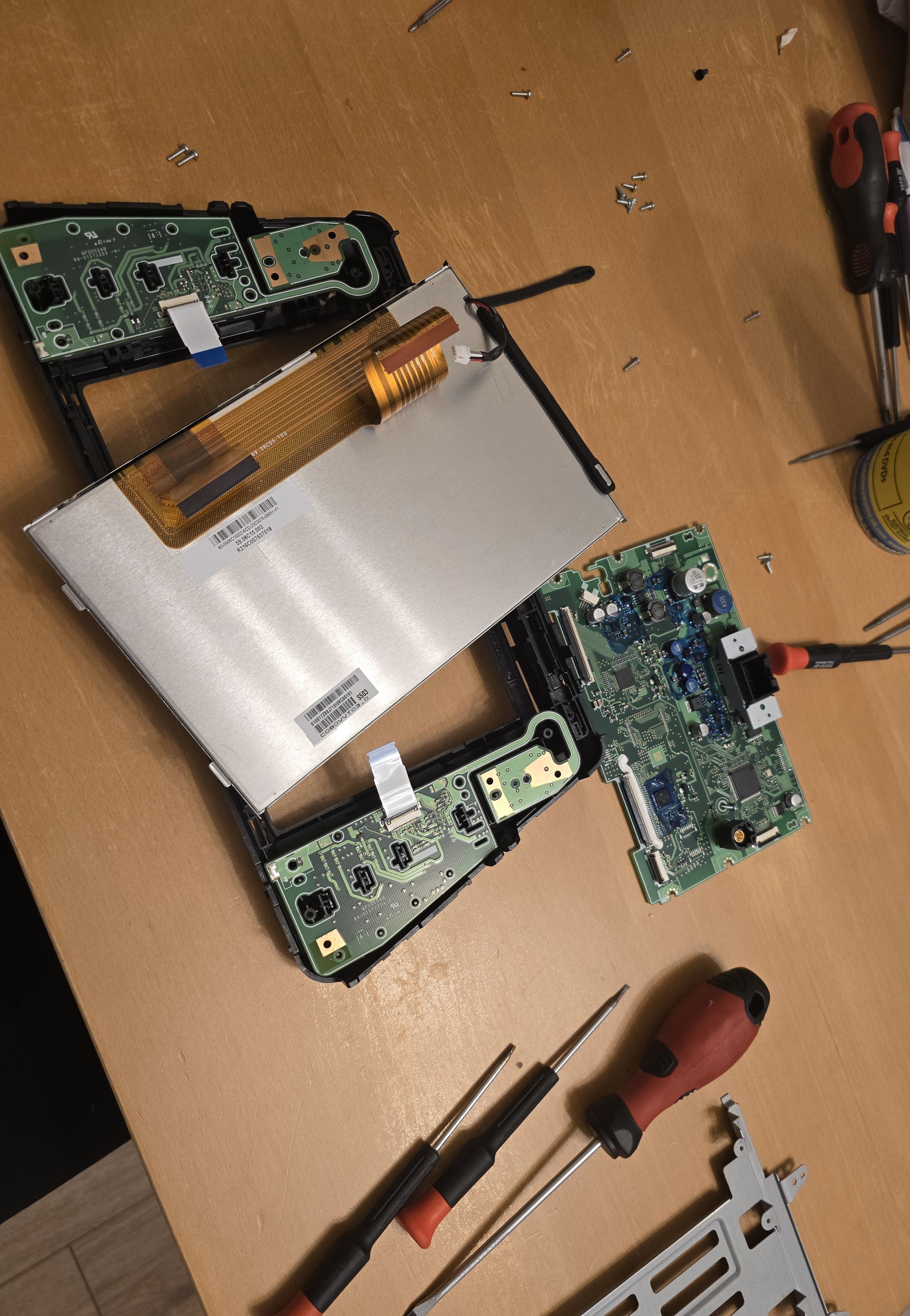

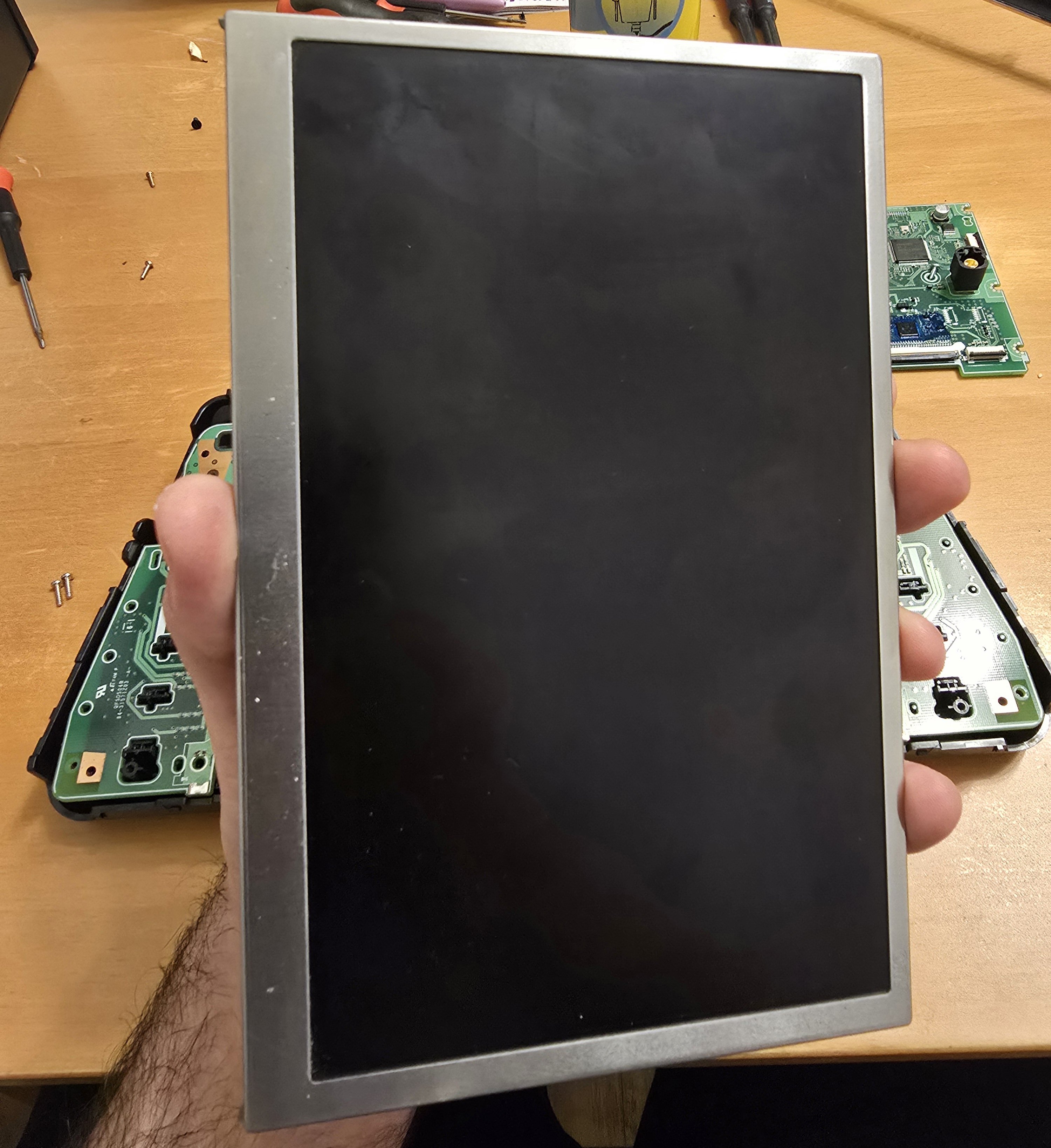

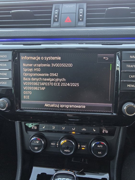

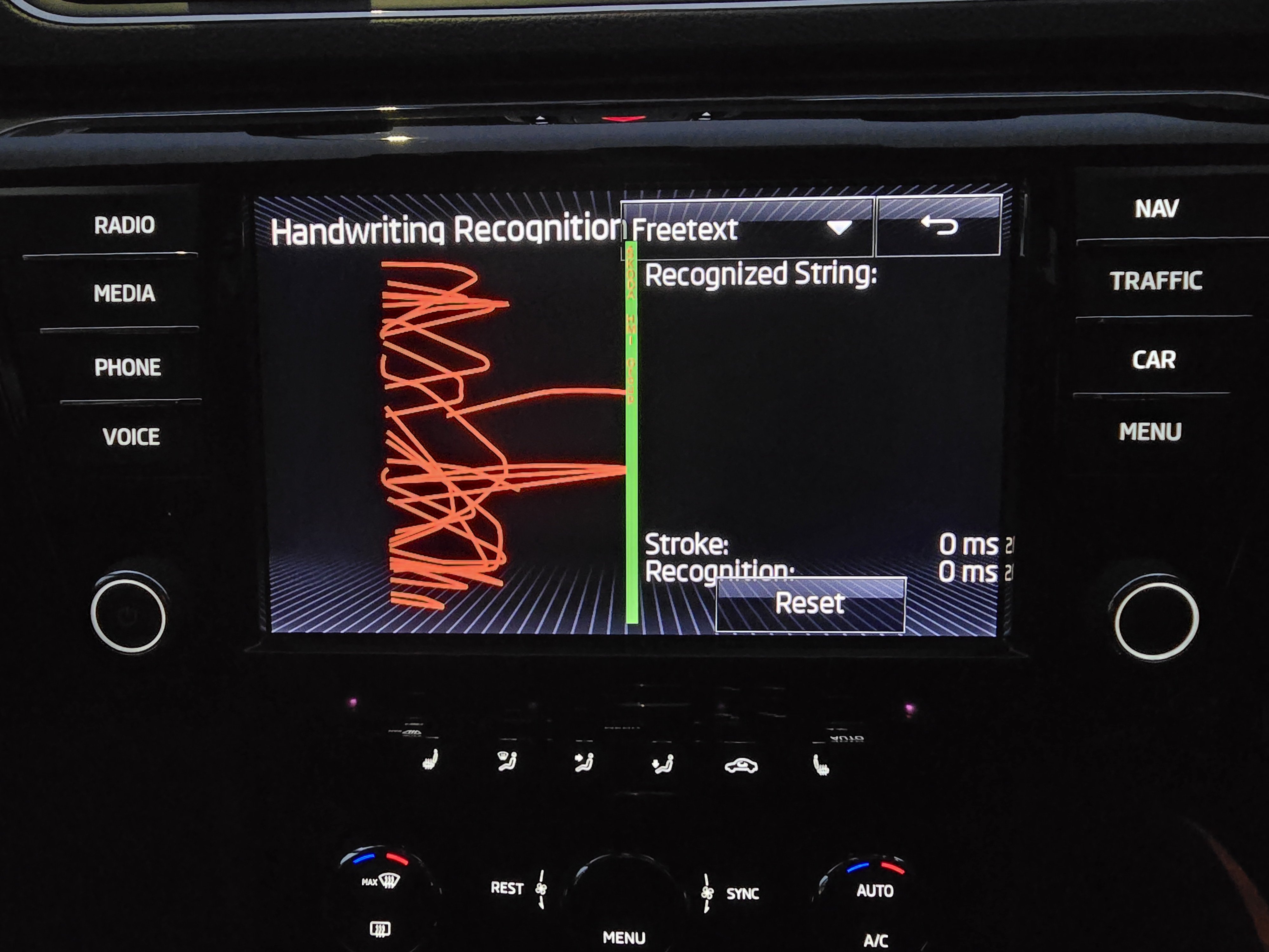

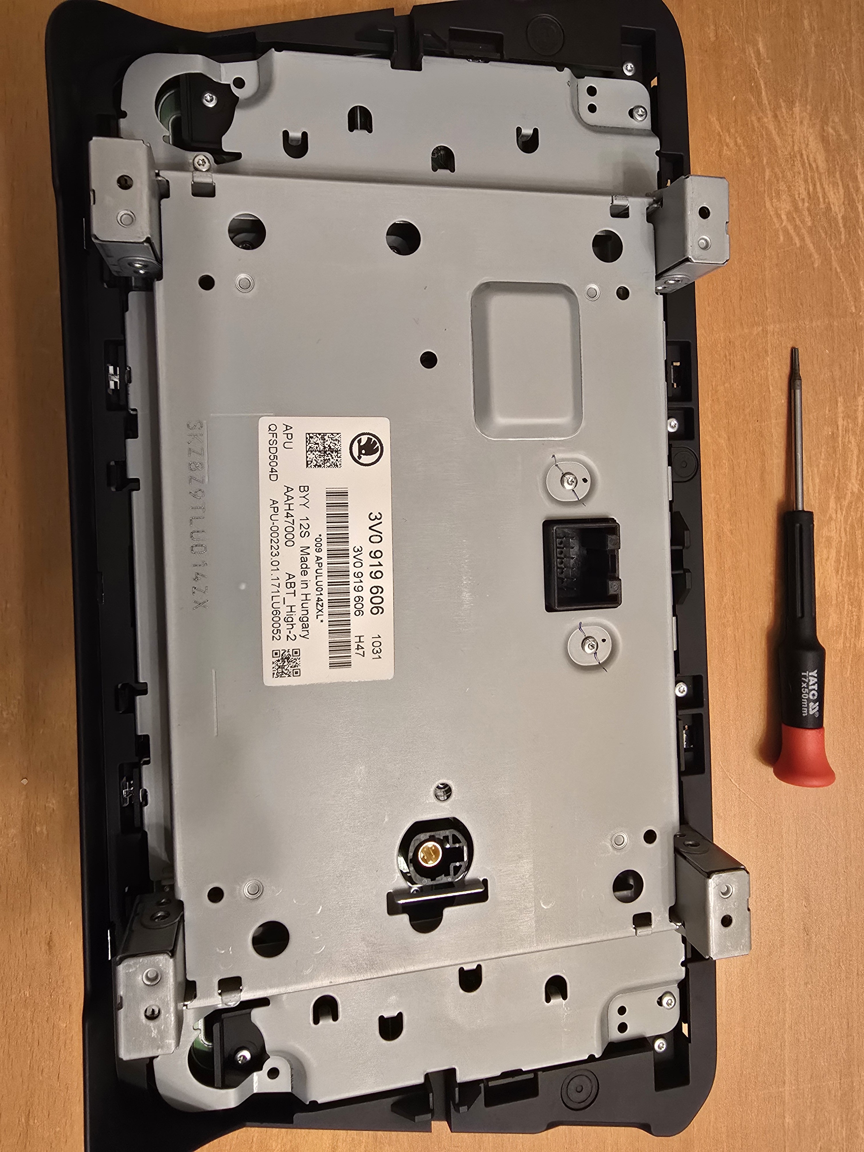

  12. Hello, Does anyone had before issue with this touch screen not responding on left side and switching radio stations itself? I tried update the firmware from 0942 to 1433 followed by someone's instruction on forum. All was done fine but of course this doesn't help me to resolve this issue. I also active developer mode to make small test with touch screen, you can see on picture from which point my screen is not working and not continue red marks (definitely left side). So I took out the screen to see what exactly I need and probably gonna buy this one from this site: Link to website I share with you few pictures maybe someone will need it too someday. All you need it's torx 7 and trim removal tool. Do you think screen replacement gonna fix this issue? Anyone had this before? Big Thanks!

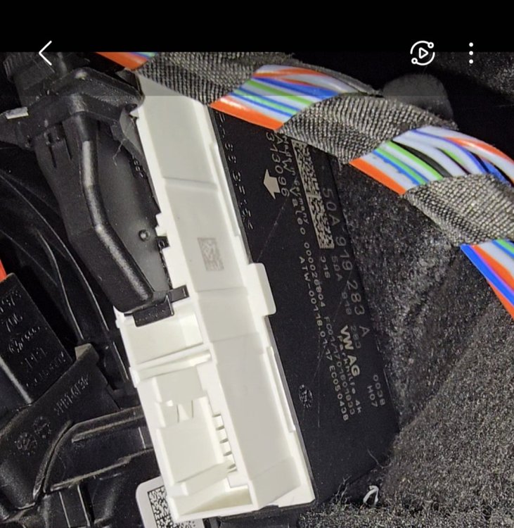

  13. Hello guys, I would like to ask if someone fitted front sensors for Skoda Superb 2017 (if it matter 2.0 TSI with right hand drive). I did some research and find out that there must be some specific module, buzzer, sensors etc. Mine module looks like this: So probably won't work because as I check some posts it must have two arrows not one (channels or whatever). At the moment I've got only rear sensors (also waiting for camera to install from Ali express) Does anyone know module and parts that I need to make it work? I've got obd eleven if some coding have to be done too. About radio it's radio with navigation and two micro sd cards, touch screen with buttons on left and right like on picture: // Also some instruction would help too how to make it step by step if there's something like that somewhere because most of the posts I found was to quote this thing for some company. I would like to try myself or if its really hard will just leave it heh. Thank you !
