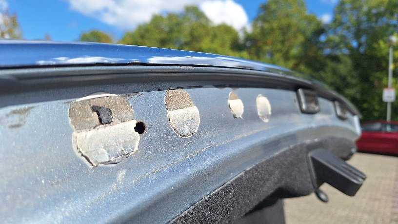

Well, I decided to do the old Throttle Body clean today and oh my word the amount of crud and soot deposits in there was ridiculous. After looking a quite a few vids on how to do do it and may I say making it look like child's play, I decided to give it a bash, after all, how hard could it be.....right? Wrong!! Unless you have arms like Stretch Armstrong (reference for anyone over 40) and hands like a schoolgirl, this is anything but easy. Fiddly is an understatement and the lack of room is quite something. Anyway, rant over about the supposed difficulty level (or my lack of skills) take a look at just how manky it actually was.- Sunroof Replacement

I went to a local one I have used many times before but I also went to a Skoda Specialist and showed him the video. He said as it was still coming out of the drain hole as well it looked more like the issue was from the top. So I pulled the roof lining away after taking off the visor and grab handle (which by the way I now need new clips for as I don't think these had ever been taken off and were really stuck and very brittle.) I do suggest using a tool similar to that of an air vent removal tool to get these off. When I looked at the drain plug it wasn't even connected to the tube....... at all!!!! I did take a pic but it didn't come out well. Reconnected the tube to the plug and.............. Comes straight out of the drain tube😎😎😎😎 Thank you so much for your advice throughout, I really appreciate it.- Leak found help please
A quick update. I will either need to be a magician or a borrower! The connection point is behind the dash. WTF! I have been to the garage and they have told me 3-4 hours for them at least to remove dash, fix the issue and replace dash. Or would I/they be able to get to this by taking the wing off? I have to say, what a terribly designed system. Not sure why my pictures seem to be uploading upside down.- Leak found help please
