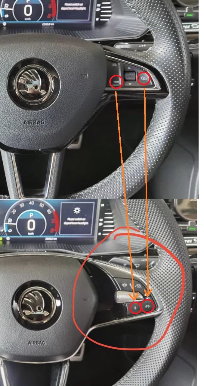

Coding of Steering Wheel controls
As I understand it, there are three types of button connections to microcontrollers: - direct (1:1 each input pin has its own button) - analog (several buttons can be connected to the same analog input, the detection of the activated button is in voltage, such as 3V....) - network (this method is usually used with more than 8 buttons, this is how computer keyboards are also made) When determining the connection for the steering wheel buttons on the printed circuit board of the keyboard type: 3V0 919 719E, I found that an analog connection of buttons is used, which are supposed to be two-channel. This assumes that microcontrollers could have more buttons programmed, the actual operation and use is hardware-dependent. If we wanted to confirm this, we would have to solder a potentiometer instead of a resistor behind the button, with which we could set any resistance, which would consequently change the input voltage. With the help of VCDS software, we could determine the function of the button.... In case of using a newer version of the steering wheel buttons: 5E3 919 719E, it would be necessary to check whether the circuit is made in the same way. I assume that this could change the operation of an individual button that does not work for us, we could probably change an unused button for new functions, such as using a phone call. More about the analog operation of the buttons on the Github page: https://github.com/mickey9801/MultiButtons

I'm not sure, I think it would be possible to adapt the newer key set for type: 5E3 919 719, so that the keys work the same as the older or original version: 3V0 919 719E. For more information, I would need as accurate as possible pictures of the printed circuit board of the keyboards of type: 3V0 919 719 5E3 919 719 5E3 919 719E

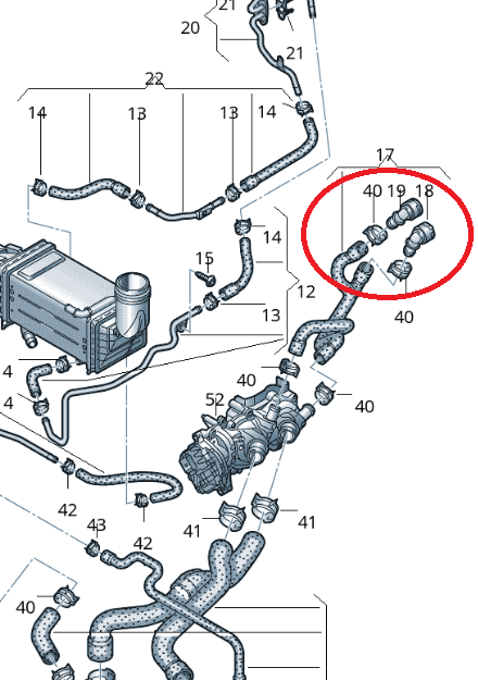

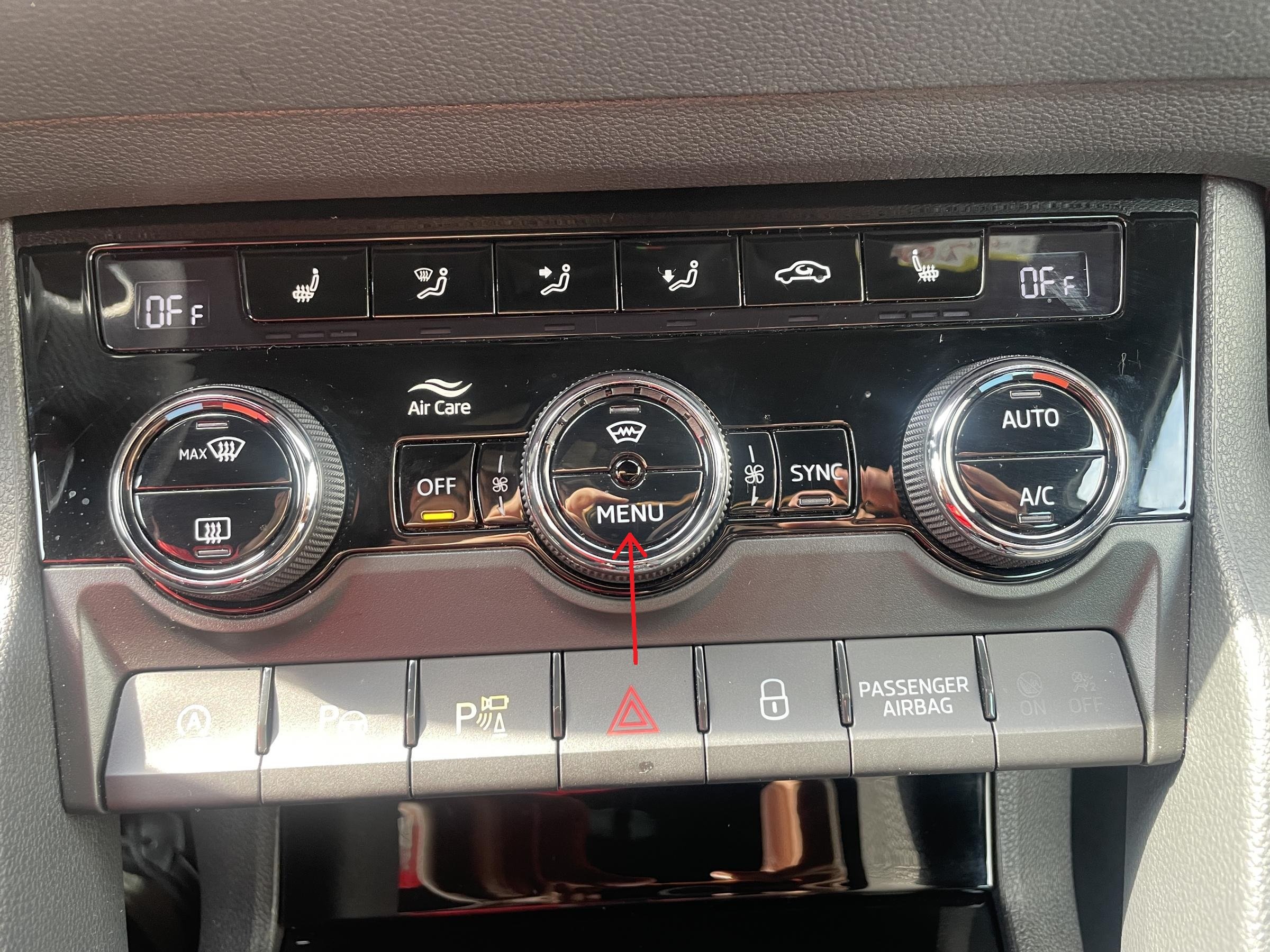

Skoda Karoq 1.6 TD SE thermostat replacing.
Which sensor exactly? Information about the type of ventilation would be very helpful, single or 2 zone? If I succeed, I will try to play around a bit with the elm327 adapter and free applications.... I promise nothing.

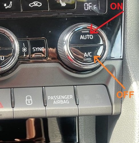

I think the reason for the cold air in the car cabin is the "AC" being turned on. When the "AUTO" mode is turned on, the "AC" is also automatically turned on, which is supposed to remove moisture from the air conditioner's cooler while it is operating. The resulting side effect is cooler air, while when the "AC" mode is turned off, warmer air is blown out.

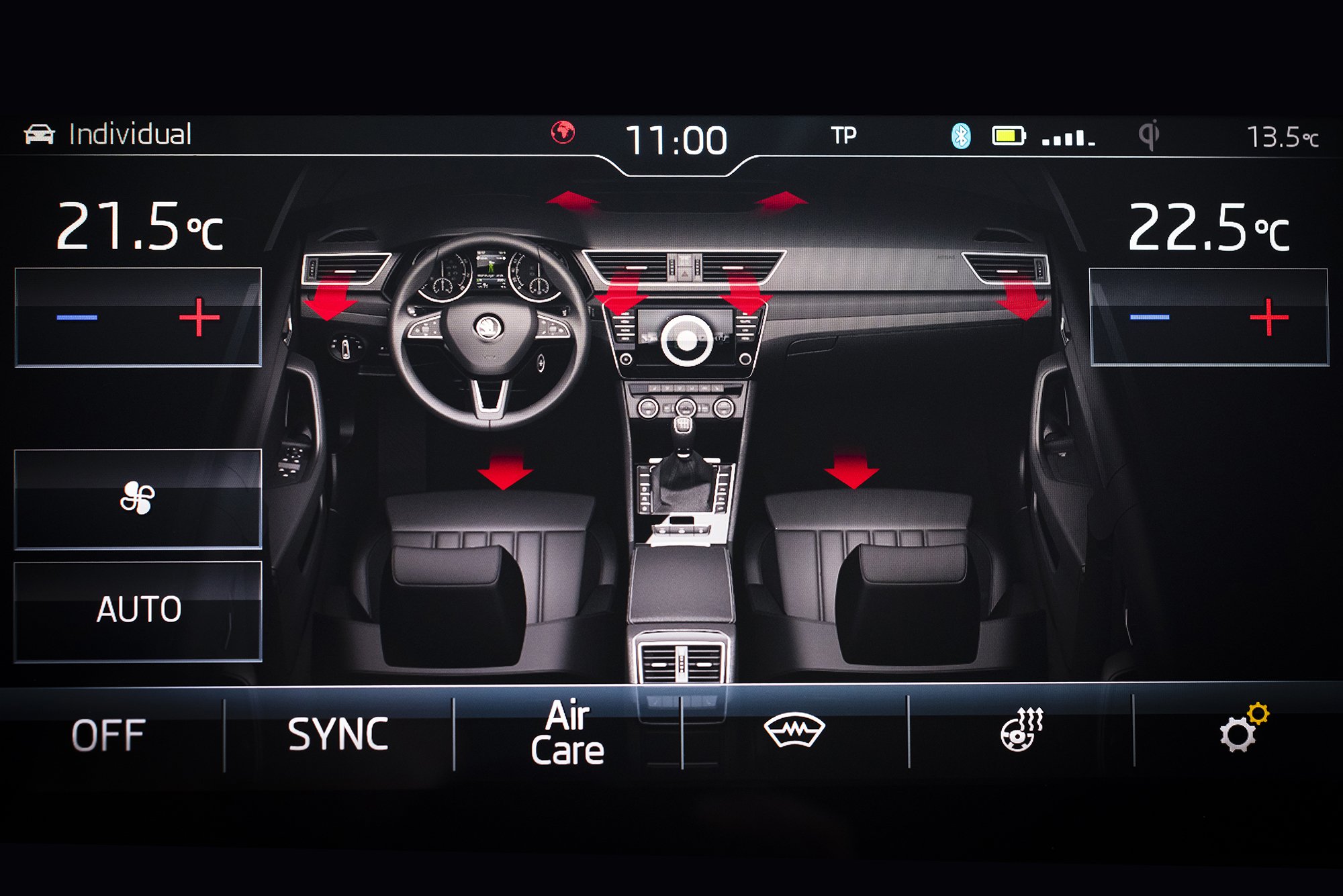

I checked a little, as far as I know, these red or blue arrows change color depending on whether heating or cooling is set. In automatic mode, when the temperature is reached, cooler air could be gradually blown into the car cabin. In any case, at current outside temperatures of about 5°C, when the heating is set to max, cold air should not blow and vice versa. More than that without direct access to the car and checking or testing the sensors and flaps, I don't know how else I could help.
Something is not clear to me, karoq 2018 uses an older type of steering wheel, karoq 2020 uses a newer type of steering wheel. Is the problem in the module type (different letters) or just the coding?

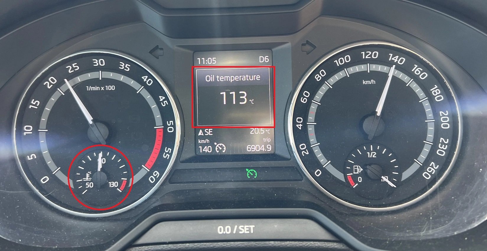

For comparison, the 1.5 tsi engine somehow warms up to a working temperature of about 90°C at an outside temperature of about 5°C at about 5km. The engine oil warms up later, reaching a temperature above 50°C is reached between about 10km, after about 25km the oil warms up to close to 90°C. This data can be seen on the Instruments cluster: The next step could be to somehow check the inlet and outlet temperatures of the coolant from the car cabin, in the case of hot pipes, the causes could be in the cabin. Then only the causes in the cabin remain, such as sensors, the other is the engine flaps for temperature regulation, control electronics,.... A long time ago I had an experience with the cabin temperature regulation, it worked once, the other time it didn't, with the air conditioning on it started blowing hot, when heating it started blowing cold at some point which would mean a breath of fresh air, hot or cooled. When connecting the vcds diagnostics, I found an error for the flap motor in the car's cabin. For anything more specific, better diagnostics would be needed, sensor temperatures, values and positions of the flap motors,... Certain sensors are also visible in the climate menu on Information Electr., which can be accessed by clicking on "menu" on the climate module. Some basic diagnostic steps can be done using these menus. This picture shows the connections that heat the cabin, if everything is ok one should be hot, the other slightly cooled. The hose connection should be located around the turbine.
