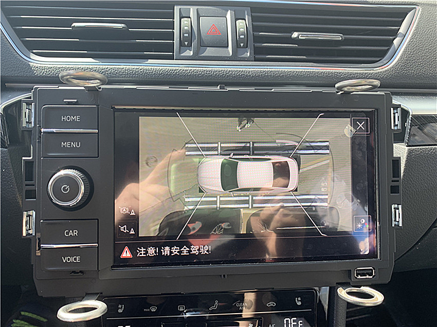

  10. Hi all, Greetings! I am driving a Superb L&K, manufactured in year 2020. Some newer variants of Superb sold in some countries are equipped with 360 panorama camera. I have been on a quest to identify means of sourcing the parts and installing this. Has anyone done this modification before? I've been researching for a while now but found limited information, particularly on the need of coding in order to enable this function. Sharing on my research so far: - VAGEXPRESS seem to carry the parts: For Skoda Superb Kodiaq original 360 panorama 360 degree panoramic image Super original 360-degree panoramic image (vagexpress.com) - Online picture from AUTOBICS seem to suggest that it is doable 2021 Skoda Superb 360 degree Camera - AUTOBICS - SATNAVSYSTEMS from the UK is able to do this for those in the UK Area View / 360 Camera Upgrade for VW, Audi and Skoda - Bing video I've reached out to VAGEXPRESS and pending their reply.

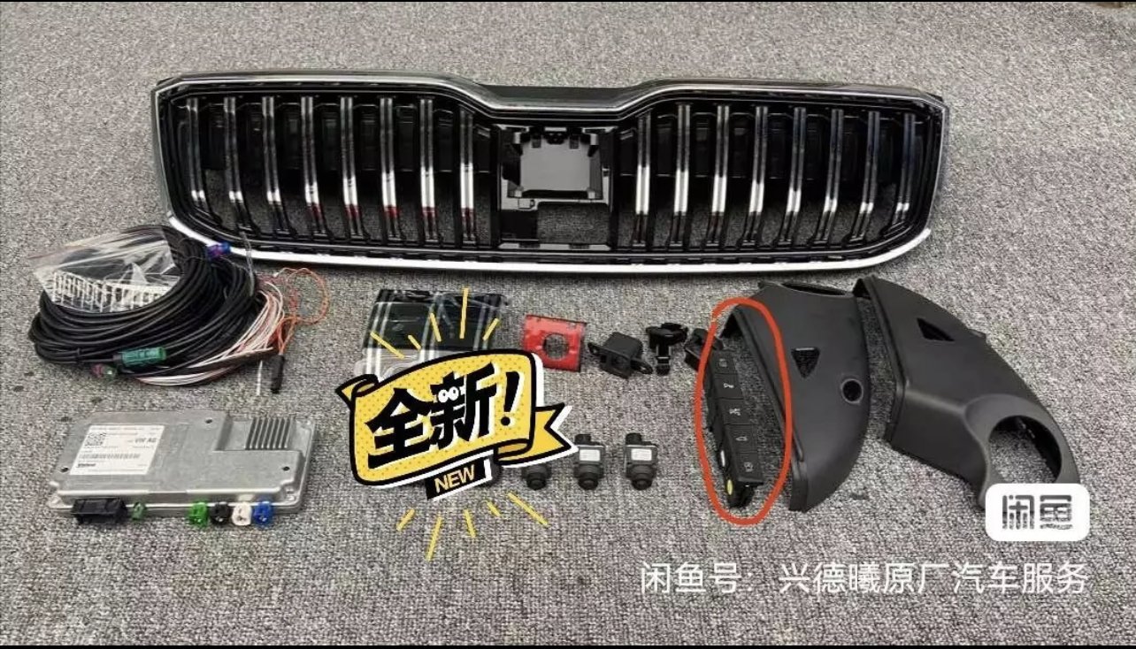

  11. Sorry for the very late reply. I was out of touch from briskoda for a while now. An update to the 360; The supplier from China is not 100% that the parts will work. While he can source for all the items in the picture, the existing buttons alongside the gear knob may not be compatible given the various variants available. I'm still need to progress this.... maybe I should start a new thread?
  12. Thank you for sharing! I'm keen to enable this for my Superb! Roy - Singapore
  13. Update: 1. Steering controls - this was resolved through a LIN convertor which allow buttons to be programmed. 2. Drive select and start/stop button - I installed this and it is working well. Purchase link included here. There’s 11.11 sale. Great deal! https://www.aliexpress.us/item/3256802851402654.html

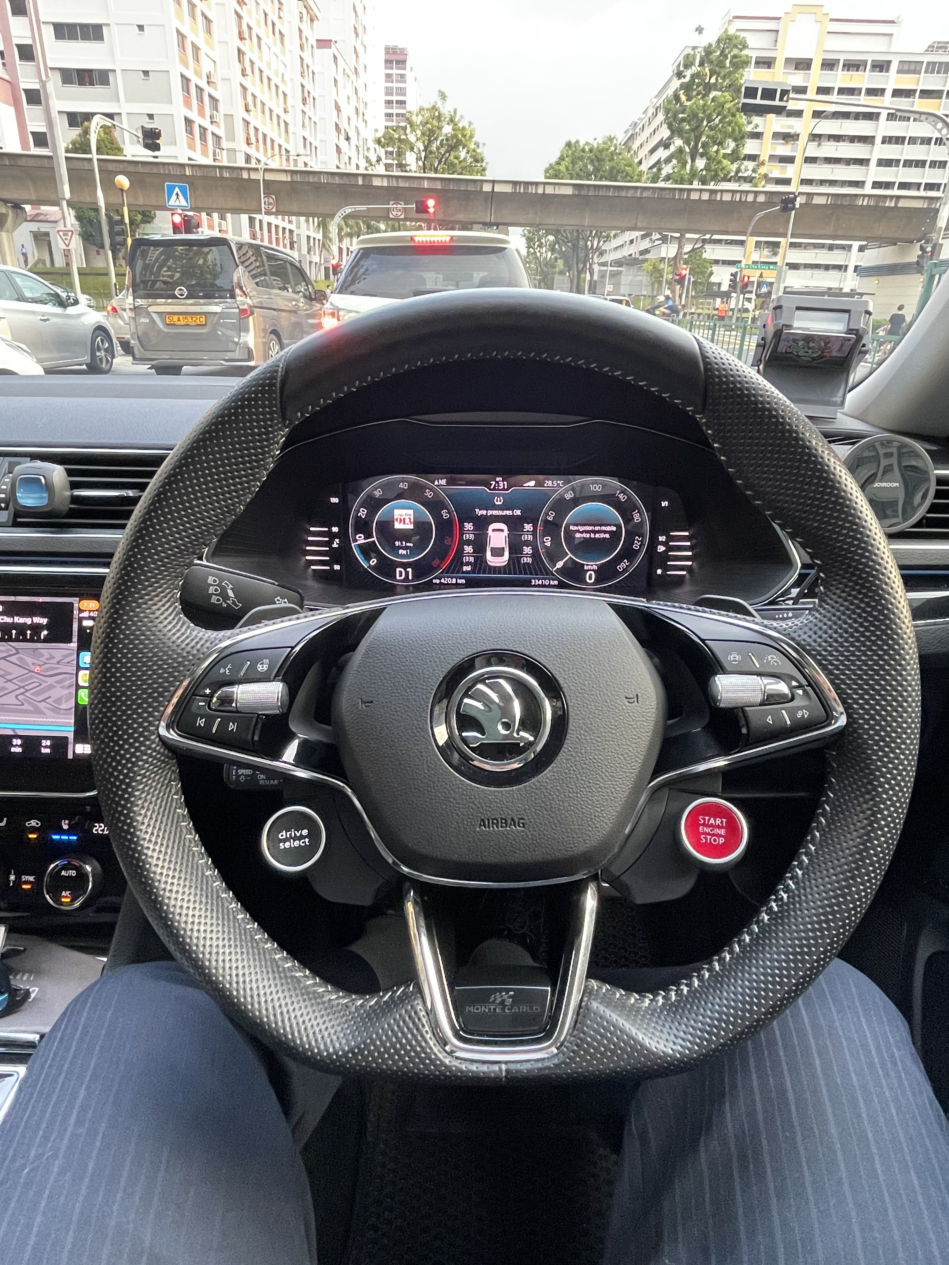

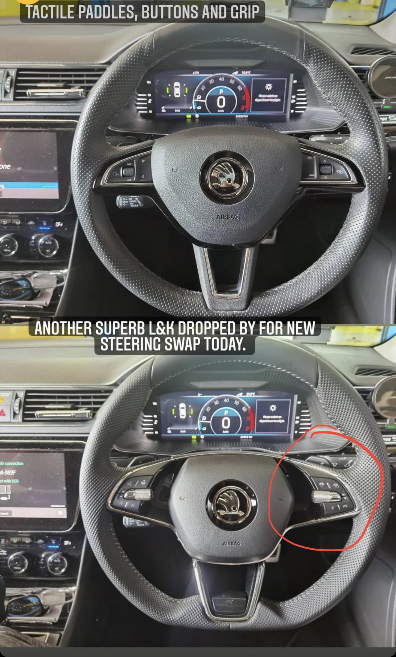

  15. Hello guys, I need some help here! Purely from a vanity standpoint, I’ve changed my steering wheel. After installation, the buttons to the left pertaining to multimedia (music, volume, skip tracks etc) are working fine. However I noticed that some of the buttons on the right do not work. I need advice on coding 2 of the buttons to the right hand side of the steering wheel to reactivate: 1. Changing of digital cockpit views 2. Menu that list down the various vehicle optionality (e.g., Vehicle status, oil temp, reset trip counter etc) Can anyone help?
  16. I found a supplier from China. The same dude who sold me the VW TPMS and module holder. He has everything except the grill. I will check with him if he is able to secure stock. OBDEleven has an app feature to turn this on without coding. I’ve been researching and can’t find any precedence on this modification so it will be a risky project…
