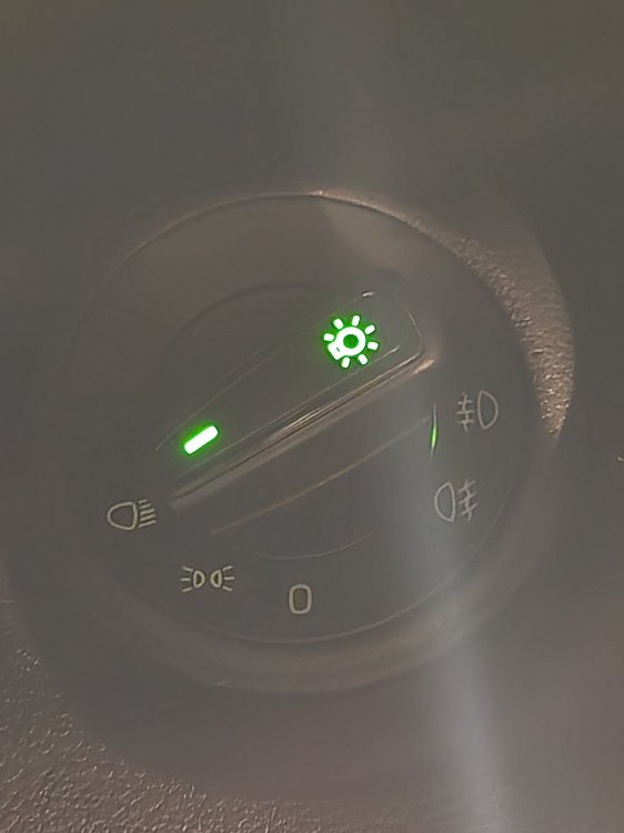

Hi Yes the ignition is on and engine is running. I'm wondering if there is a fuse for it because I've also seen that the lights up the window switches are not illuminated either. I havent got any aftermarket things fitting to the car. I will tske a look at the manual as the car didn't come with one. And yes I got the window sorted which ended up being a window switch. And the buttons on the steering wheel as well. Turned out that the car had been in an accident but not recorded. When drivers airbag was deployed, whoever repaired it put a normal airbag harness inside instead of a mfsw harness. I bought a mfsw harness off Ebay, fitted it and it's all working now. I will check the Manual if not I will havw to do some digging around. Thanks for your help

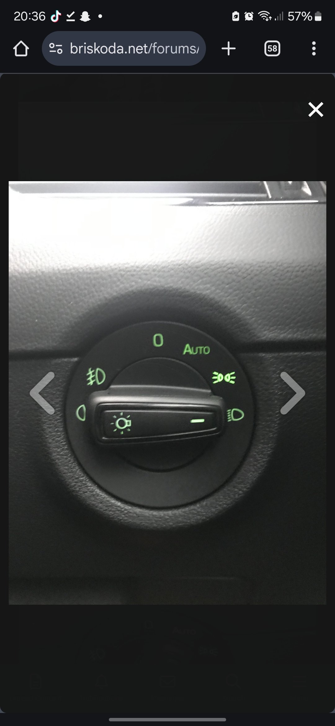

Hi all My car is a skoda fabia mk3 2015 1.2 TSI Monte Carlo I have a problem with my light swticher which is located on the bottom right of the dash next to the key ignition. When turning my side lights on or dipped beam lights it lights up green but very faintly and flashes 3 times. Whilst this is flashing, I hear a buzzing noise coming from behind the gloves box and after 3 times of flashing, it stays off. Can anyone help me on how o should fix this? Is this a faulty switch or an electrical problem? You can see in the photos of how it should be and what it is now ( the first photo it how it should be lit up without the auto light )
