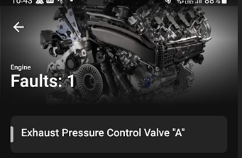

  12. Hello, I have used OBDEleven on my Scala and I have found this fault which regularly come back if I reset it. Does someone know with it ? I have made full check at dealer for 90000km operations about 6 months ago. Engine is 1.5 TSI 150.
