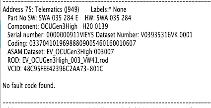

Hi,sorry to intervene,I have a Kamiq built in Jann 2020 and I post you the picture of my situation after TPI recall done in July 2020.
Update to 143
Thanks for sharing, it seems they brought you up to version 139. I wonder whether it was on 88 before or 35 as mine seems to be.
