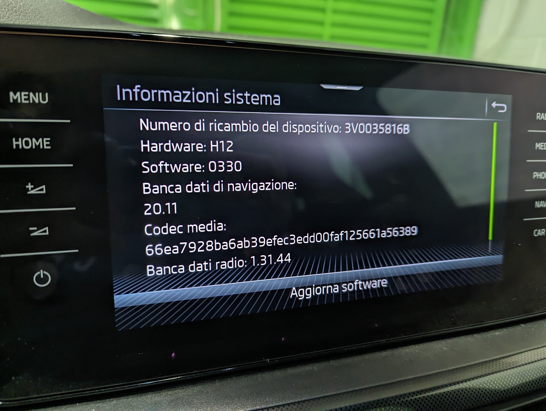

PS: btw, proof that i'm on 330 now :) i also connected the car to my wifi in the garage and perfomed an online update for the maps, i'm now on 23.6 database and not on 20.11 like the photo sais).

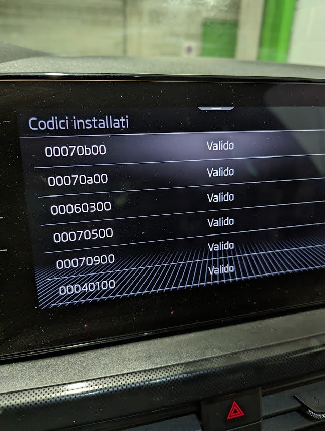

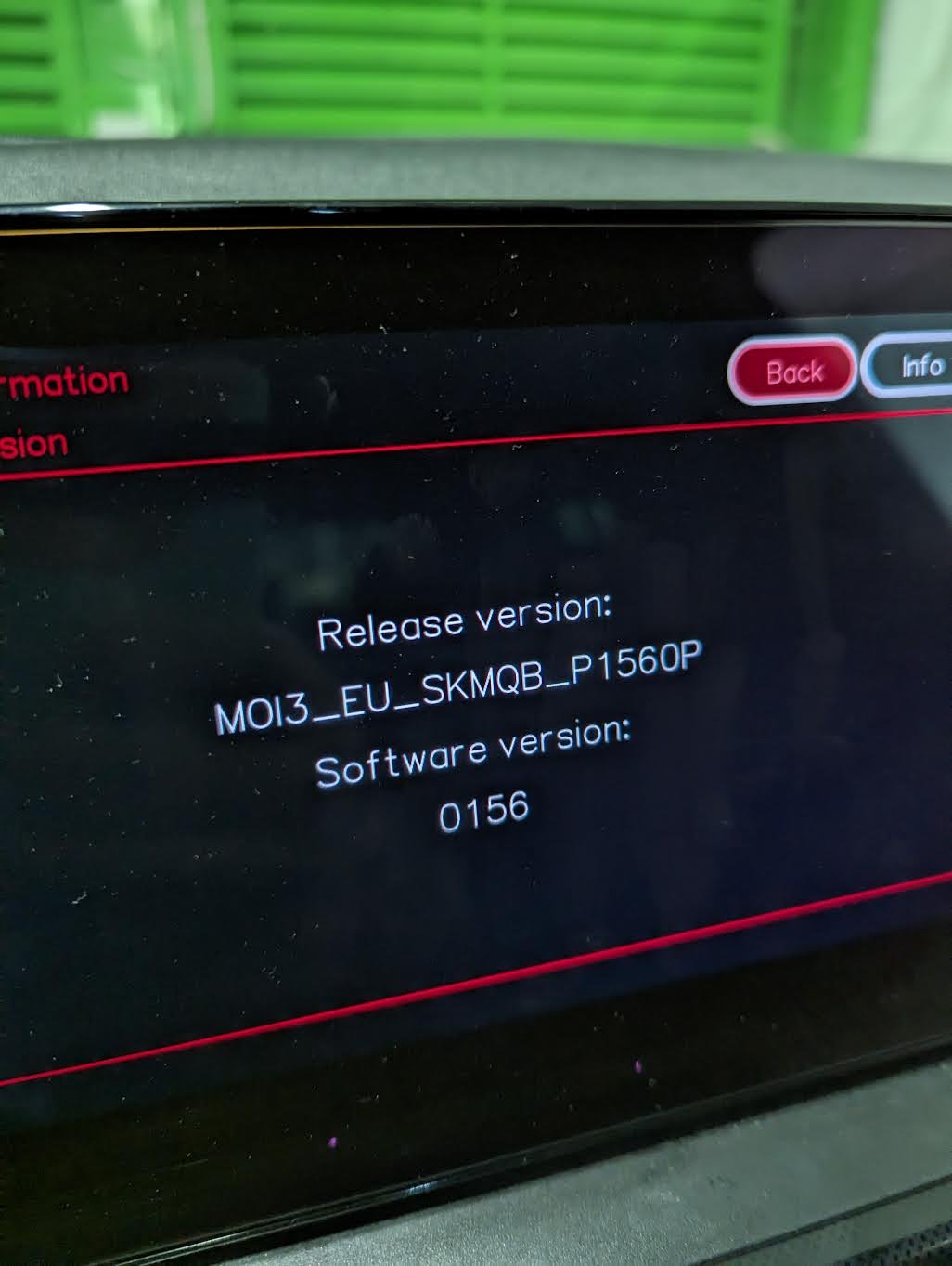

0238 breaks Navi, anything else that is not 0156 should have 00071C00 already enabled and valid.
You can check by long pressing menu and go in the Installed FEC, scroll down and i'm confident that you will spot it there at the end.
Here in the picture i was still on 0156 and i had no 00071C00 showing up, the older TPI sais that any car that is produce after jannuary 2020 should not have the upgrade problem because it's already sold with a newer version like probably yours is with 0270.
Just go and check: if it's there updates are really simple like copy on usb and apply, nothing else needed (except for updating OCU to 141 or 143 ofc). Protip, you can start directly with 0306 skipping 0276 and 0278, then go with 0308 and 0330.

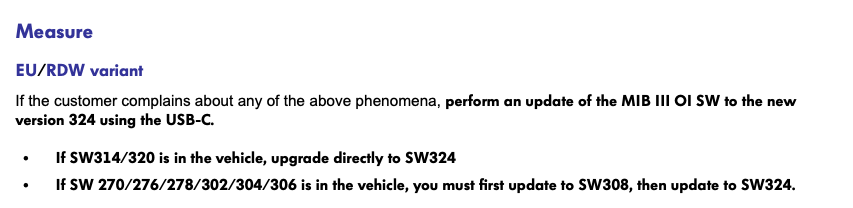

My TPI said, as you correctly mentioned said that I can go directly to 0308 and then 0324 (apparently 0330 was released in the mean time). There was nothing mentioned about the OCU.

You need update to 306 or 308 first.
Then to 324 or 330.

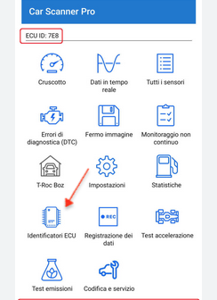

You can try Car scanner with a cheap OBD elm 327. With this you can do 3 codings in trial mode before paid mode.
