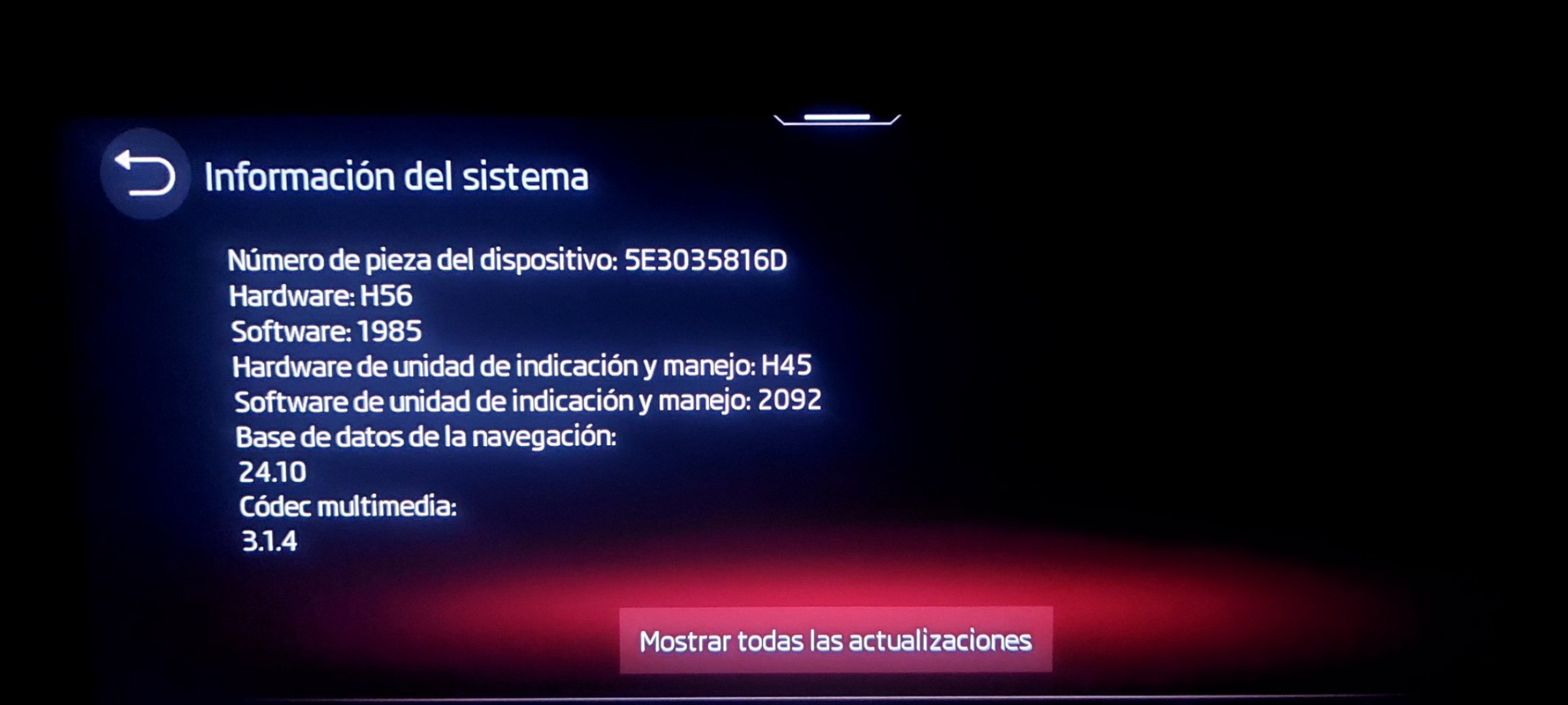

  5. Hi @Cairus Are you referring this info (attached image). I'm still having the same problem. I tried to update manually the maps with a USB stick but nothing happens. Some times when I start the ride it works correctly, but the 95% of times it doesn't work. Thanks
  6. The problem it's I'm already subscribed for 3months. I got another updates for other systems but not for maps or navigation. Crazy. I'm pretty sure the problem it's the German software or SIM. Maybe it detects it's in another country and it doesn't update a big update. I bought this car from Germany and know it's in Spain. For this reason I think the only way it's dealership.
  7. Yes I have tested it in both type C. I have changed to another SD card (128GB) with same result. It has been plugged this week and I have trips for more than 2 hours but nothings happens. If I put a song in the root folder I can play it. @Exkiwi thanks, I have the same structure. All folders in the root. I'll probably take the car to the dealership
  8. I have used a Micro SD 128gb with a connector, but it doesn't be updated. I have plugged it for a long travel (3h) and when I have checked the version, it was the same. I will leave it plugged the next days
  9. Hi. I used a USB drive and left it in while driving. I finished the trip and after 4 hours, nothing had been updated. All unzipped folders are in the root of the USB drive. Is there anything else I need to do?

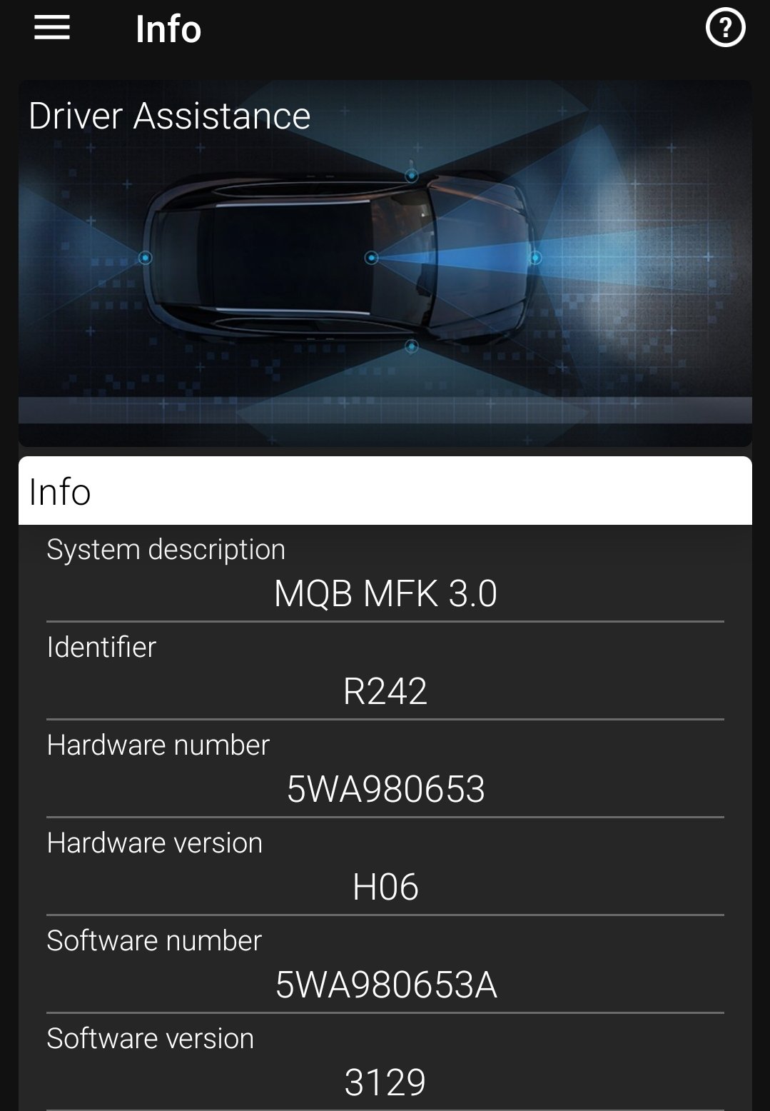

  10. Sorry I don't know how can I check this info. I'm pretty sure the camera is the original, they didn't change it. In my case I recalibrate the camera in a windshield repair service and every parameter was in range with the panel that they put in front of the car
