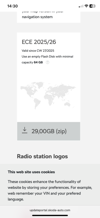

For those without the online service, downloadable maps were updated in the last few days to week 27 of 2025 ie CW 27/2025
I’ve tried five separate times this month to download this 29 Gb file (which takes between 1-2 hours) and all goes well until it reaches about 22 Gb downloaded, at which point it kicks me out and won’t let me restart from the point it cut off. Very frustrating!

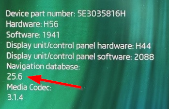

There were two updates to the maps in quick succession. The maps stayed on 25.1 until end of May, and then I noticed it had upgraded to 25.5, and then a few weeks later updated again to 25.6:
