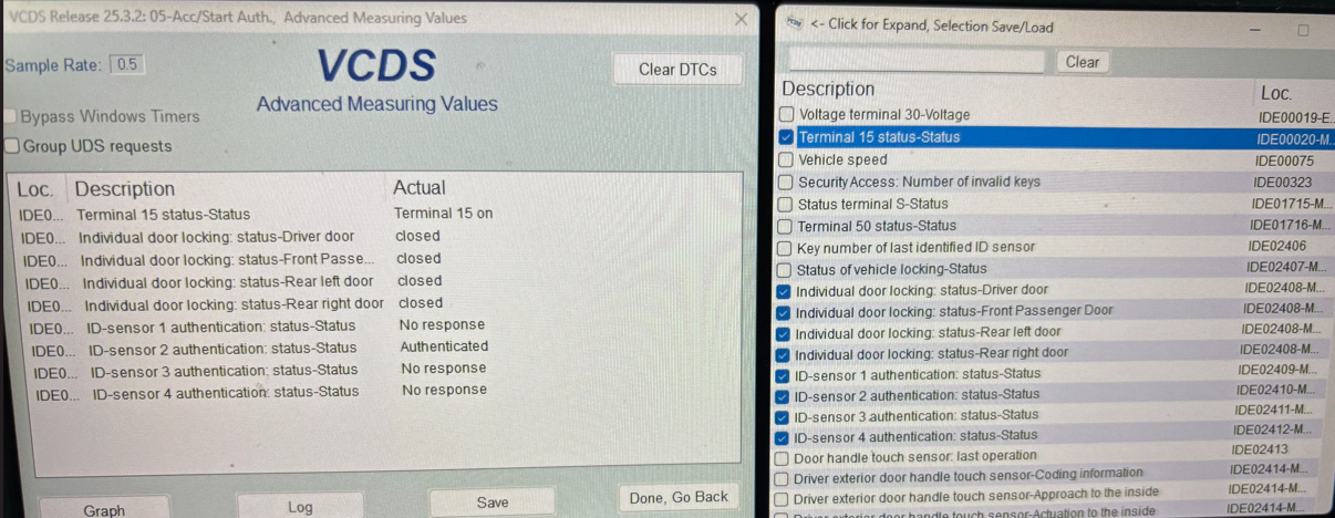

  1. Hi, i checked the drivers door wiring harness and there are no damaged cables. Checked again with VCDS and all doors are signalling correct when are open, closed, locked and unlocked. Strange finding: In VCDS there are several ID-sensor (1,2,3 and 4) authentication statuses, but i have information only on number 2. Is this normal? Here is what we monitor when i get out of the car and close the door. In the car Out of the car 1 second later What i can monitor to see which actuator is wrong. Or how to read the trigger information? What triggered the lock? In the last screen the trigger code is 01 and i do not know what is this?

  3. Hey i have exactly the same problem (it started like that) now every time i get out of the car it locks itself... it`s crazy. I rebuild some broken cables in the drivers door before two months. Today i rebuild 3 broken wires on the passenger side, but this didn`t fix the issue. i checked the rear right door. Tomorrow i need to check again the drivers door and the rear left for cable problems. Still... i check with vcds and all doors have normal status open-close and locked-unlocked. Do not know what else to check if the door cables are ok.
